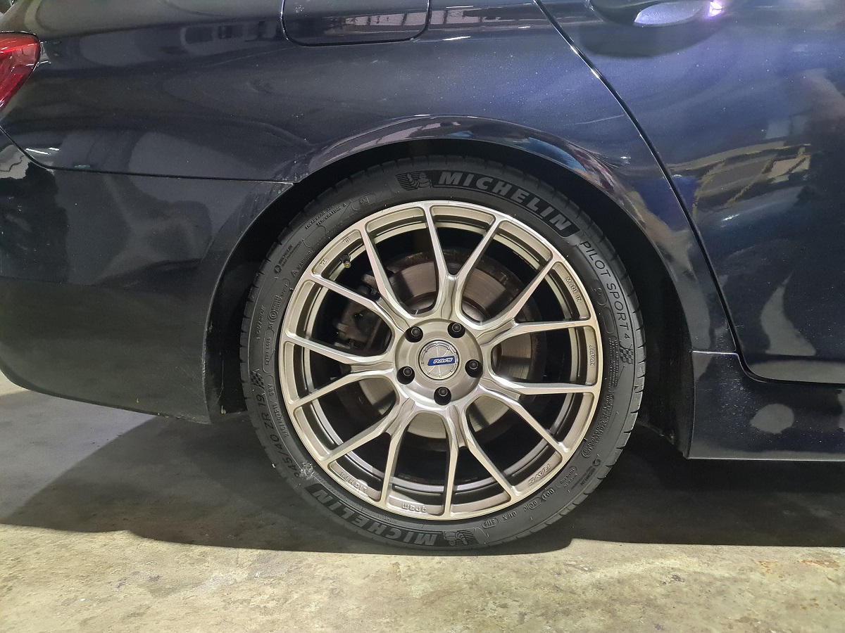

Before:
Front Stock calipers and rotors 330mm rotors
After:
535i Calipers, ATE Ceramic Pads, Zimmerman Z Coat Sport Rotors 348mm

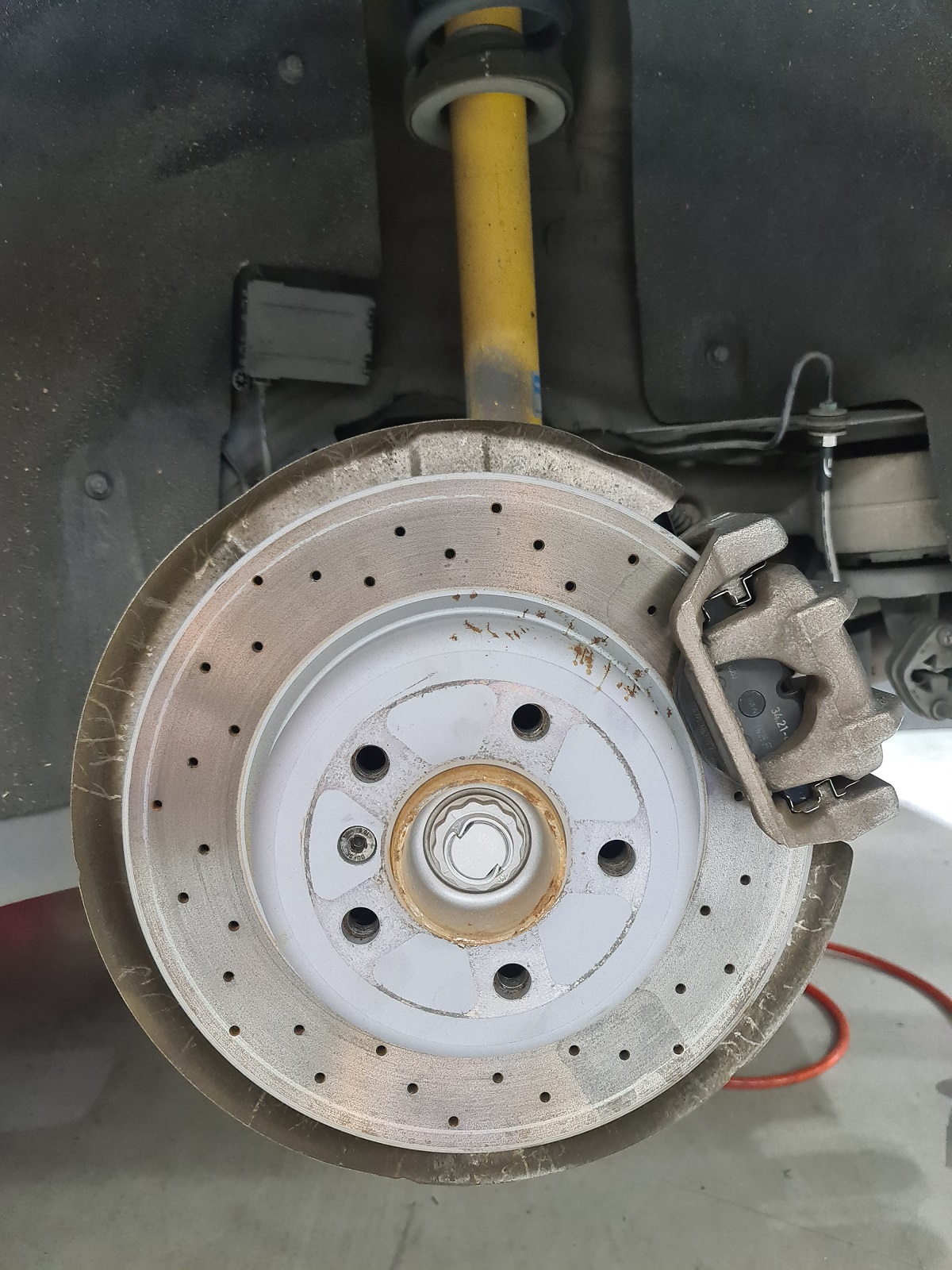

Rear:
Stock rotors 330mm
After:
Zimmerman Z Coat Sport Rotors 330mm

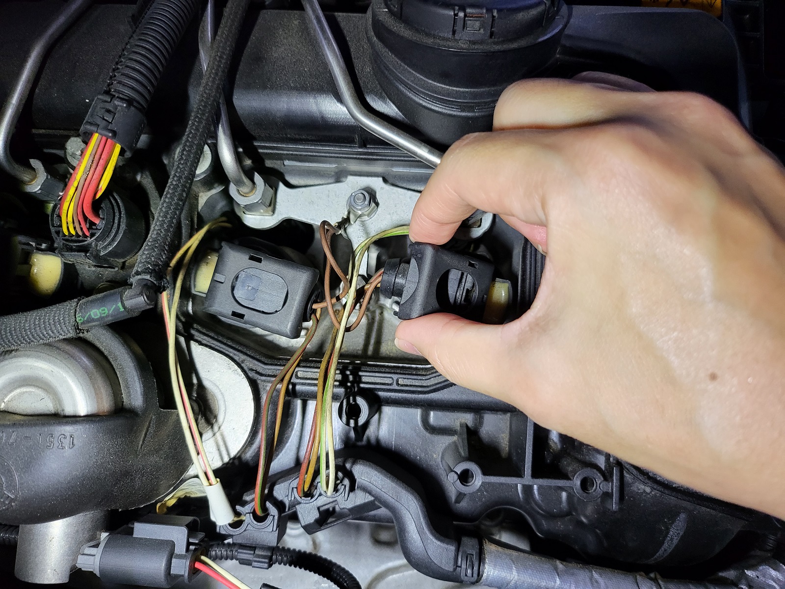

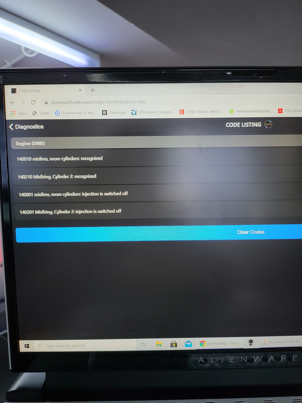

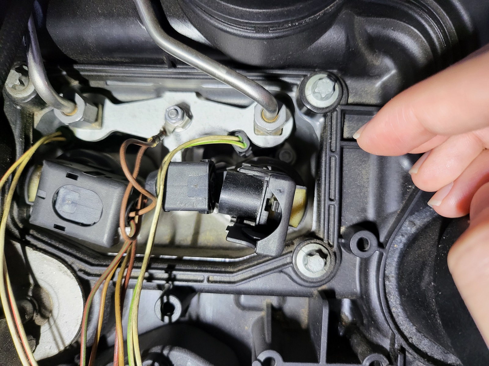

So the other day left the house got on the highway and put the foot down on the throttle and there was little to no response and a shudder went through the car and bing !
Check engine light comes on, pull to the side shut the car down and started it up again and the car was still shuddering like crazy. Limped the car home and grabbed the laptop with the diagnostic software to scan the car.
Scan shows misfire cylinder 2, spark plugs were changed not to long ago so couldn't be the issue there suspect coil packs as those have never been changed by me so far.
Plan to confirm coil failure is simple and as follows
1. Remove Coil pack 1 AND 2 and swap them around,
2. Clear the DTC Codes start up the car then see if the misfire code changes from number 2 to 1.
3. Call Eng Soon up and was quoted $149 for a set of 4 and they DELIVER to my house !
4. Replace and go !

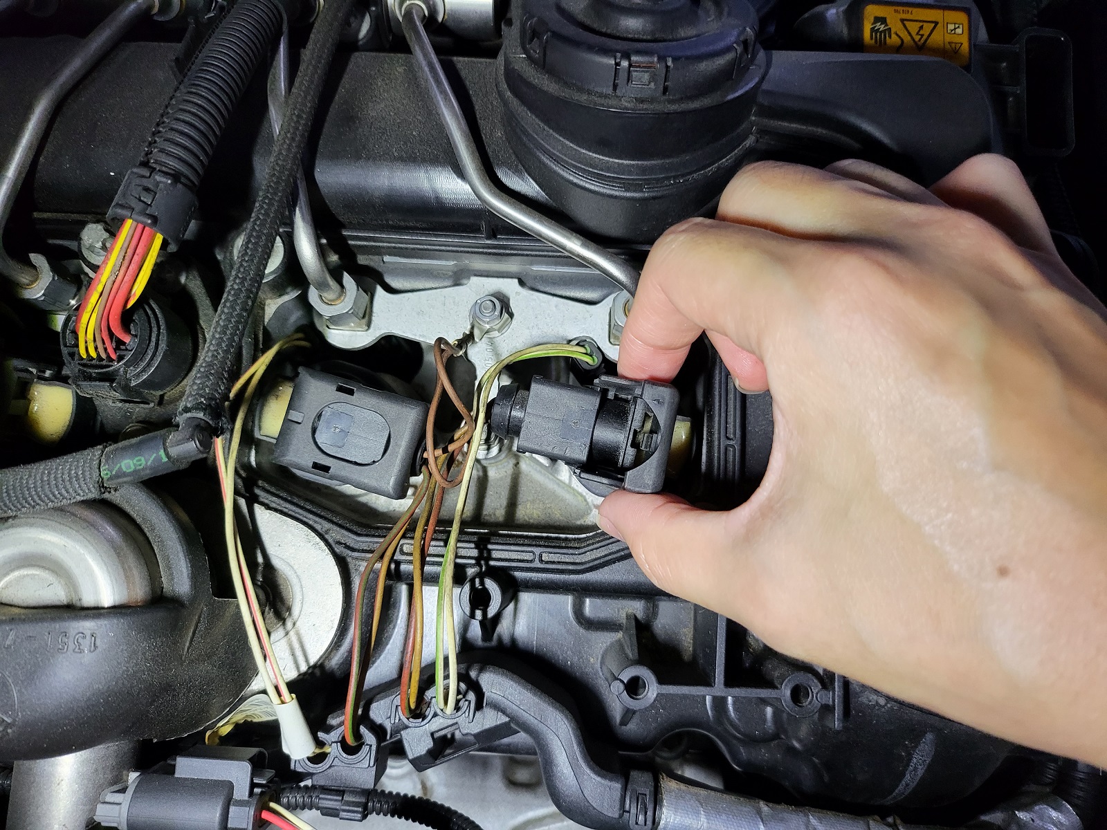

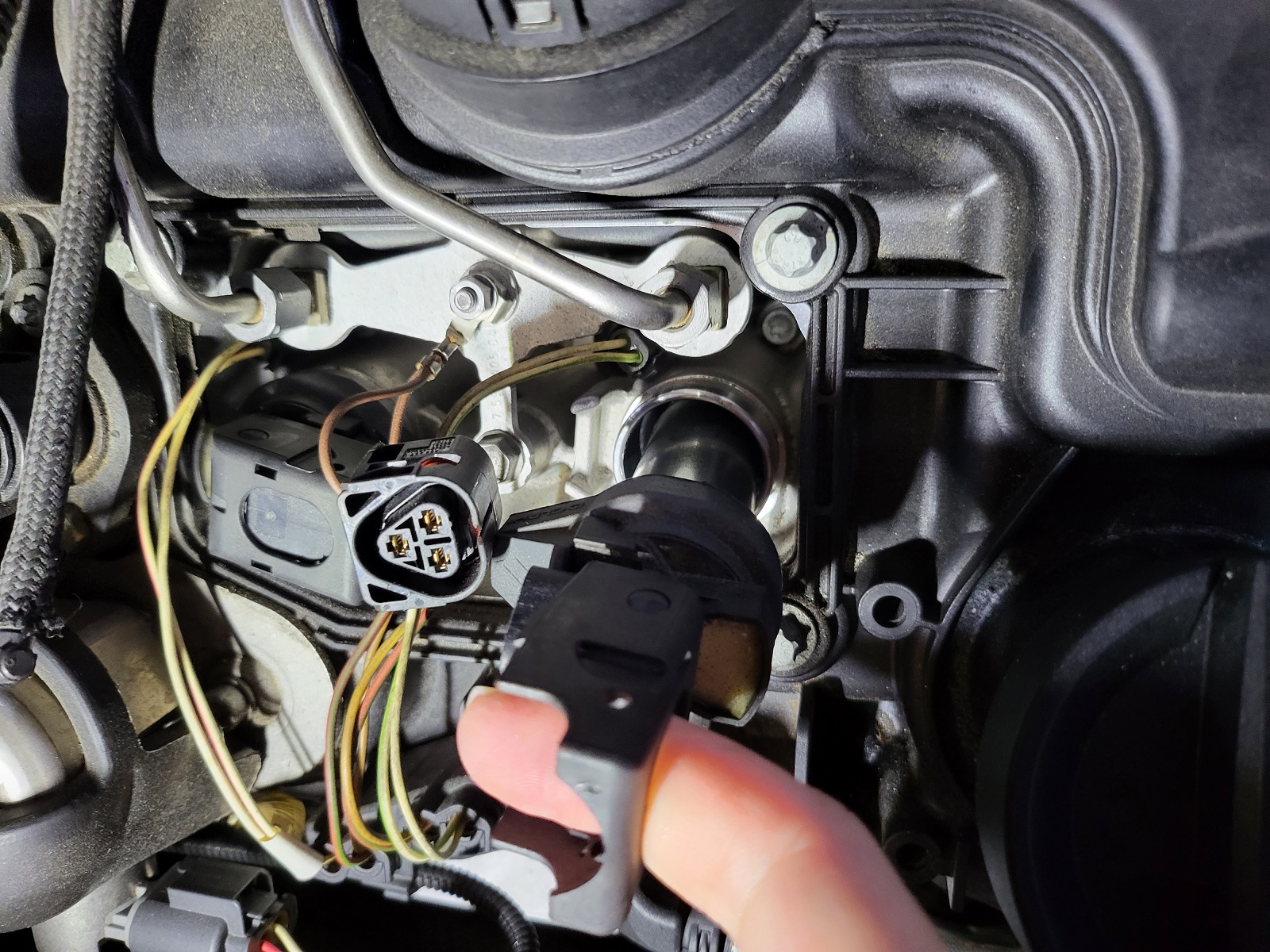

1. Pull up and off the plastic beauty cover and locate Cylinder 1 Coil Pack
Pull number 1 coil pack by moving the clip upwards the electrical connection will come off then using the clip pull the entire coil upwards.
Now do the same for Cylinder 2 Coil Pack
Swap around the coil packs clear the codes and rescan the car once again !
Tada ! Check engine code comes on and error now shows misfire cylinder 1 evident of coil pack failure.
1 Quick call to Eng Soon and $149 outta my credit card they were nice enough to deliver to my place !
Simply swap out the old coil packs replace with the nice shiny new ones and once again its good to go.

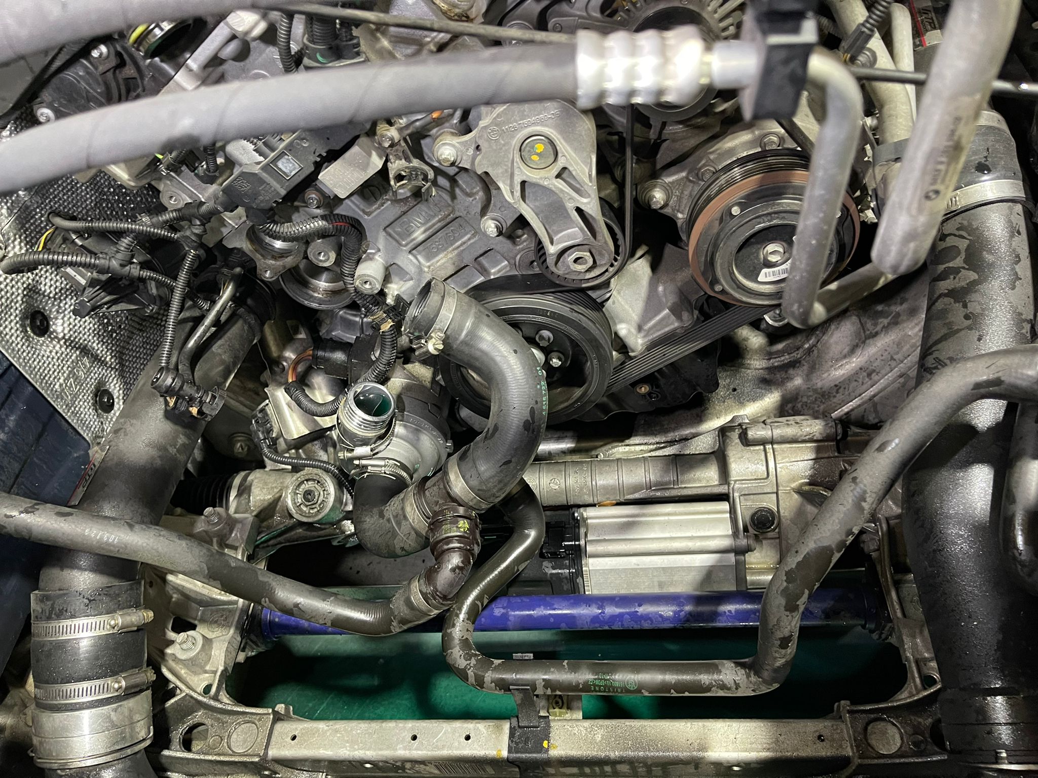

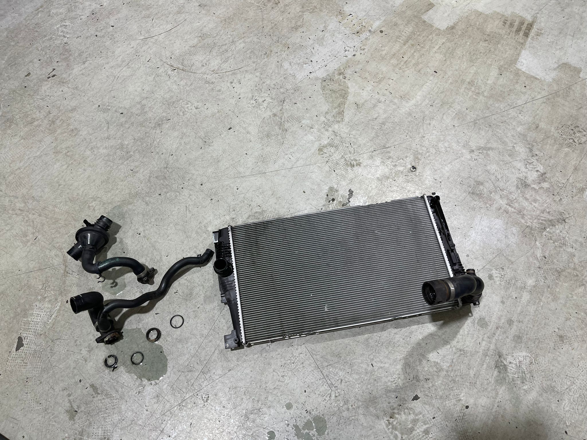

Latest failure as expected from an engine bay full of plastics. If you see BROWN plastics in your engine bay that means its degraded and turning brittle ! Engines are expensive hoses and radiators are cheap in comparison save your engine from overheating by a burst hose !
1. Radiator end tanks all turning BROWN.
2. Top hose joining plastics all degrading and cracked can see coolant dried up.
3. Plastics connecting engine block to coolant hoses all turning BROWN.

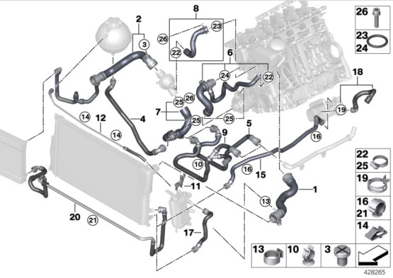

Basically Radiator , hose 1, 6, 8 and theromostat
Micky mouse hose number 8 note 2 screws .
Hose number 6
Hose number 1 or top hose
Radiator end tanks turning brown.
Items purchased from 2 places Eng Soon and Goldenlink
From Eng Soon
1. Hose number 1 (top Hose)
2. Radiator
3. 1 x coolant bottle
4. thermostat
Total :$348.82
From Goldenlink
Hose 6 $66.34
Hose 8 $70.62
Total $136.96

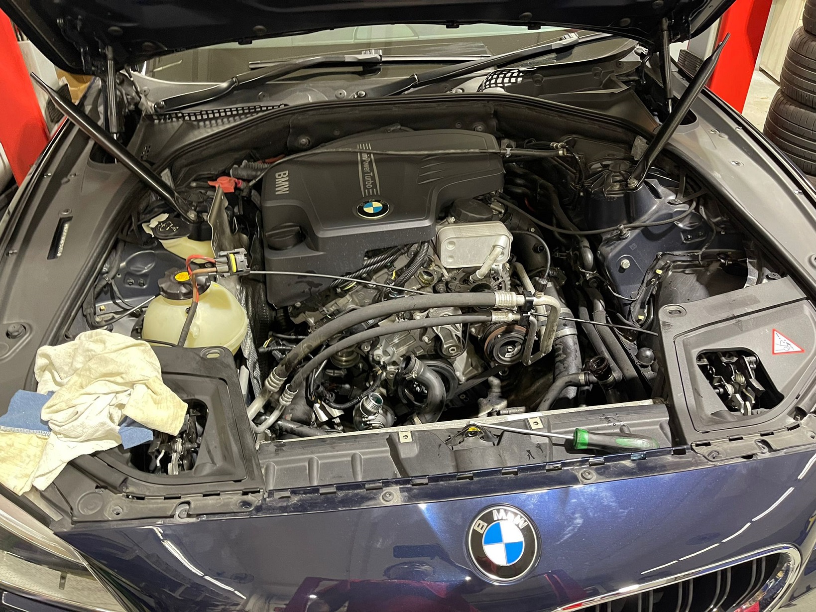

Ask and ye shall receive, back to META to put everything together.
1st Step old Radiator comes out
New one checked to see if everything matched up, lower one is new upper is old.
A group shot of old stuff coming out vs new stuff going in. Note the bits of round plastics are basically all the brittle plastics that break off in the process of aging.
