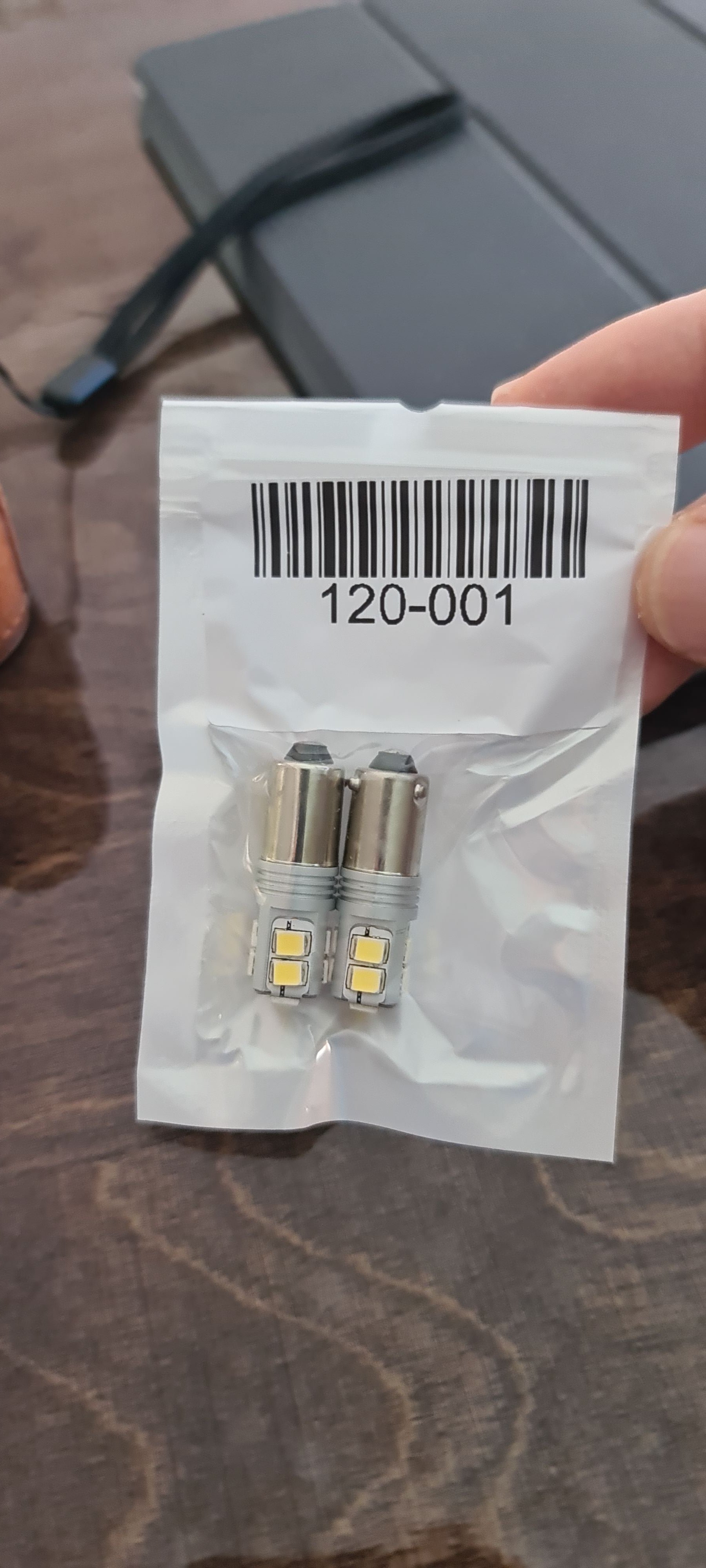

Its not difficult to swap out the bulbs. Basic tools like a philips head screwdriver and fingers to pop out the little black retaining clips and pull the boot lining down.
1.Look inside and there are 2 clips holding the light cluster in place. Push gently and it'll come down.
2. Twist off the bulb and replace
3. Test its all working before closing up.
4. Admire your work .. damn that's bright
5. Damn seller said that it had canbus and 0 errors.
6. Lucky I had bimmercode and coded it out with my phone. Simply select LED and warning goes away.
https://bimmercode.app/cars/f10/

And that's how to do it nice and cheap !
Update feedback to seller and he's sending me a replacement set to test for errors FOC.
