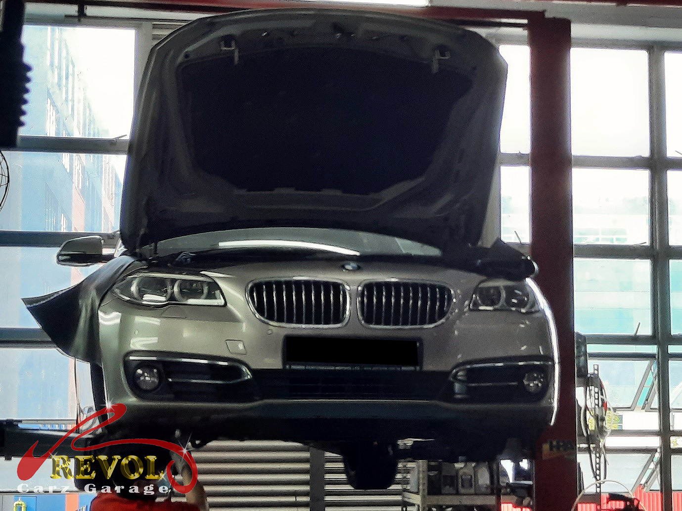

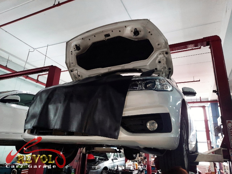

The BMW 520i scrambled to Revol Carz Garage with worrisome front shock absorbers issue.
Elevating the BMW for a multipoint check with focus on the suspension system.

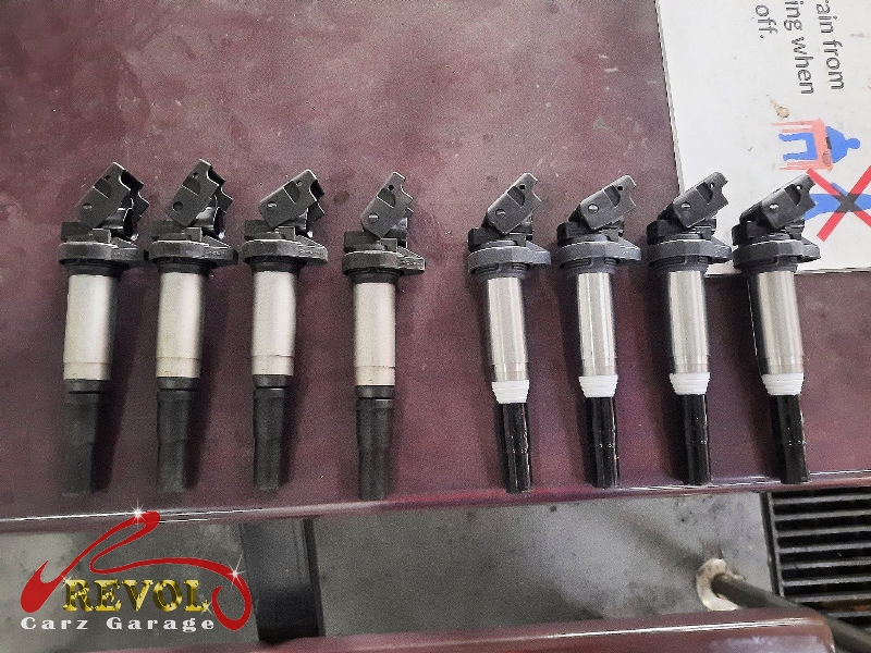

The BMW 316i arrives at Revol Carz Garage with a complaint of an Engine misfiring arising from the Check Engine Light on issue.
A precision System and Function Computerized analysis detected “Misfire Several Cylinders”.
Expelling the bad Ignition Coils (left four) and welcoming the new genuine Ignition Coils.
We install only the original and the best brands, BOSCH or NGK plugs for your BMW for optimized performance (right four).
The BMW 316i ignition coils and spark plugs replacement is a straightforward job that was completed in about an hour.

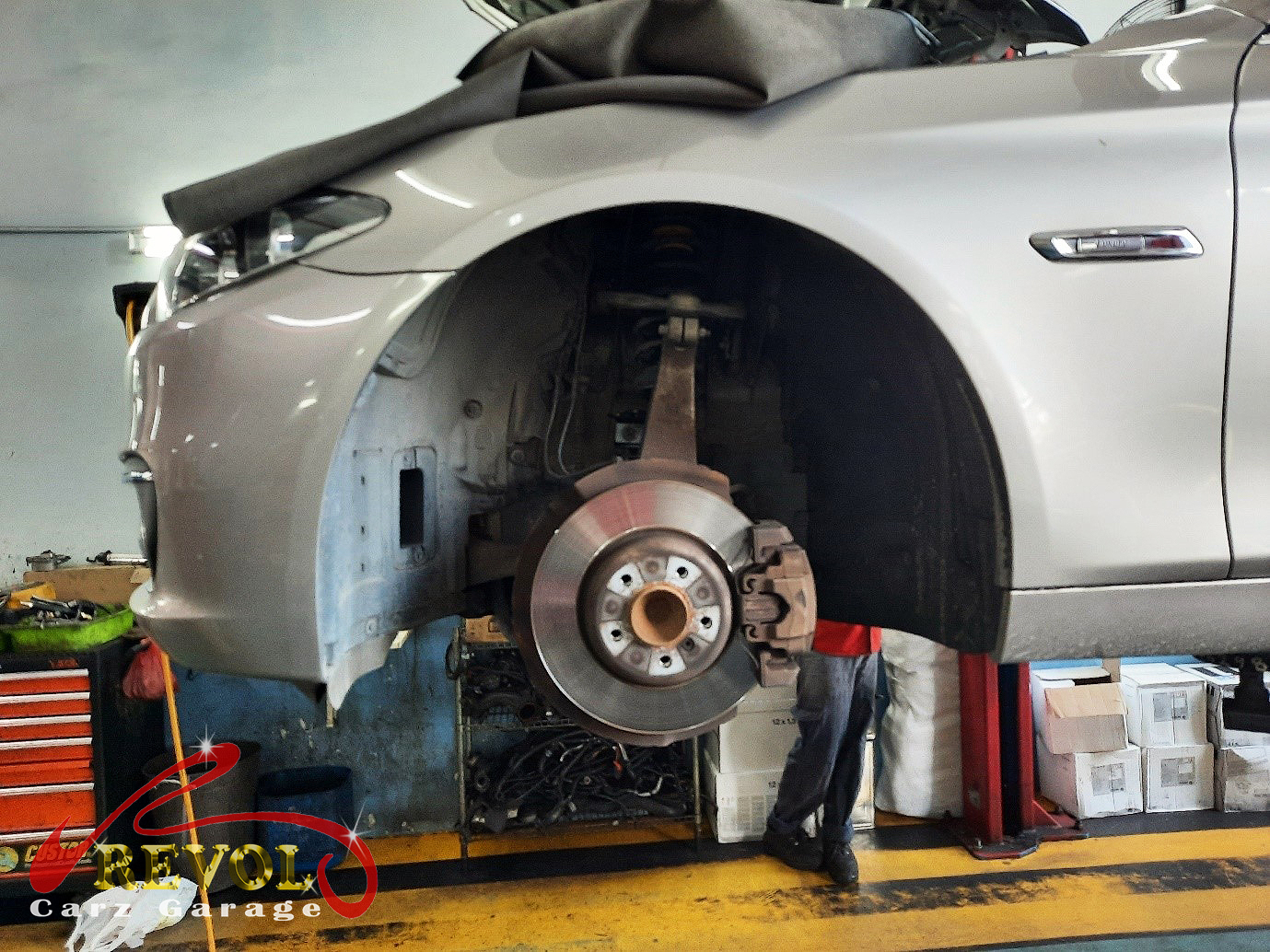

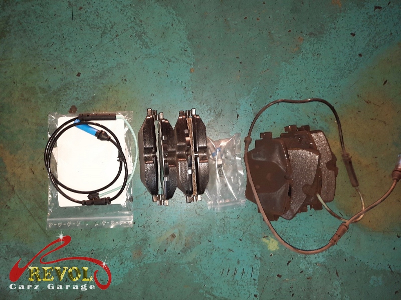

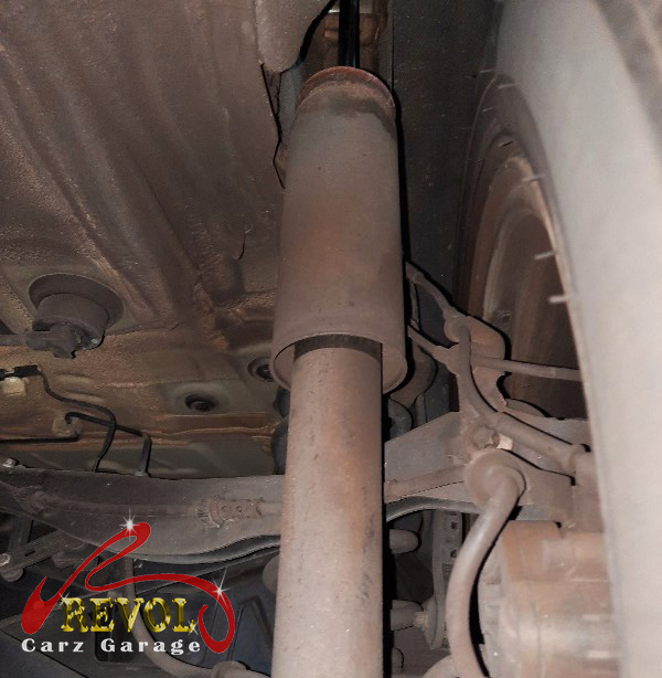

Mr Ng BMW 216D arrives at Revol Carz Garage and mentioned to our team he is experiencing some abnormal sound from the rear!
The BMW is elevated for a thorough safety inspection and preparation for full maintenance servicing.
Our BMW Specialist specialist found worn brake pad and rotor and replaced them.
New Brake Rotors and Brake Pads installed.
Our highly trained Specialists are skilled at detecting and dentifying abnormal sounds during inspections

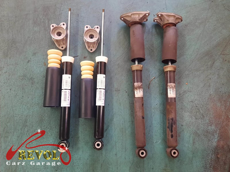

Original BMW Rear Shock Absorber Kits ready to swap with the bad ones.
Wrapping up the full maintenance servicing with new rear shock absorbers and brakes, the rejuvenated BMW 216D is treated to a complimentary manual car wash and interior vacuuming.

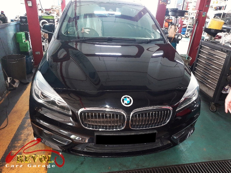

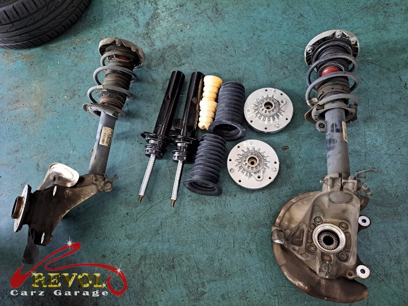

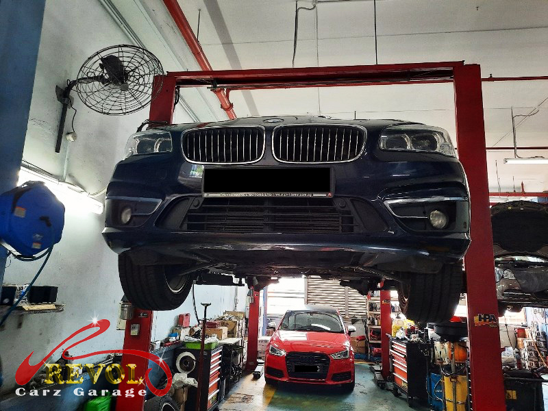

The owner of the BMW 216i visited Revol Carz Garage for assistance as he is hearing some sound everytime he crosses a hump.
The BMW is lifted for inspection of all Suspension systems including under carriage and our Experienced BMW Specialist has confirmed that the source of the sound is the Front Suspensions.
Dismantling the Front Suspension system in progress.
A line-up of new Front Shock Absorbers Kit comprising the Mountings, Covers, and Stoppers (center) ready for the replacement.
The BMW 216i's abnormal sounds have been eliminated, and after being returned to the happy owner, it now offers a smoother ride, providing a sense of relief and confidence in its performance.

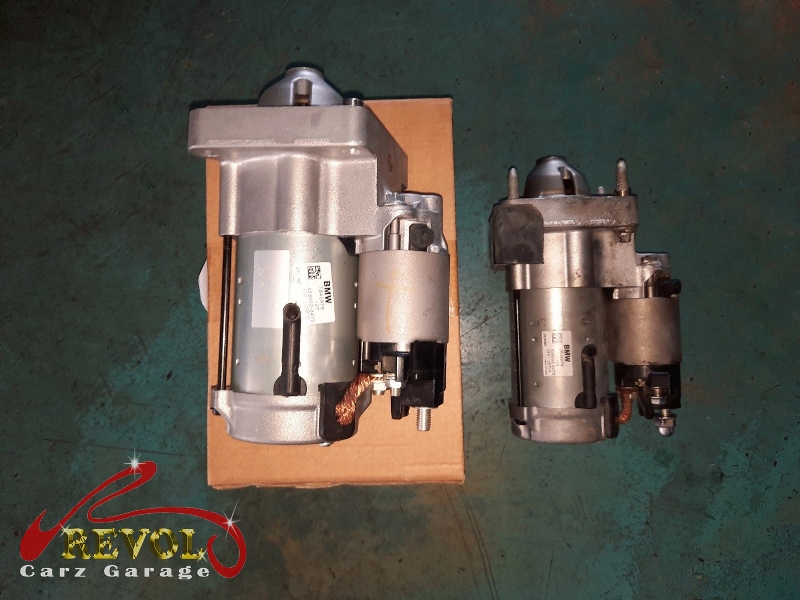

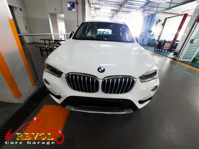

Our Breakdown Rescue Team got the stranded BMW X1 towed to Revol Carz Garage for troubleshooting and diagnosis for Ignition issues.
The precision Diagnostic Scan Tool unveils Engine Start Fault during starter operation which leads us to focus on the Starter Motor.
The Starter Motor has been unseated on the affirmation that it was in bad condition.
It is time to replace the faulty Starter Motor.
Make your Bimmer a 100% BMW with Genuine BMW replacement parts. The new original BMW Starter Motor will ensure the X1 fires up every time.
The Ignition starting issue was swiftly resolved and the beaming owner was excited to have his luxury BMW X1 back within hours in sparkling clean and fresh condition with our Complimentary Car Wash and interior vacuuming.

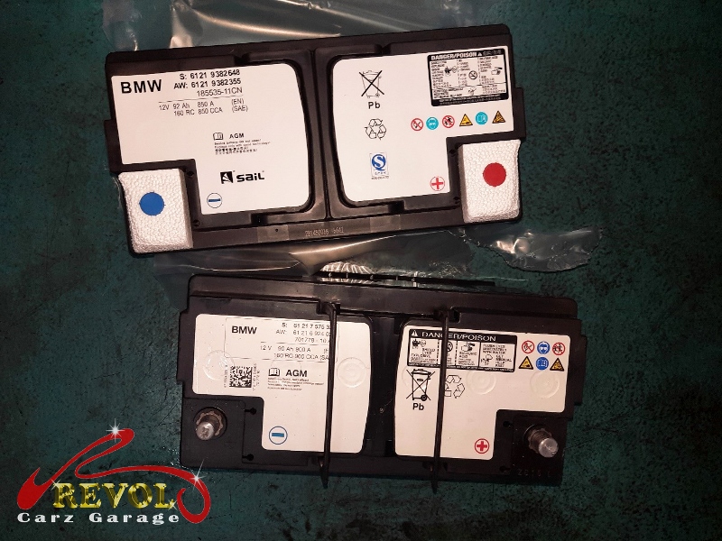

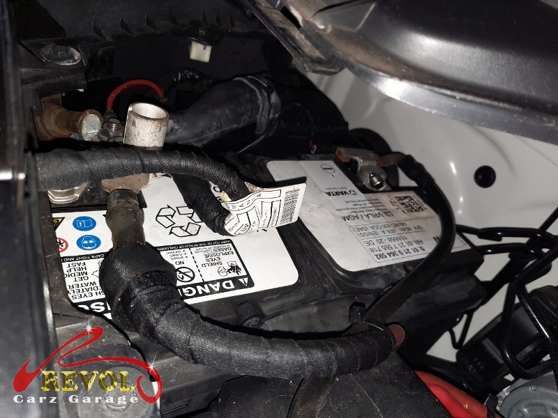

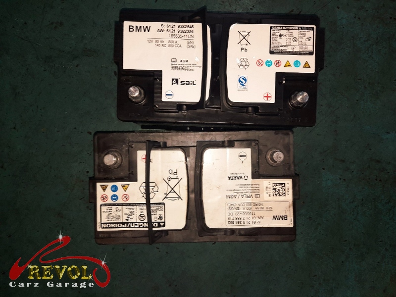

On cranking the vehicle, the Battery output seemed weak.
The DHC Battery Test Report yielded a poor report showing about 6.2% charge and only 3.2% state of health condition. Time to replace the Battery.
For reliable performance, we installed an exclusive new BMW-Specified Battery. Your new Battery needs the coding process to reset your vehicle to the new Battery. A process best done by the Professionals.
The new Battery installation is completed with a full charge and QC endorsement before ushering the BMW to the Wash Bay for a complimentary car wash and interior vacuuming.

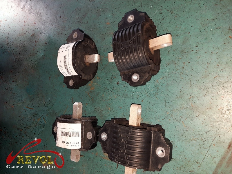

Mr. Xavier BMW M5 arrives at Revol Carz Garage for Full Maintenance Servicing on regular basis and mention recently he felt some vibration when engaging gear!
Conducting a multipoint inspection protocol with a comprehensive safety check for the BMW M5.
Our Experience BMW Specialist discovered the worn Gearbox Mounting and replaced with New, genuine BMW Transmission mounts (Left) are expedited for replacement.

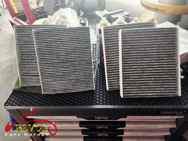

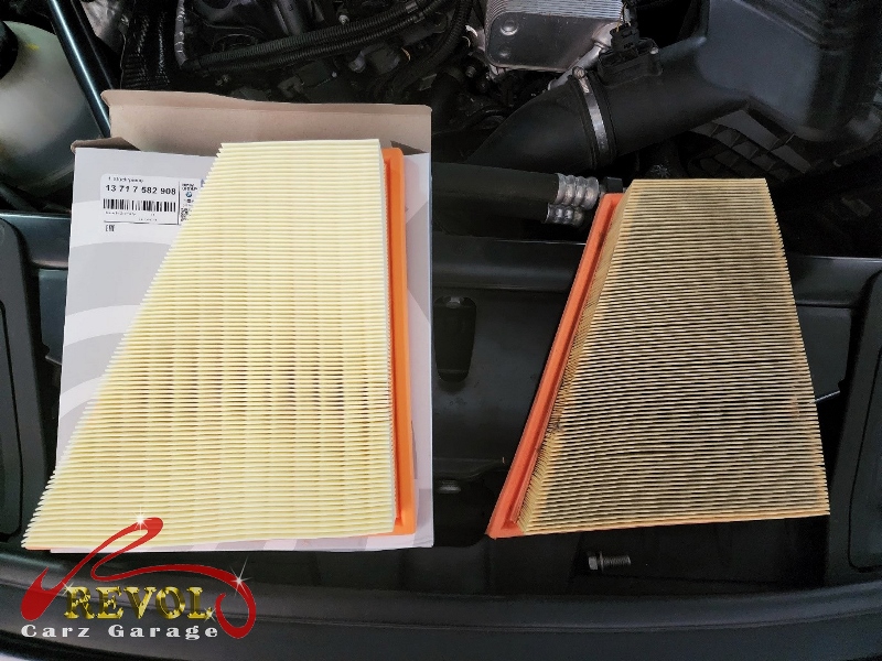

It is important too toreplace your Air Filter for better engine air intake performance.
Compare the appalling clogged Cabin Air Filters (Right) with the new ones. Cabin Air Filters should be regularly replaced as part of the comprehensive maintenance program.

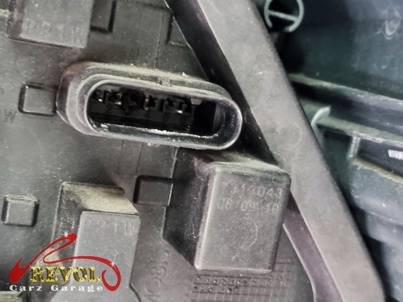

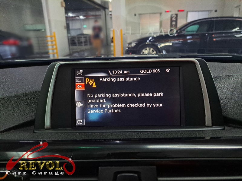

The BMW 316i Parking Sensor was malfunctioning and was brought to Revol Carz Garage to fix the problem.
The warning message on the dashboard read: “No parking assistance, please park unaided. Have the problem checked by your service partner”.
Our Technician conducted a second-tier scan using the house diagnostic scan tool that reveals: “Ultrasonic sensor rear outer left signal line disconnected"
We quickly expedited a new original BMW replacement ultrasonic sensor for the swap.

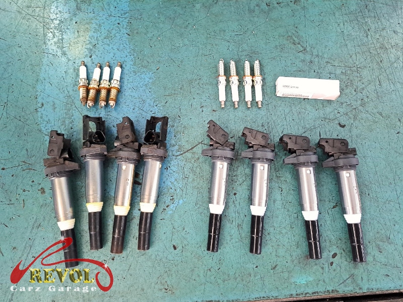

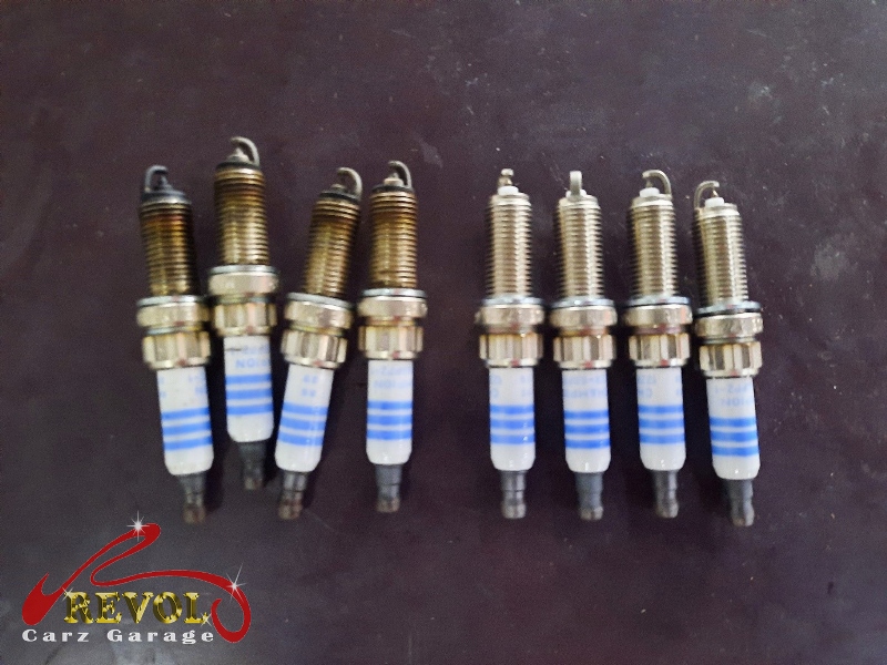

Misfiring and “Check Engine” issues prompted the BMW320i to visit Revol Carz Garage for rectification.
The System and Function Scan diagnosed failures in the Ignition system.
A new set of Ignition Coils (right) plays an important role in the Ignition process.
A new set of BMW Genuine Spark Plugs (right) is simultaneously replaced with the ignition coils. Faulty Spark Plugs / Ignition Coils that generate weak sparks are unable to fully burn the fuel/air mixture thus causing sluggish acceleration and loss of power in your BMW.
The sleek BMW 320i looks more powerful with new Ignition Coils and Spark Plugs ready to hit the road with a blast.

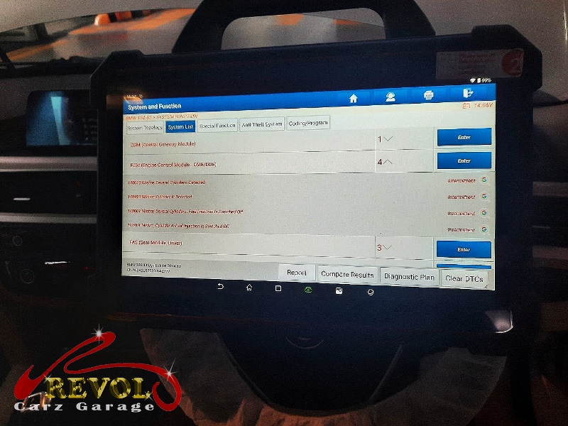

The BMW 318i plagued by symptoms of bad Ignition Coils and Spark Plugs arrives Revol Carz Garage for repair.
Our precision Diagnostic Scan Tool detected, “Misfire in several Cylinders”.
This BMW 318i has only a 3-Cylinder engine that was produced for specific markets. Three Ignition Coils are extracted for replacement.

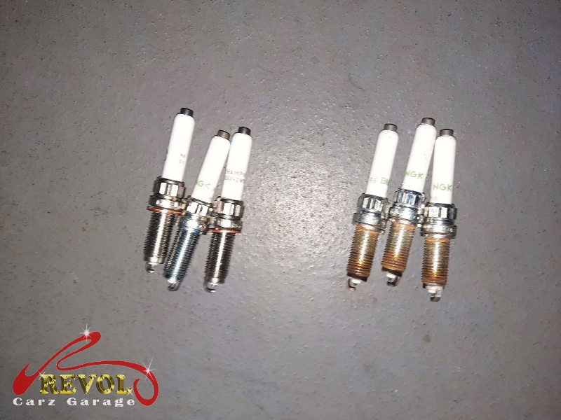

The worn Spark Plugs are badly corroded and show significant wear (left). This can impact engine performance, poor fuel economy, and Engine misfires. With the new Spark Plugs (right) installed, the BMW 318i's engine performance will improve significantly, resulting in a smoother and more reliable driving experience

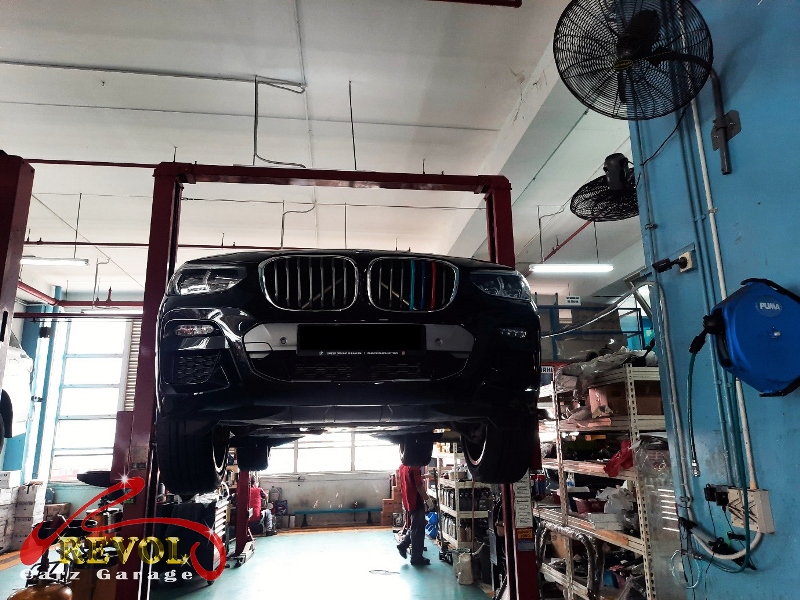

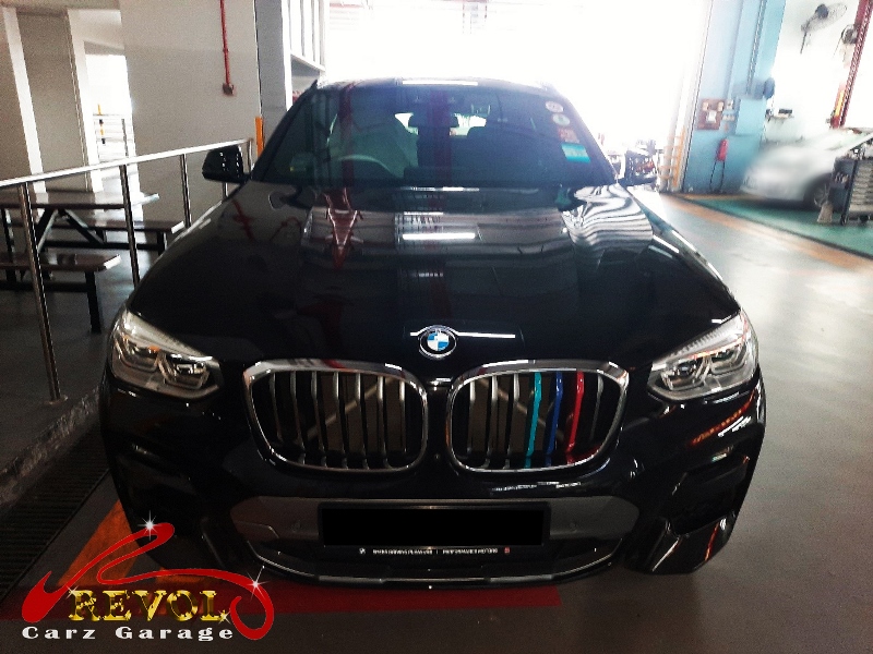

Awareness of the BMW Recall for Tie Rod defects, the X4 quickly checks in Revol Carz Garage for an inspection.
Elevating the BMW for multi-inspection protocol with focus on the Tie Rod condition.

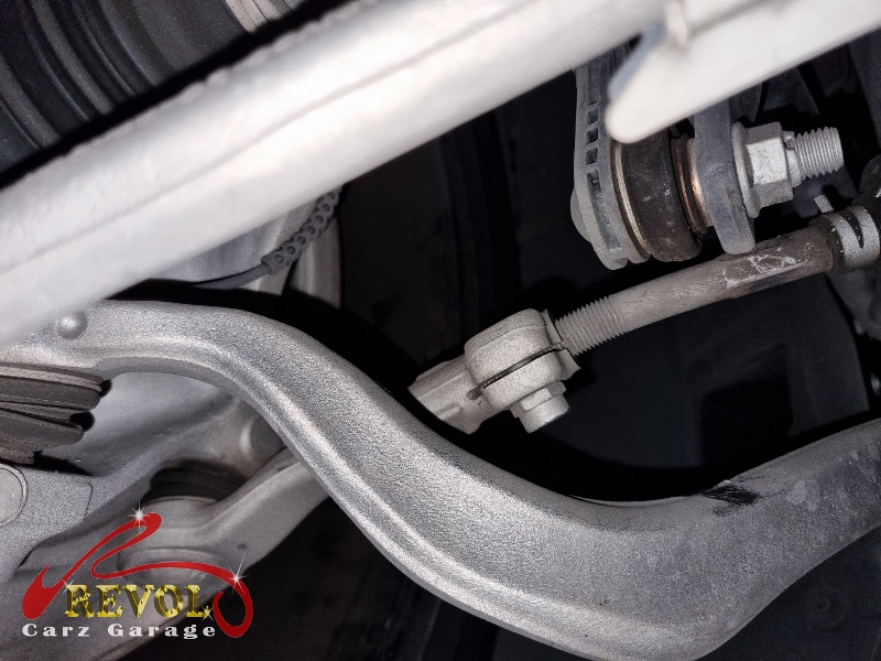

Indeed the Tie Rod is overly stressed and dangerously bent.
We ensured that the new replacement Tie Rod (Left) is a superseded original BMW part. (Note the pathetic condition of the failed tie rod).

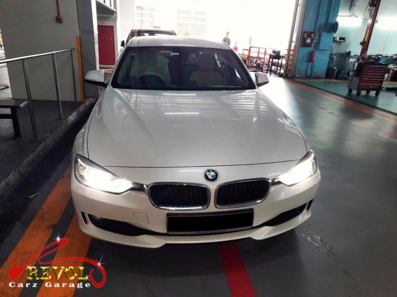

The BMW 320i rushes to Revol Carz Garage, heeding the warning light on the dashboard that the car Battery and Tail Light Bulbs are in need of replacement.
The retiring Battery (bottom) bids its farewell, replaced by a vibrant new BMW Original Battery for optimal performance.
The batch of blown Light Bulbs, blackened in soot, are carefully unplugged from the Tail Lights. A fresh batch of brand-new Bulbs eagerly awaits installation, ready to flaunt the radiant glow.
The empty Tail Light Bulb Housing eagerly awaits to welcome the new Bulbs.
With the swift Battery and Light Bulb replacement, our QC Team gave a thumbs-up for the flawless work order.

The 5-Series is lifted for a multi-point inspection protocol that evaluates the real-time condition of the vehicle.

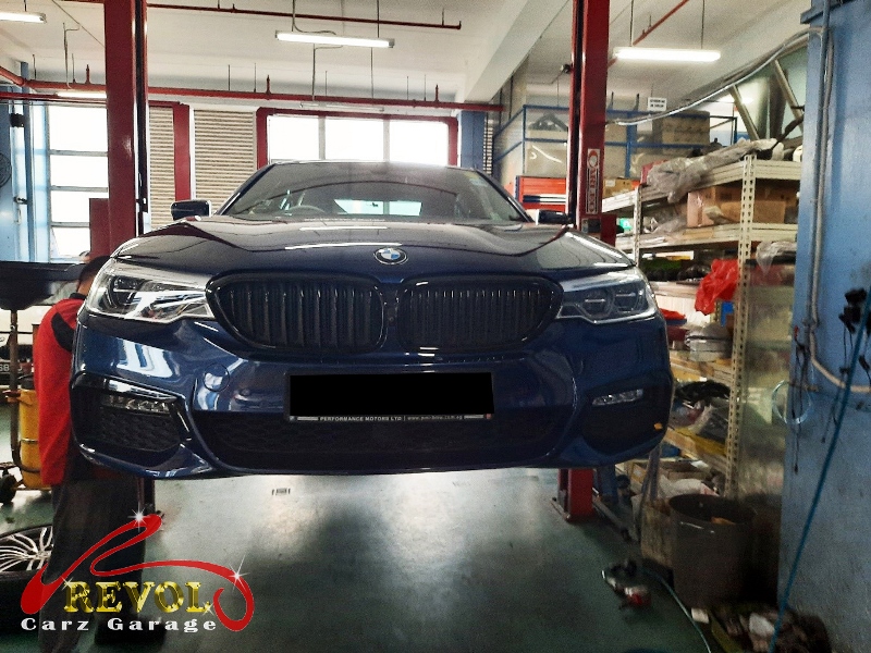

The sleek BMW 520i checks in at Revol Carz Garage for Interim Car Maintenance Servicing.
We assess the condition of vital components during the multi-point inspection protocol thus enabling us to identify and replace worn Spark Plugs and Ignition Coils promptly.
The Engine Air Filters play crucial roles in maintaining the performance of your BMW 520i. They protect your engine from harmful particles, such as dirt and debris, ensuring optimal combustion and maximizing fuel efficiency. The Filter gradually clog over time, leading to reduced airflow and compromised functionality.
The consumable Cabin Air Filters too, act as a barrier, preventing dust, pollen, and pollutants from entering the vehicle's interior. It makes prudent sense to replace these Filters at every maintenance service.
With all the boxes ticked and a thumbs-up appraisal by stringent our QC (Quality Control Team), we pampered the BMW by treating her to a complimentary car wash and interior detailing.
