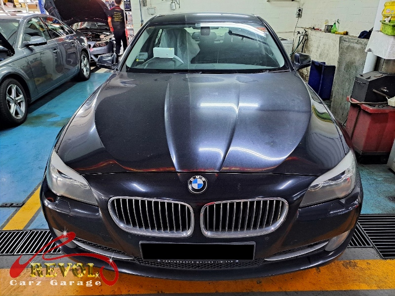

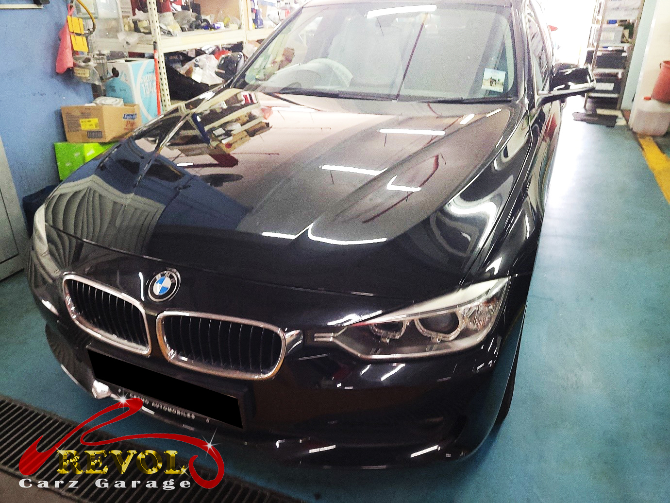

BMW 318i is scheduled for Maintenance Servicing.
At Revol Carz Garage, we perform your BMW Factory Scheduled Maintenance Servicing according to the BMW Servicing Specifications.
The BMW 318i is elevated for careful inspection ensuring that your safety and reliability are never compromised.

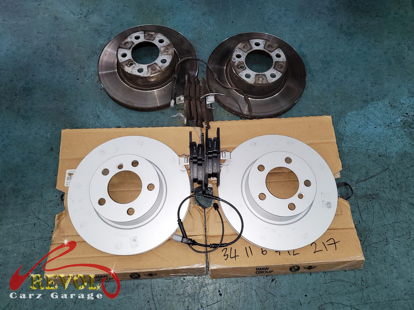

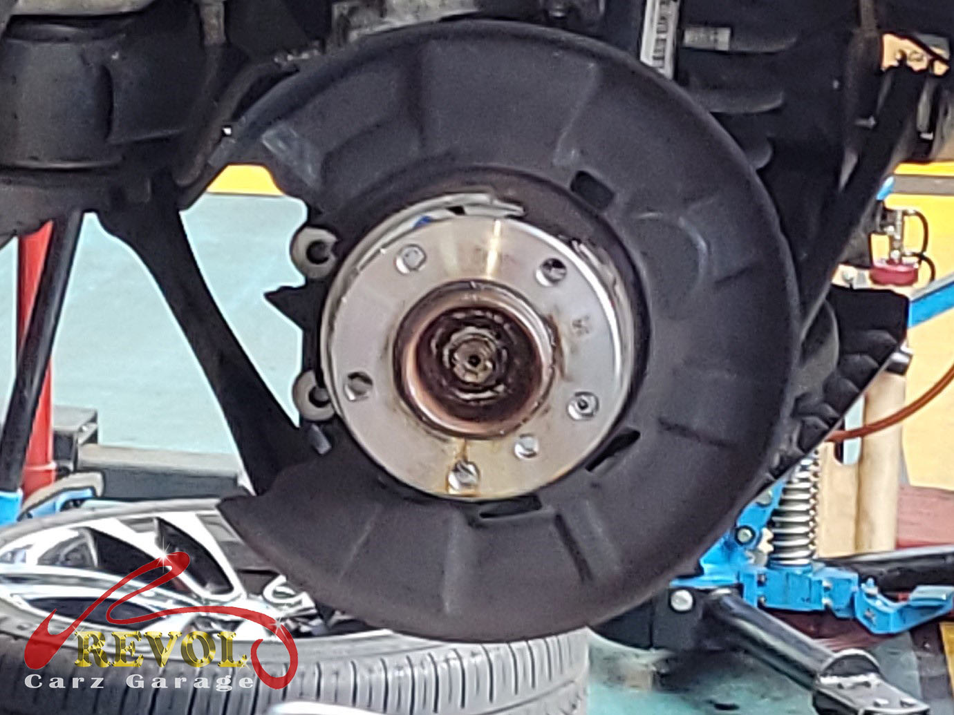

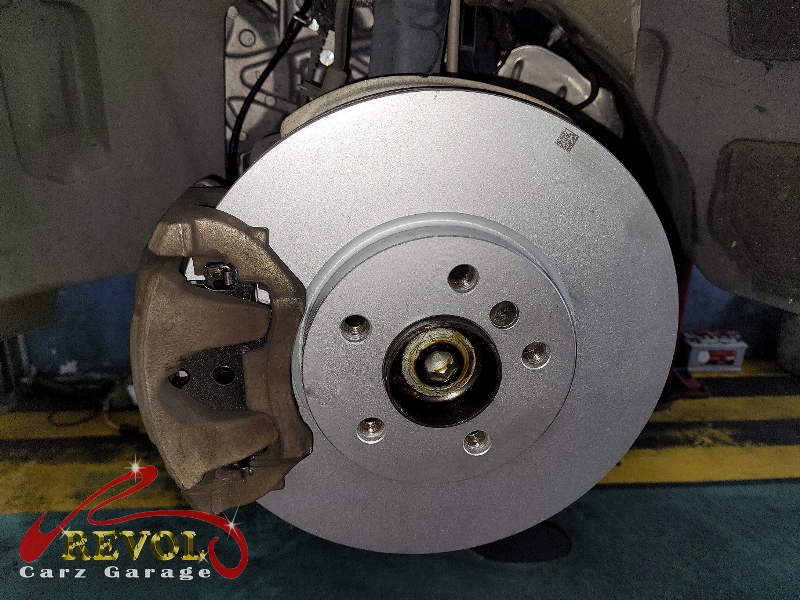

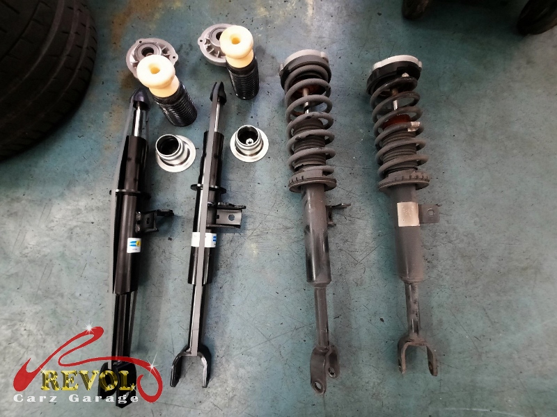

Work is in progress on the Front Brake-assembly replacement.

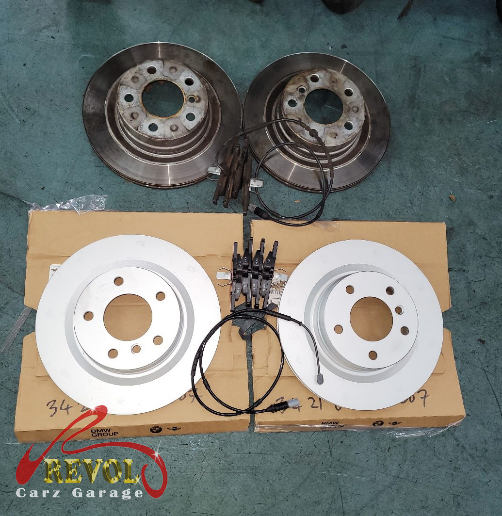

The Rear Brake assembly replacement work is in progress.
The retired Rear Brake assemblies saluting the new guards which are reporting for duty.
The changing of guards is also happening at the pair of Front Brake assemblies.
The new Brake assembly is happily in place.
The seamless Major Maintenance Servicing is accomplished and the BMW got freshened up with a complimentary car wash and interior vacuuming before collection.

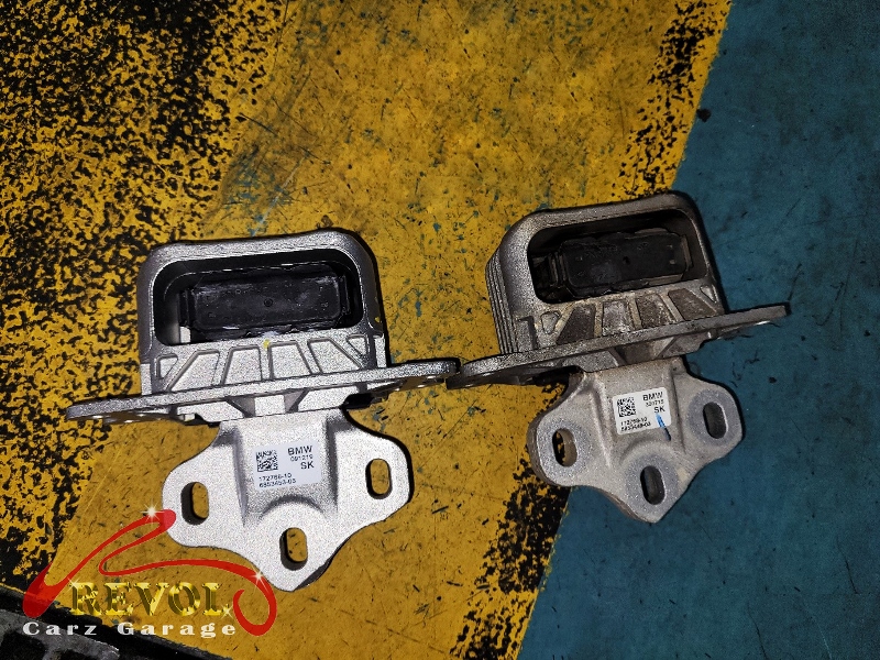

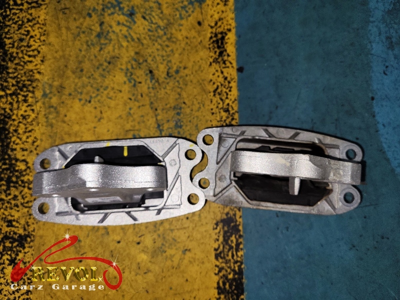

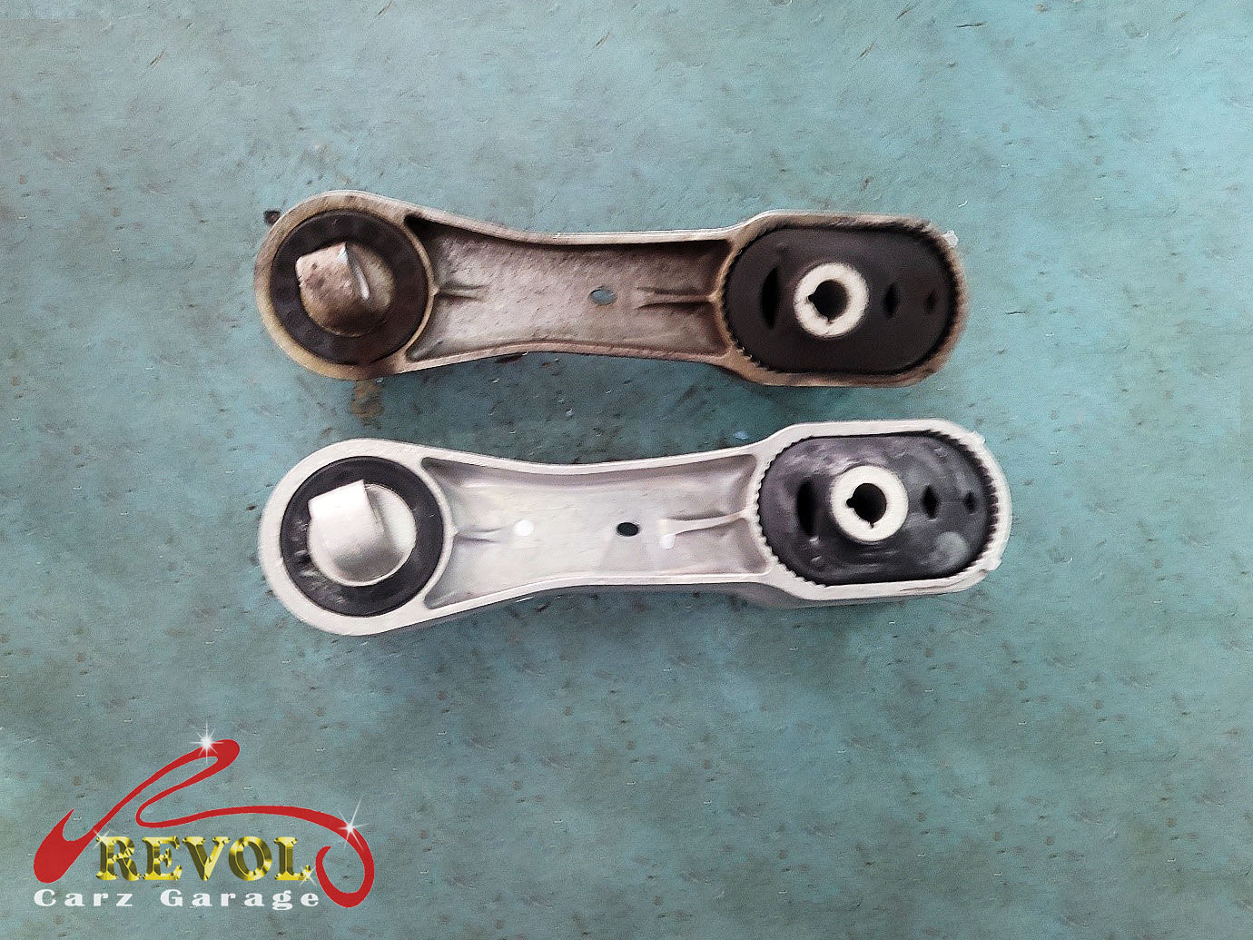

Feel excessive vibrations coupled with unwanted noises from the engine while driving your BMW? These are signs that your Engine Mounts are pleading for replacements.
Disconcerting noises with excessive vibrations from under the hood caused the driver of the BMW 216i to head to Revol Carz Garage.
Leaving no stone unturned, the BMW is elevated for a thorough inspection and our BMW Specialist have discovered as some of the Engine Mounting are replaced but some have not. We do recommend to replace all Mounting to be replaced at the same time instead of one by one to ensure better stability.
Our experienced BMW team confirmed the Engine Mounts have worn out (left). The original BMW replacement part is ready for the swap.
This is the other part of the Engine Mount. On the Top is the worn Mount with hardened and cracked rubber.
With new Engine Mounts in place and vigorous tests passed, the BMW is then ushered to the washing bay for a complimentary car wash and interior vacuuming.

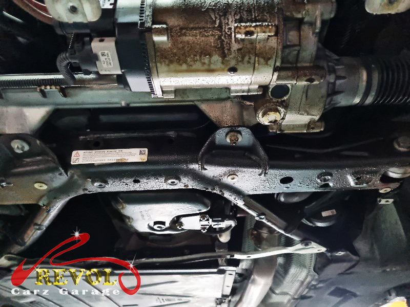

What is the clause when your Steering Wheel is loose and having clucking noise?
John BMW 520i is having Steering control felt loose with excessive play and visited Revol Carz Garage for assistance.
The BMW is elevated for a thorough undercarriage inspection.
Indeed, we found the worn Steering Rack faulty and a new replacement Steering Rack (Top) is promptly available for the replacement.
A Steering Rack replacement can be a challenging and intimidating job.
The professional job of Steering Rack is completed with clockwork precision and the BMW is given a complimentary car wash with interior vacuuming.

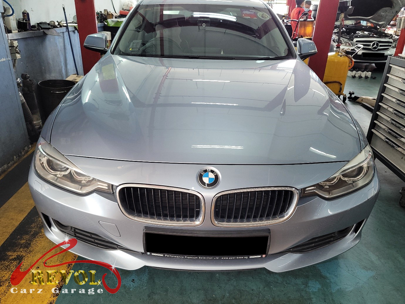

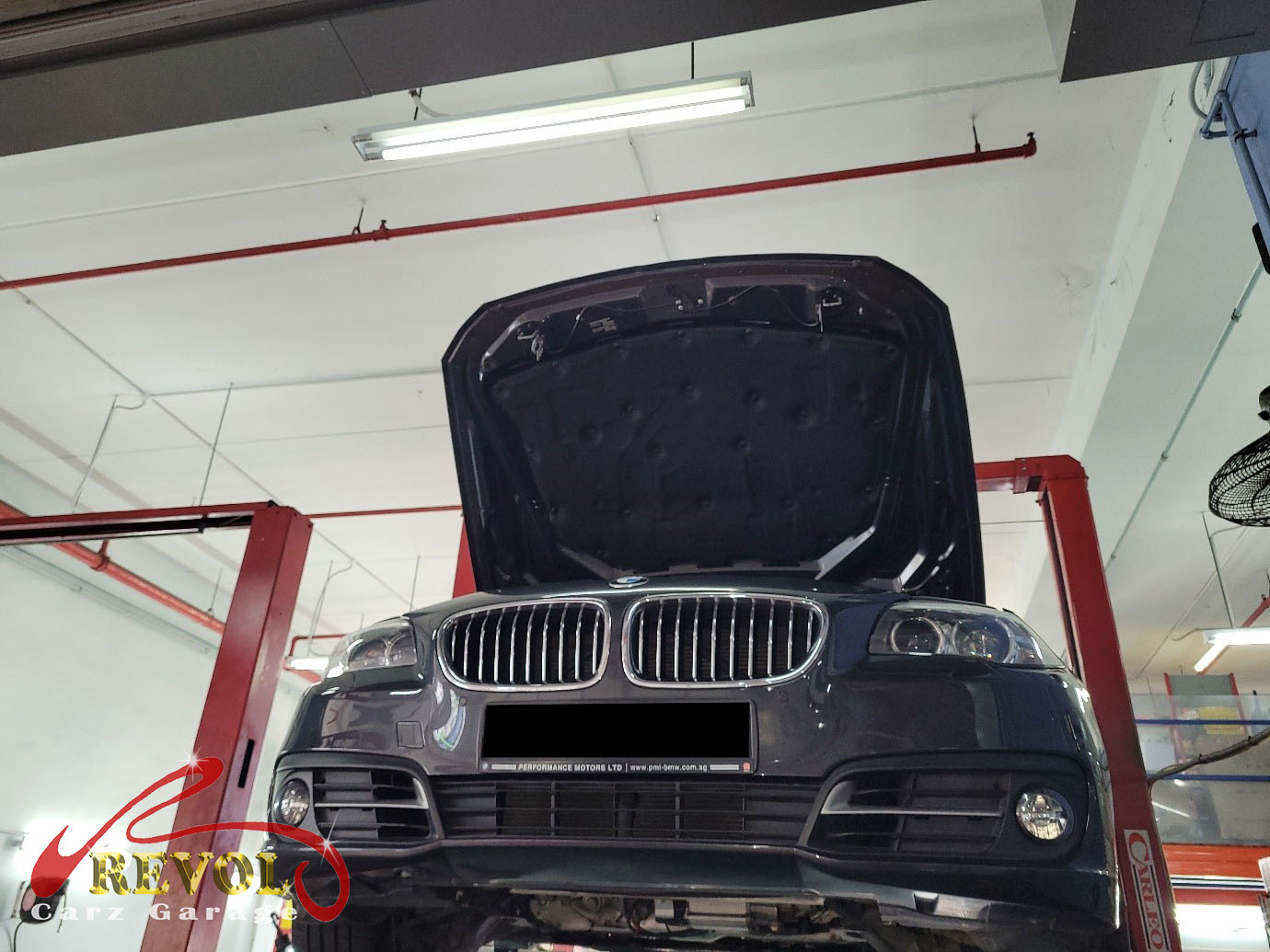

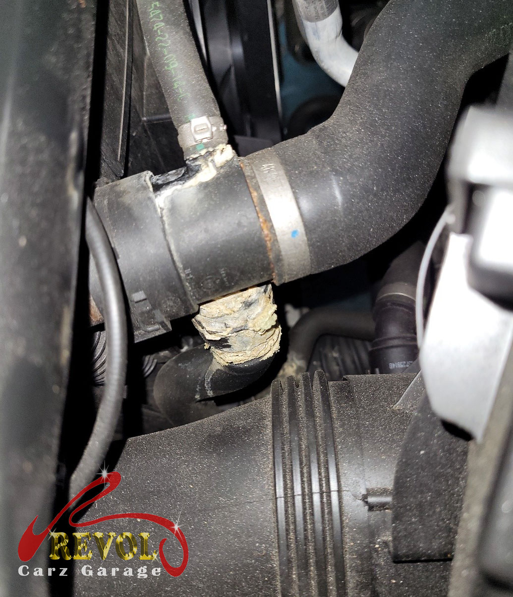

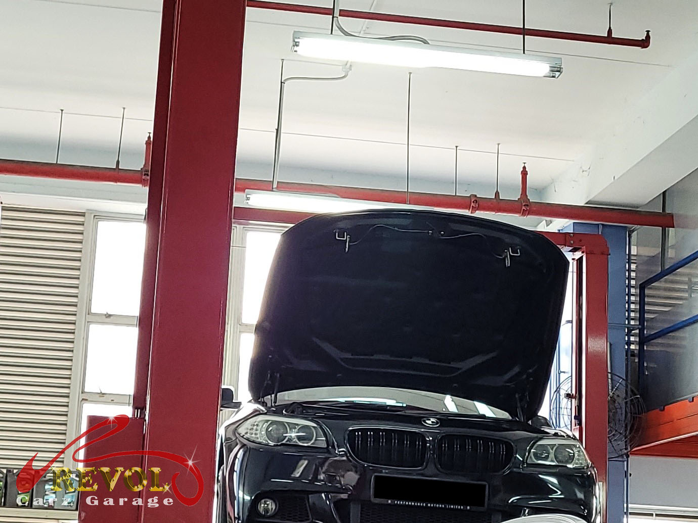

Your Engine overheating with loss of Coolant in your BMW is an urgent problem. Let our BMW Experts fix it for you.
The BMW 528i called at Revol Carz Garage urgently for Radiator issues that led to Engine overheating.
Our BMW Specialists swiftly elevated BMW for a thorough inspection for every possible source of leak.

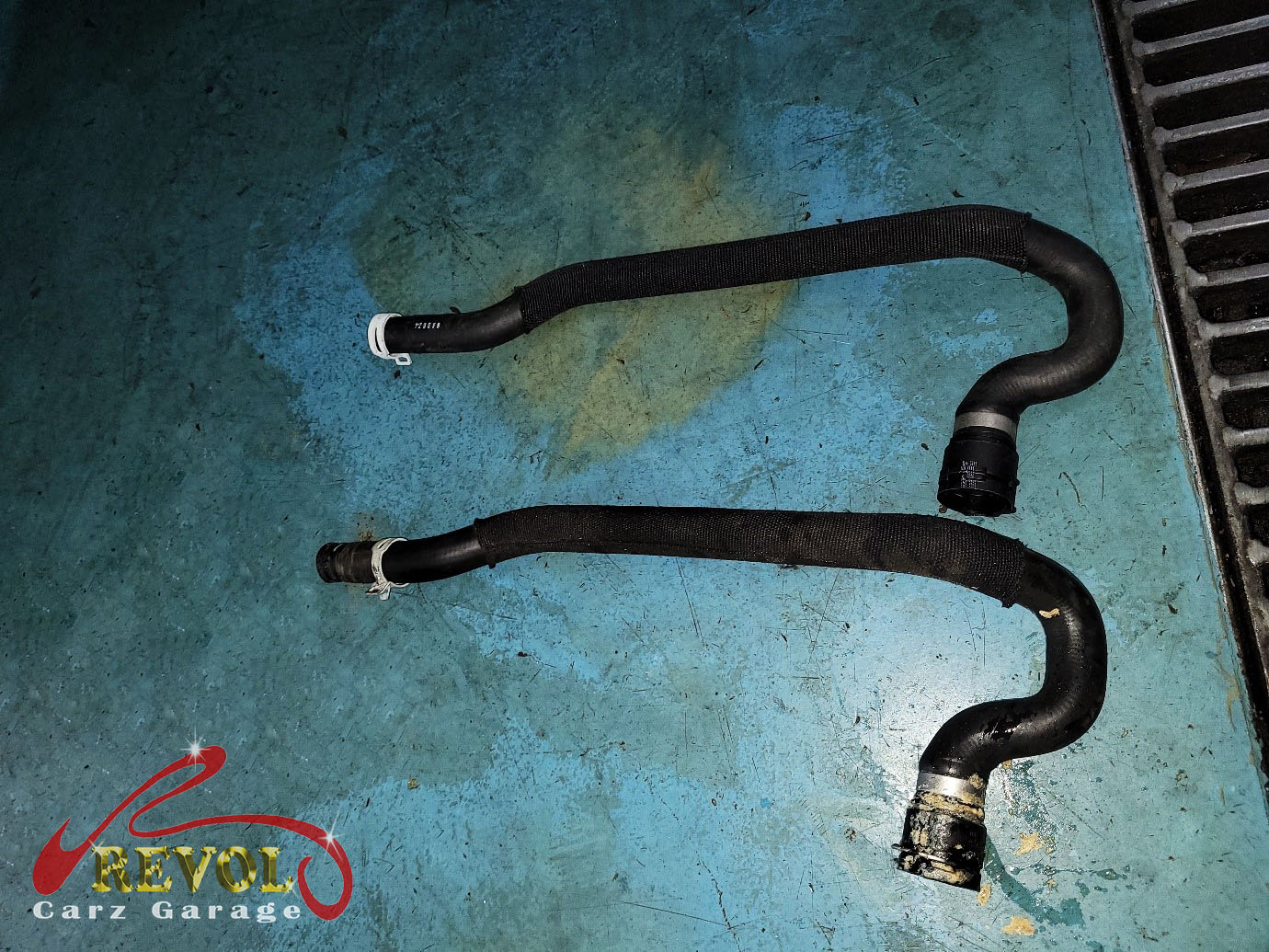

We noticed cake of powdery residue formed at the Upper Hose connection. Squeeze tests confirmed the Hose was stressed and cracked.
Genuine BMW 528i Radiator Top Hose engineered for factory performance (Top) ready for the swap.
Notably the Return Hose is bloated with internal wall choked with Coolant residue (Bottom). Replacement is imminent.
With the principal issue addressed, we also checked other components and found the bad Return Hose also needed replacement.
The BMW 528i leaves our Garage freshened and sparkling with a complimentary car wash and interior vacuuming.

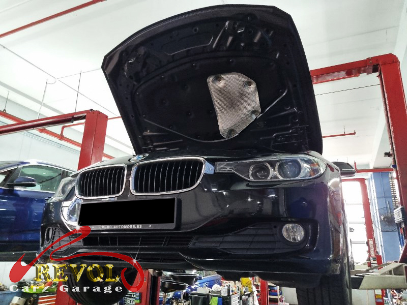

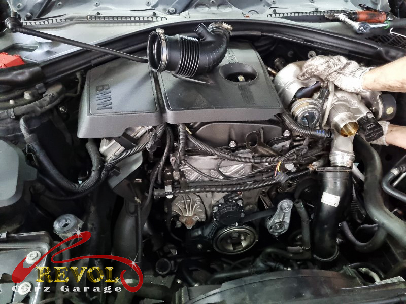

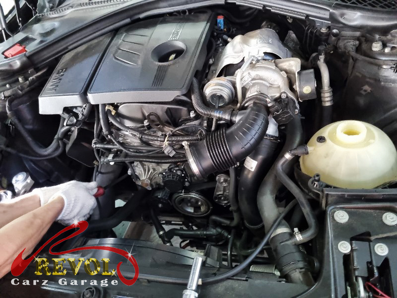

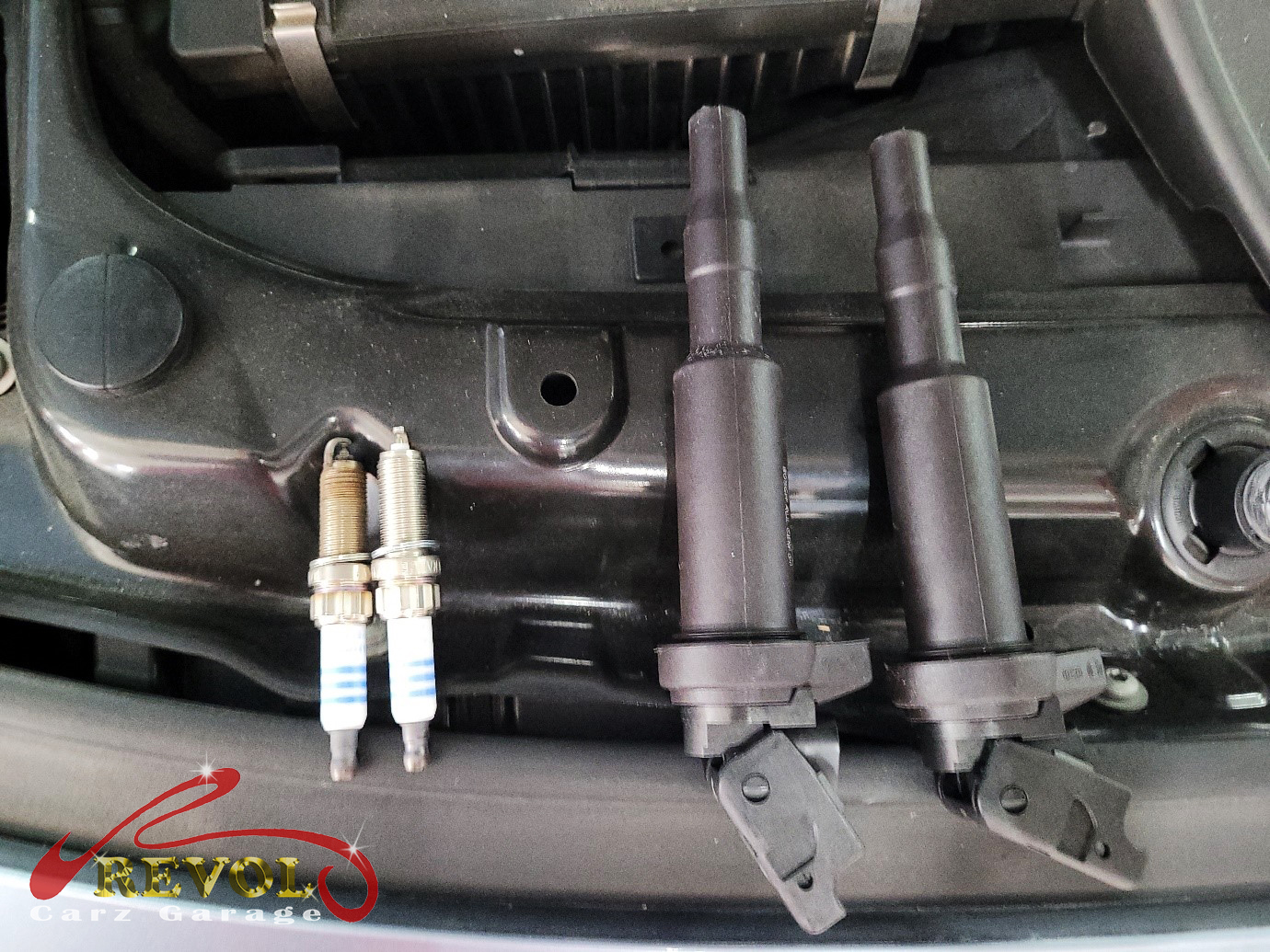

The BMW 320i is having engine check light and misfiring!
Mr. David BMW 320i ran poorly with misfiring with loss of power and visited Revol Carz Garage for assistance.
Our BMW Specialist swiftly detected the issues related to the faulty Ignition Coils and worn out Spark Plugs. Replacing them easily resolved the problem.
Mr. David BMW 320i drives like a dream after the restoration. A small celebration in the finale is timely for a refreshening car wash and interior vacuuming.

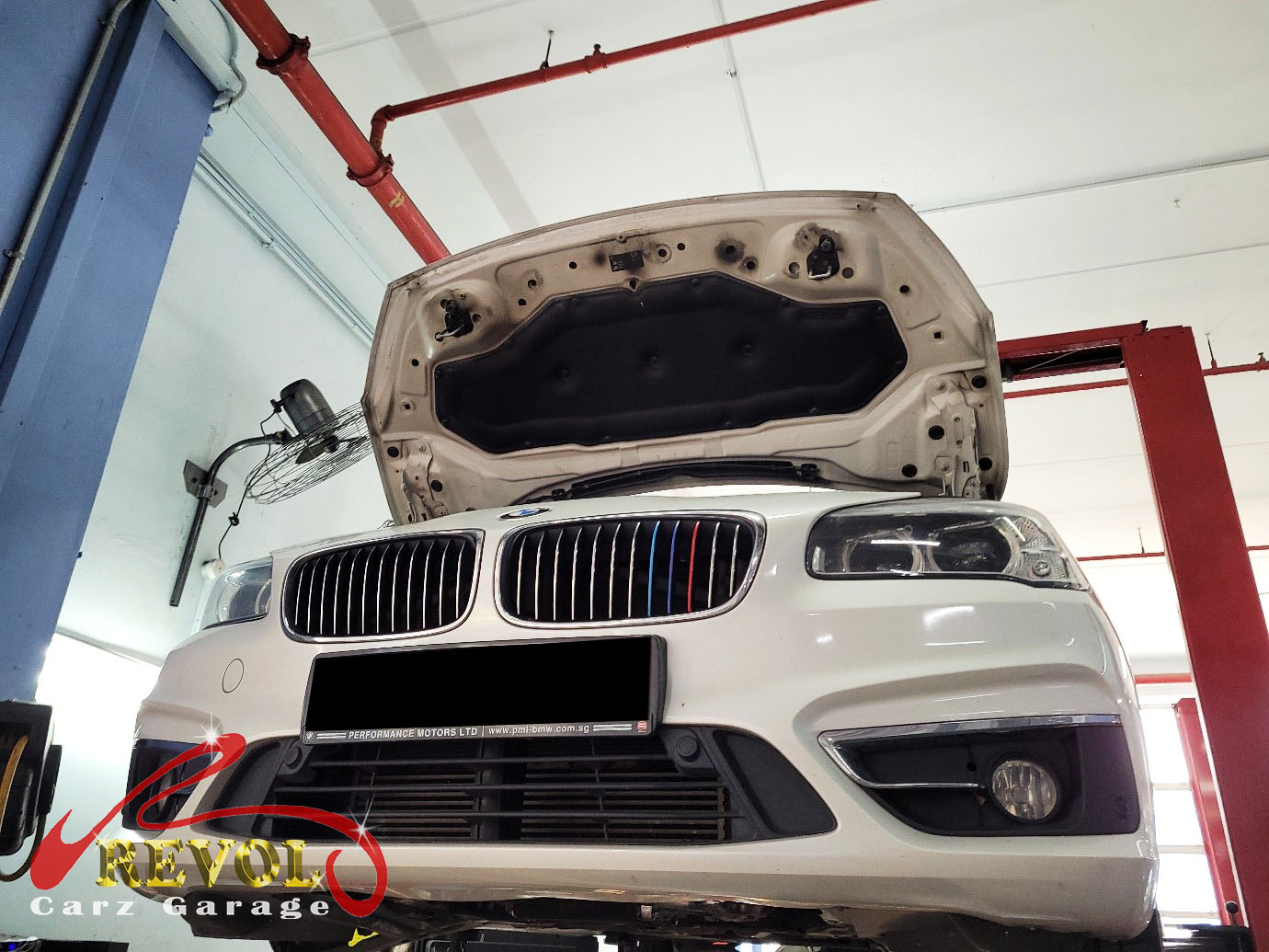

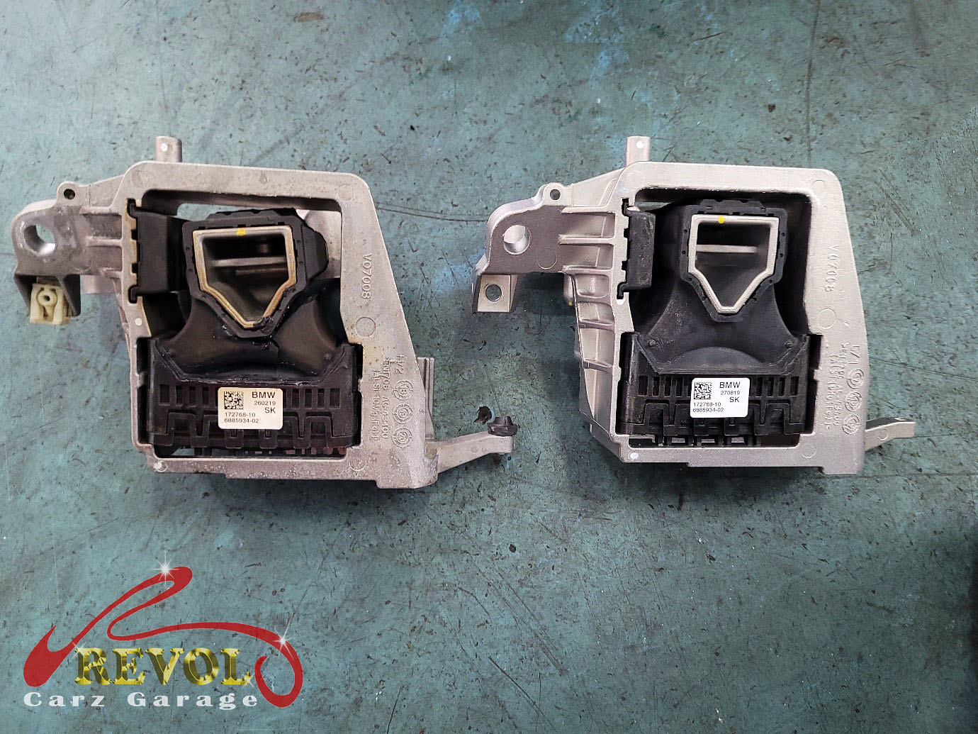

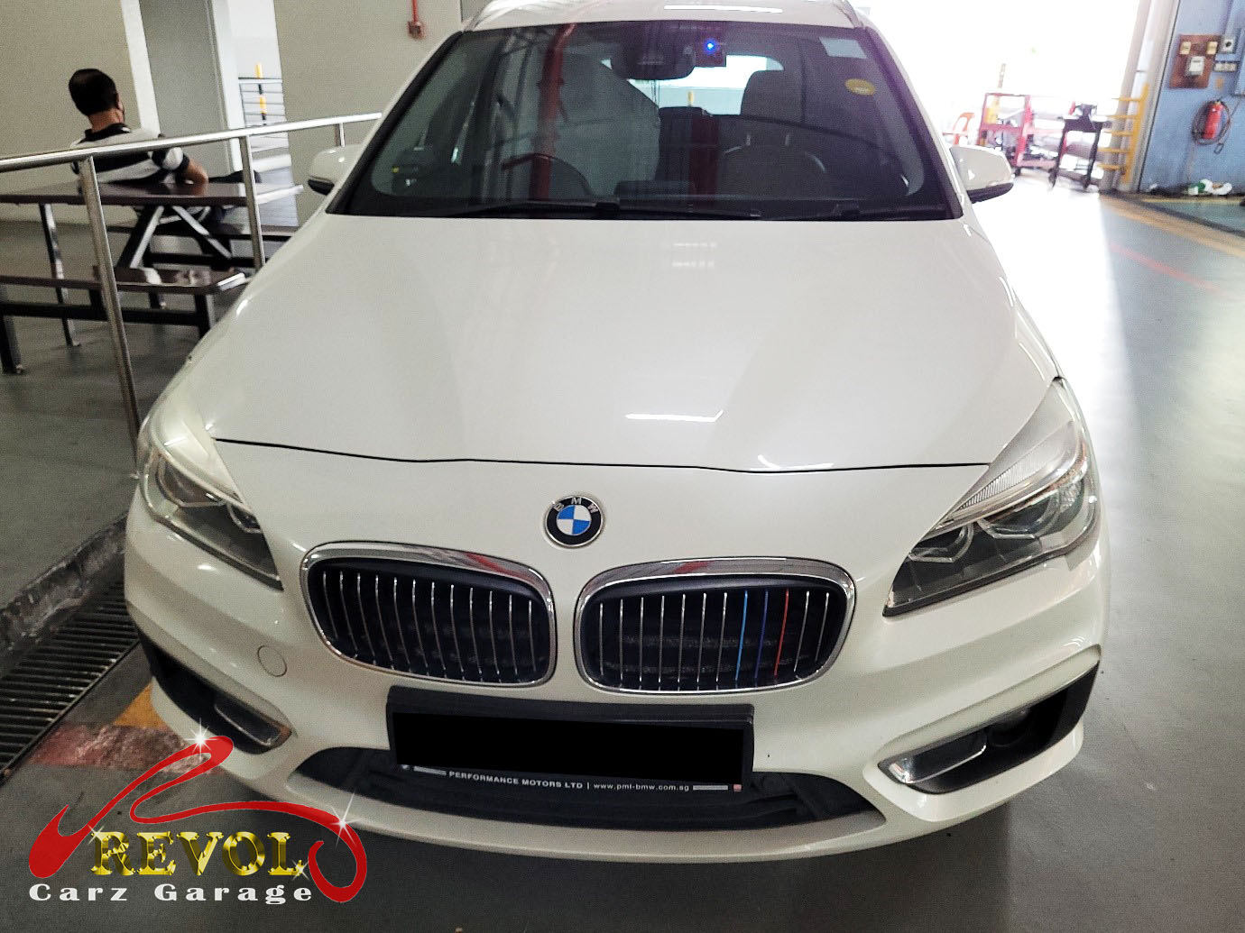

Loud noise with excessive vibrations due to bad Engine Mount led to stressing Gearbox Mounting.
The BMW X1 pulls up at Revol Carz Garage to fix noisy vibrations with symptoms of failed Engine and Gearbox mounting.
Our BMW Team knows where to zero in to the issue. The X1 is lifted for a visual inspection of the Engine and Gearbox mountings.
We found the old Engine Rubber Mount had already hardened over time. A new BMW original Engine Mounting (Right) was expedited for the replacement.
At the left is another part of the failed Engine Mount being replaced with an original BMW part.
Excessive vibrations from bad Engine Mounts also affect the Gearbox mounting over time (Right). The original BMW Gearbox Mounting is ready for the exchange.
A shout out for the issues swiftly solved! No noisy Engine and Gearbox vibration but a silky-smooth quiet ride on the BMW X1.

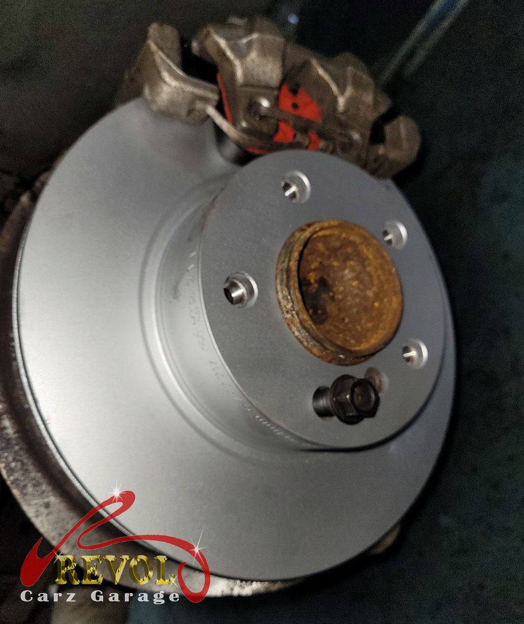

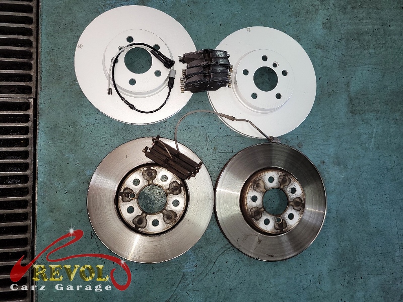

We can accomplish a quick BMW Brake System replacement while you wait.
Do feel free to drop by Revol Carz Garage at 10, Ang Mo Kio Industrial park 2a # 02-18 Ang Mo Kio Autopoint or contact us at 6555 1171 or whatsapp us at https://api.whatsapp.com/send?phone=6593222338 for assistance.
The BMW X1 owner made a pit stop at Revol Carz Garage for Brake Pads and Discs replacement fast with precision efficiency.
With clockwork precision, the worn Brake Pads and Discs are dismantled.
New set of original BMW Brake Pads and Discs are expedited for quick replacement.
The new Brake Pads and Discs are professionally replaced in quick time.
With the new Brake Pads and discs, the X1 is ready to vroom safely off.

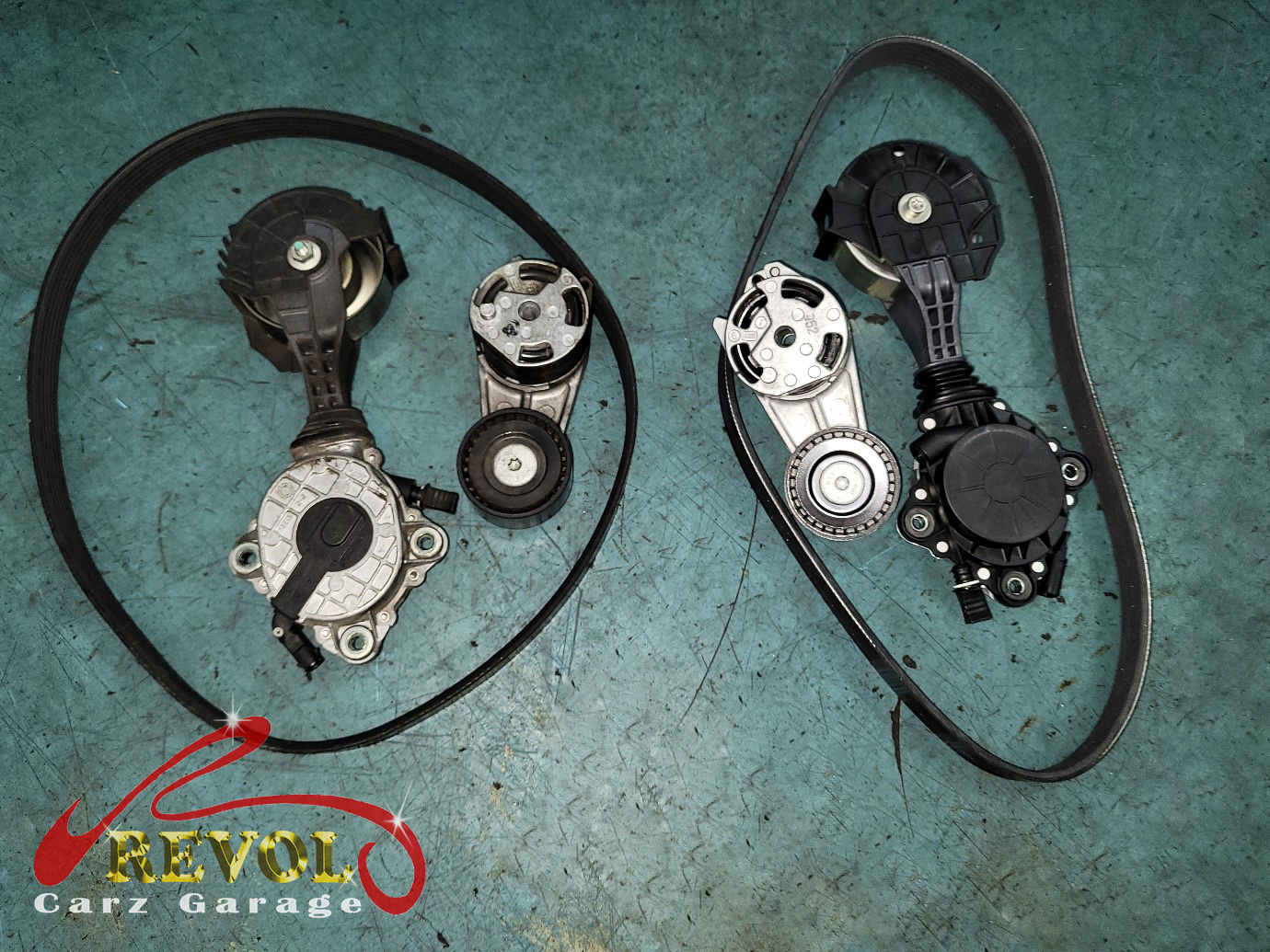

Fan Belt squeal prompted the BMW 316i to call at Revol Carz Garage for services.
For worry-free driving safety, the BMW is lifted for a thorough check to ensure all parts are roadworthy.
We traced the annoying squealing noise to the slipped Fan Belt and misaligned Tensioner and Idle Bearing.
The squealing noise was resolved with installing the new Fan Belt, Tensioner and Idle Bearing (Right).
With the new Fan Belt Set, the owner enjoys the BMW whisper-quietly ride.

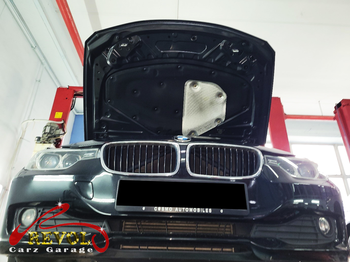

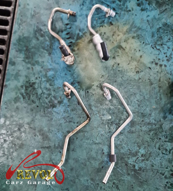

If you need to top up Coolant twice within 1 or 2 months you have a Coolant leak in your Cooling System.
The BMW 316i is having Engine overheating issue due to Coolant low and visited Revol Carz Garage for assistance.
Visual inspection under the Chassis revealed undesirabe wet-wet oil and Coolant leakage dripping down the Engine compartment.
Our BMW Specialist set out to check the mysterious sources of the leak.
Found – the Turbo Coolant Pipe that had sprung a leak.
The bad Turbo Coolant Pipes (left) are ready to swap with the new replacement.
With every leaky problem resolved and endorsed by our stringent QC Team, the BMW deserved our complimentary car wash and interior vacuuming before handing her back to the owner.

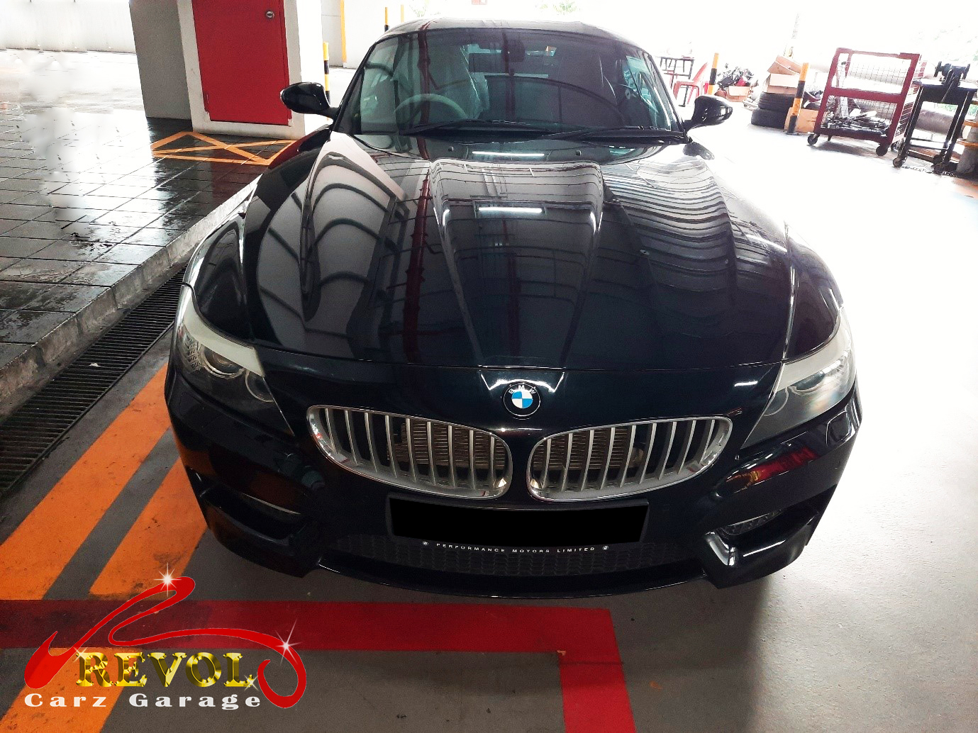

The Driver noticed a pool of oil under his BMW Z4 in the morning. Loss of engine oil can lead to devastating consequences. Our BMW Specialists at Revol Carz Garage can nail the issue professionally.
The worrisome Driver of the BMW Z4 arrives at Revol Carz Garage to rectify the oil leaks from under the engine.
The Z4 is elevated to inspect the source of the oil leak for repair.
Leaks were found in the Oil Sump. A new set of original BMW Oil Sump, Gasket and O-rings is ready for the replacement.
The leaky issues were swiftly resolved with the engine oil topped up and a rigorous test run by our rigid QC team before beckoning the BMW Z4 for a car wash and interior vacuuming.

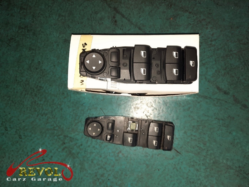

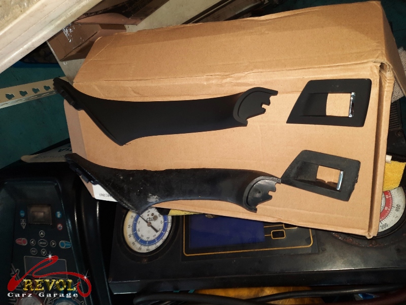

The Driver experienced frustrating issues with opening and closing the BMW 520i Windows and his trusted mechanic at Revol Carz Garage promptly addressed the issue promptly and safely.
Faulty Window switches in the BMW 520i got the driver frustrated. Get help from our BMW experts to swiftly solve any issue correctly.

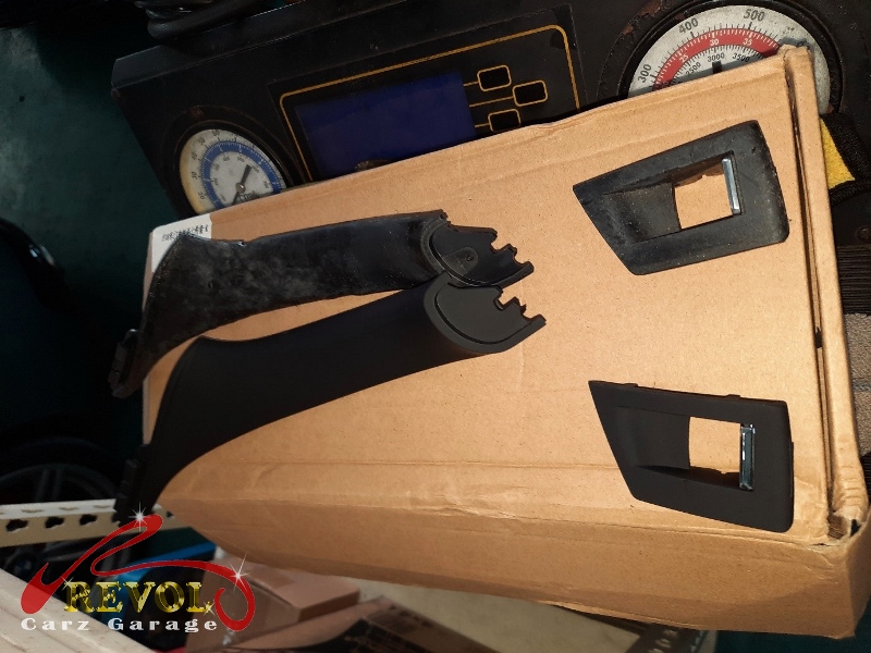

Vigorous testing the electrical system uncovered the front right gang of Power Window Switches were indeed faulty (Bottom). A new set is ready for the swap.
The owner requested all the weathered and deformed plastic handles replaced.
The deformed Passenger Door Handle (Bottom) is being replaced, pairing with the Top ones.
The deformed Driver Door Handle (Top) is being replaced.
Thumbs up for all the Windows Switches and Mechanism restored swiftly. All repairs with BMW parts come with warranty.

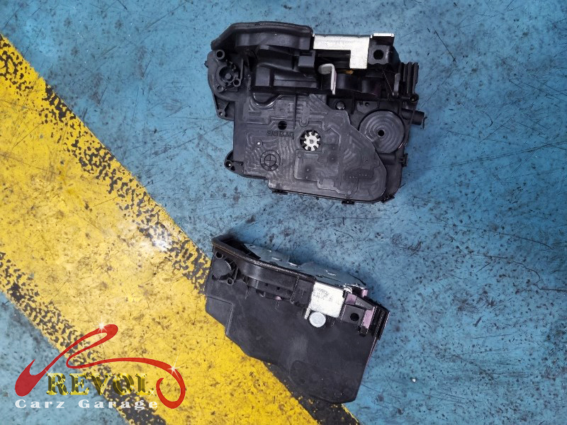

The Driver of a BMW 325i was unable to unlockhis Rear Passenger Door and decided to send his car in our Garage.
Our regular customer had a problem with unlocking the Rear Passenger Door.
Our BMW Team undoing the Door panel to remove the door lock and saw that the Power Window Regulator was faulty too.
The faulty Power Window Regulator in the Rear Passenger Door is professionally swapped with the new genuine replacement.
The bad Lock in the Rear Passenger Door is replaced.

The BMW 318i which suffered Engine overheating due to rapid loss of Coolant arrives at Revol Carz Garage for repair.
Work in progress with tracing the root of Coolant leaks and dismantling the leaking Radiator.
New Genuine BMW Radiator (Left) is ready to replace the bad one.
The faulty Coolant Pump is ready to swap with the new (Right).
Genuine BMW Thermostat (Left) for immediate replacement.
We felt a sense of accomplishment having restored the BMW 318i to factory performance. A complimentary car-wash and interior vacuuming adds to the driver’s delight.
If you encounter similar circumstances with your BMW, feel free to contact us for professional repair. With decades of experience, our BMW can trouble-shoot any issue in your BMW.

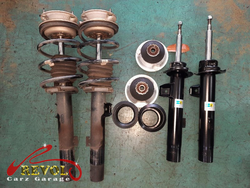

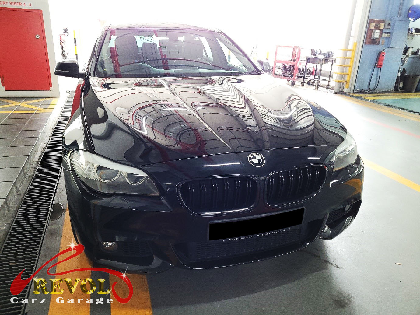

The BMW 520i arrives at Revol Carz Garage for Shock Absorber issue.
Elevating the BMW for a thorough check on all Suspensions.
Dismantling the Front Shock Absorbers in progress.
New performance Front Shock Absorbers, Mountings, Stopper with Cover (Left) are ready for the replacement.
New Front Shock Absorbers Set will ensure dynamic performance with perfect road grip and absolute ride comfort.
We are enthusiastic in restoring your BMW to perform to its full potential. Elevate your experience at Revol Carz Garage with guaranteed satisfaction. You can expect the highest standard and personal service at a competitive price.

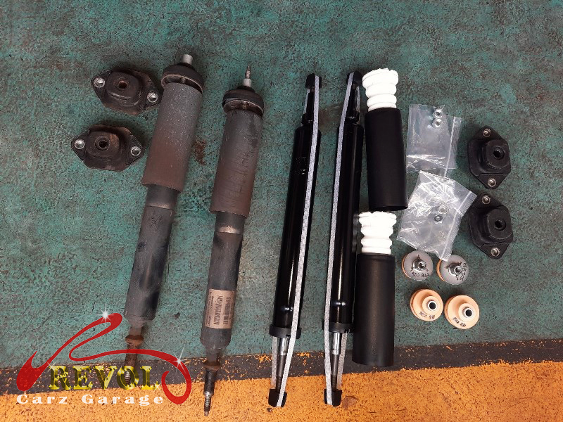

The BMW 318i made it to Revol Carz Garage for Shock Absorber issues that experience vibrations with vehicle while driving.
The thorough visual inspection commenced with elevating the BMW.
The Front Shock Absorbers have reached the end of the service life.
A pair of new Front Shock Absorbers (Right) ready for installation.
Time for the weak Rear Shock Absorbers to retire.
A new pair of Rear Shock Absorbers complete with Dust Covers and Mountings (Right) are ready to swap with the worn ones.
With all four Shock Absorbers professionally renewed and rigorously tested by our stringent QC team, the job completion is celebrated with a complimentary car wash and vacuuming.
