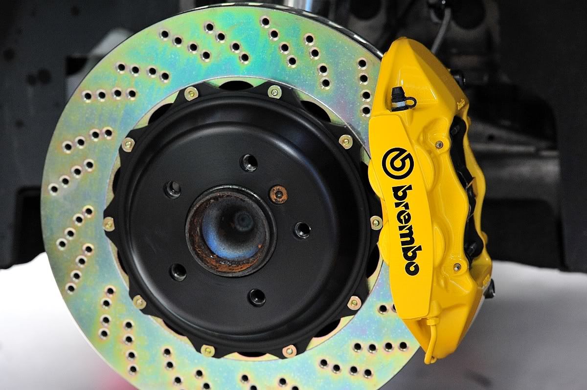

1 complete set for E93 325 with Yellow Calipers arriving next week.
Another complete set for E92 335 with Yellow Calipers arriving next month.
Let me know if you want Brembo or Stoptech BBK for your E92 335.

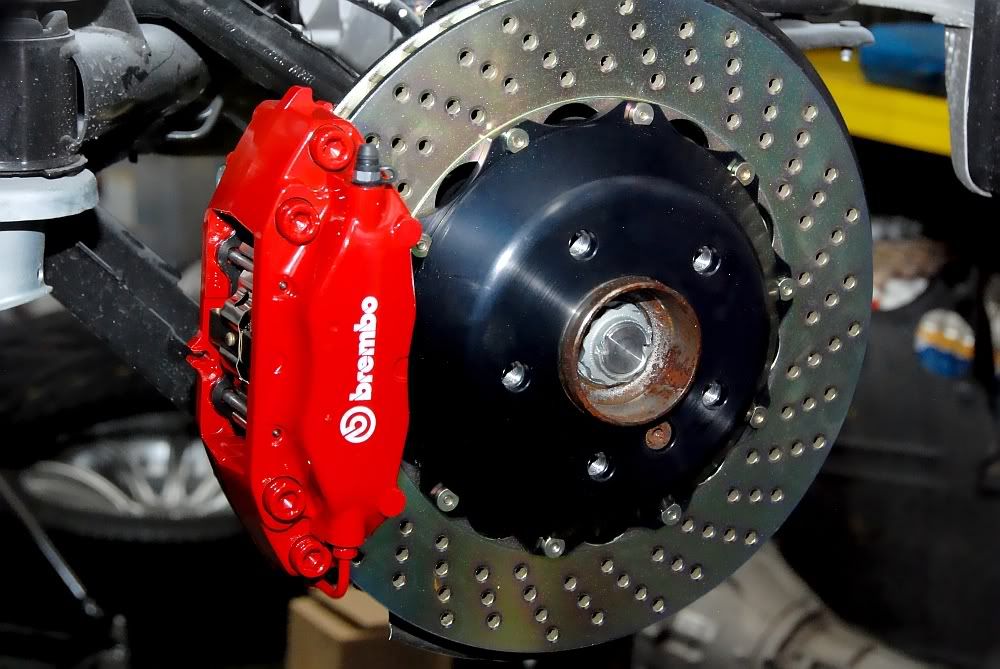

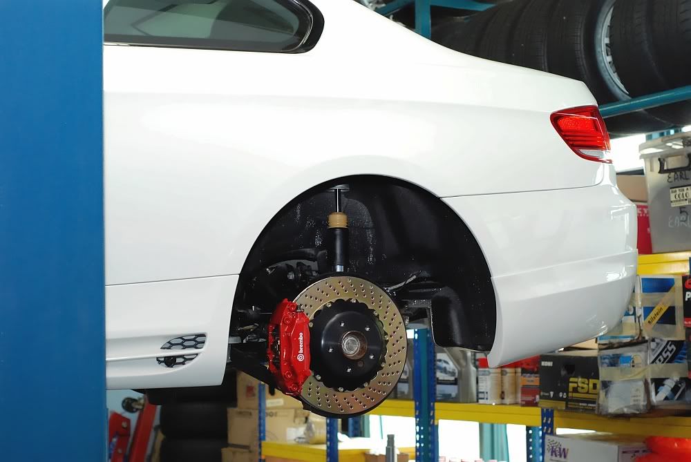

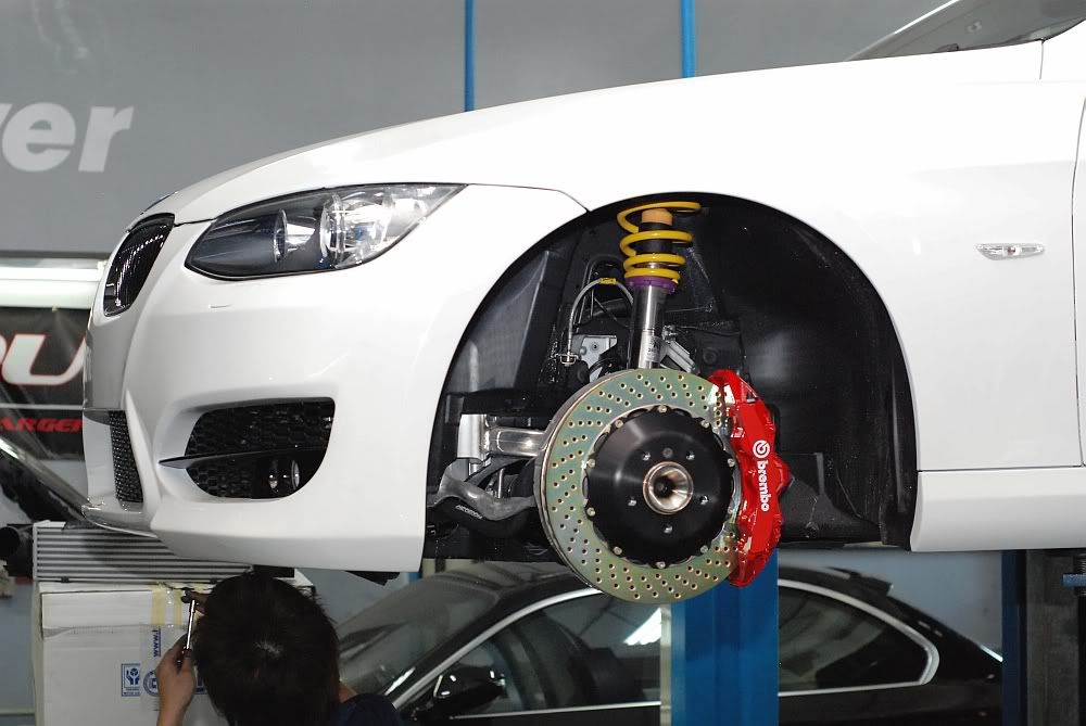

E92 335 with Brembo GT 6pot monobloc

I am running full set Brembo 6/4 for the last 3 years - front monobloc rear is NOT. Beware of paying for full set monobloc ended up getting only front monobloc.

No, I meant many could not tell that the rear has monobloc and non-monobloc version, hence gotta verfiy after paying for full monobloc and not knowing that there is a difference on the rear calipers....
Re: E92 - Change F&R to BBKs
With pictures, if cannot tell the diff then better watch more Sesame Streets Series........
Non monoblock rear 4pot C-Family Caliper
New bigger monoblock 4 pot P-Family Caliper
If still can't tell, then ask for exact part numbers!!
non monoblock 4 pot rear for 335 - 2C1.8021A
monoblock 4 pot rear for 335 - 2P1.8011A
