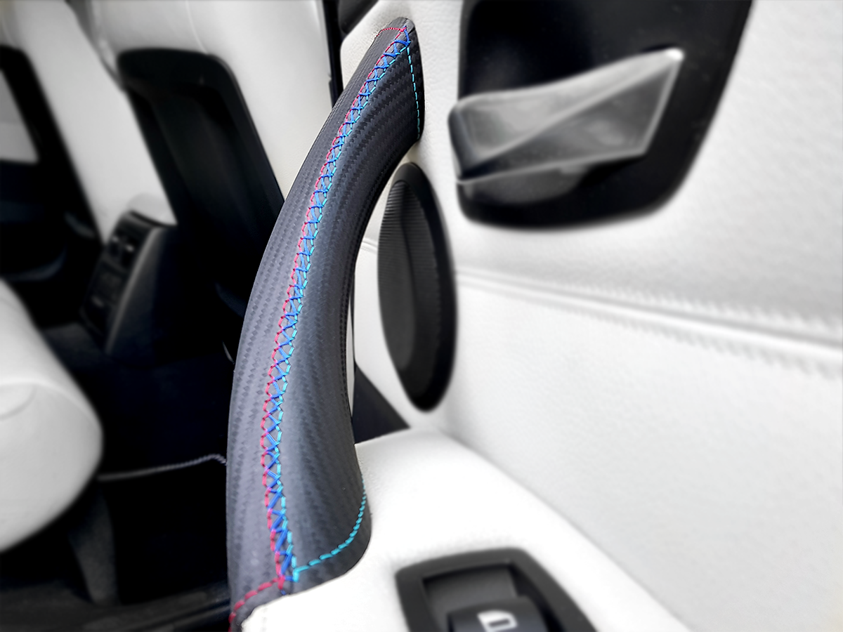

I agree, the carbon fiber looks cool on handles, and I think it is the simplest solution as you don't have to dismantle the door card to install it.
This is how it looks like:
Installation instructions
E9x Door handle cover installation
You can get it from here: BMW door handle covers
