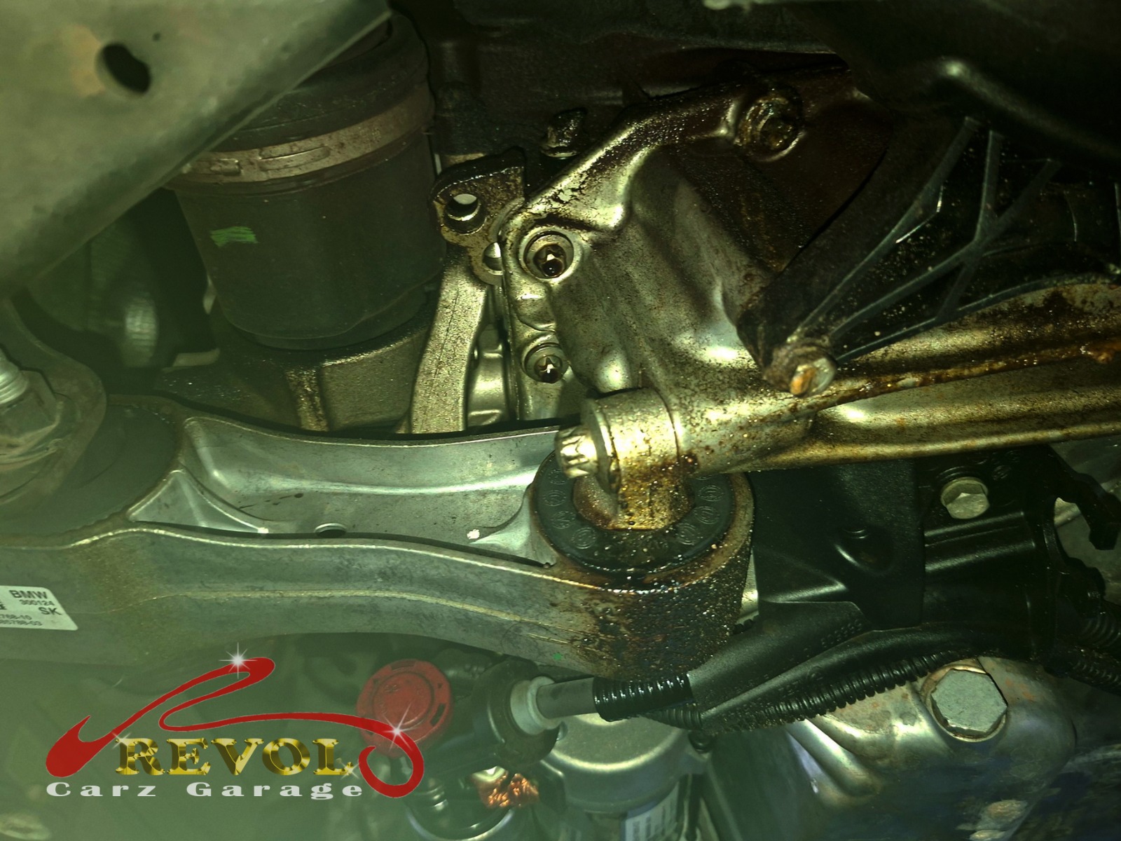

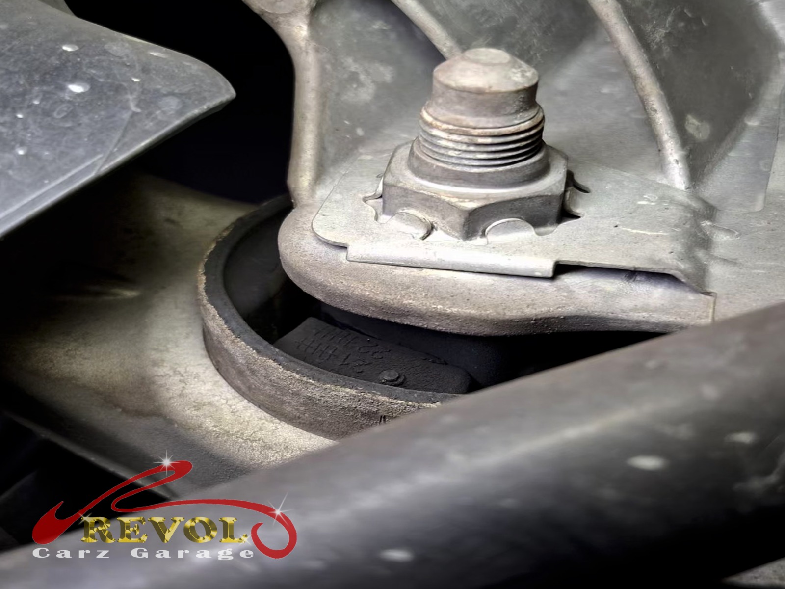

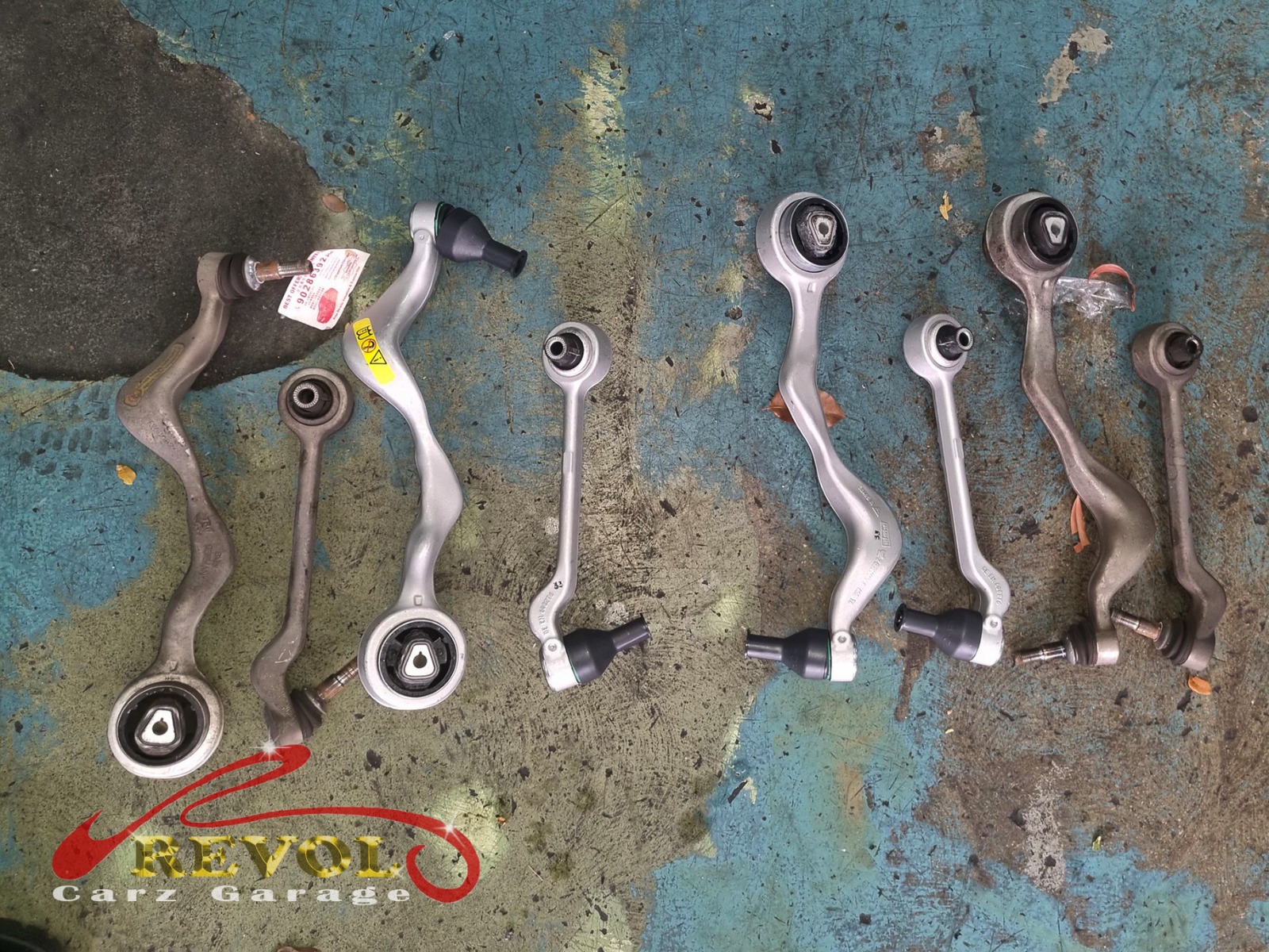

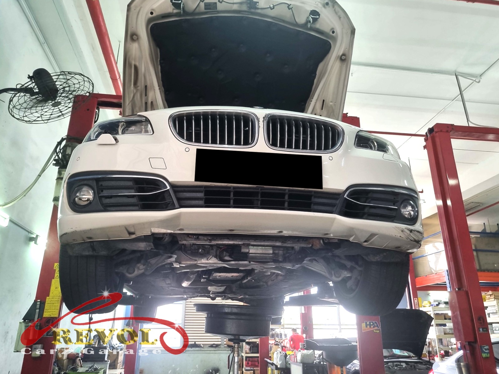

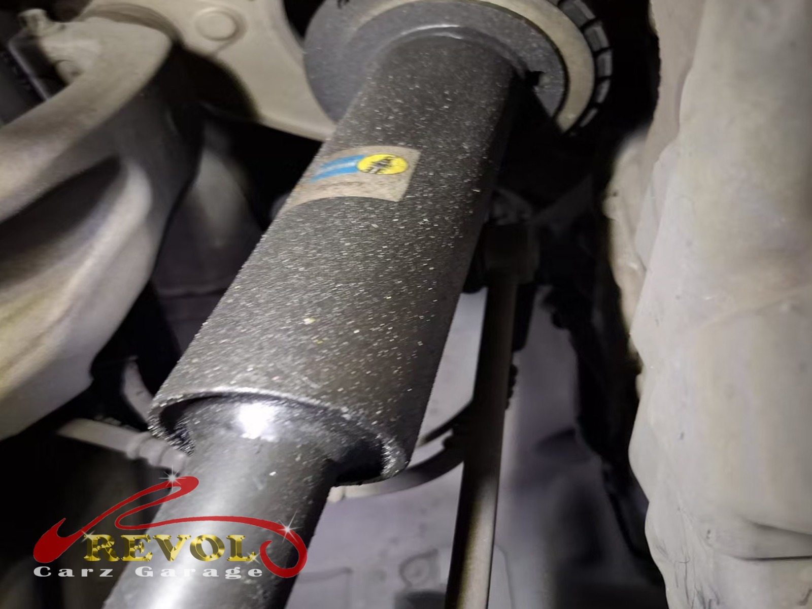

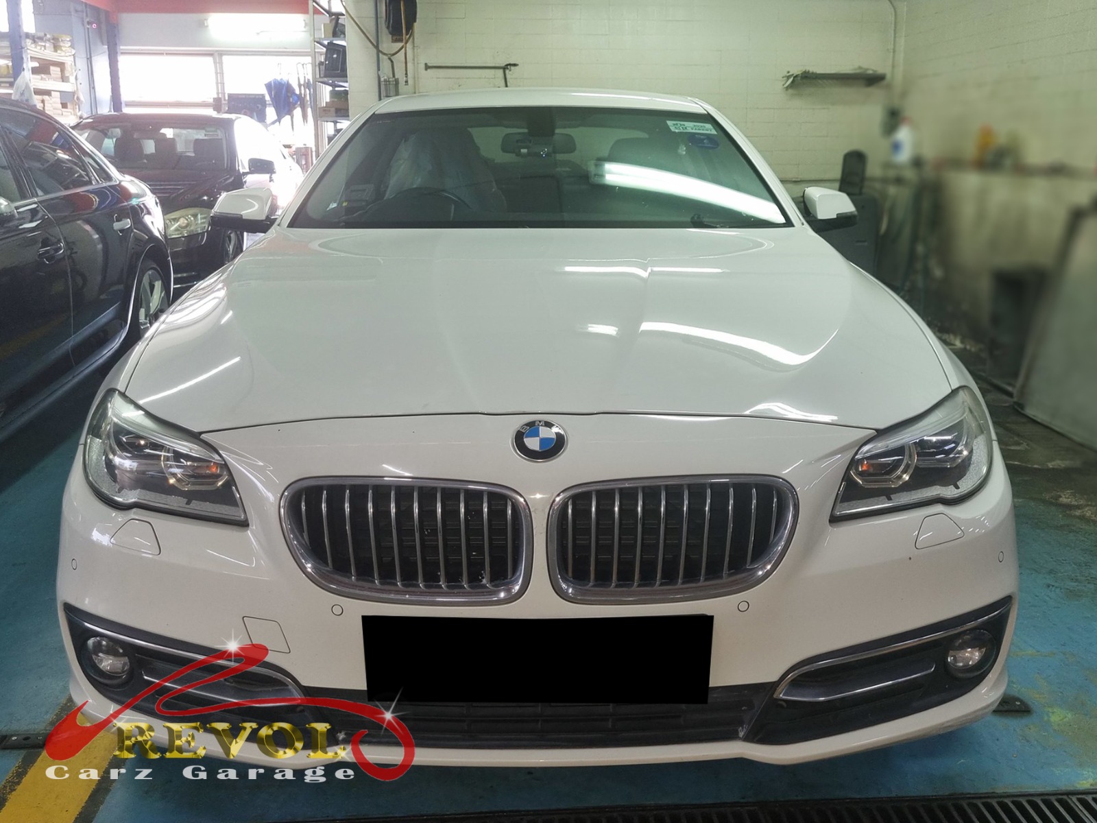

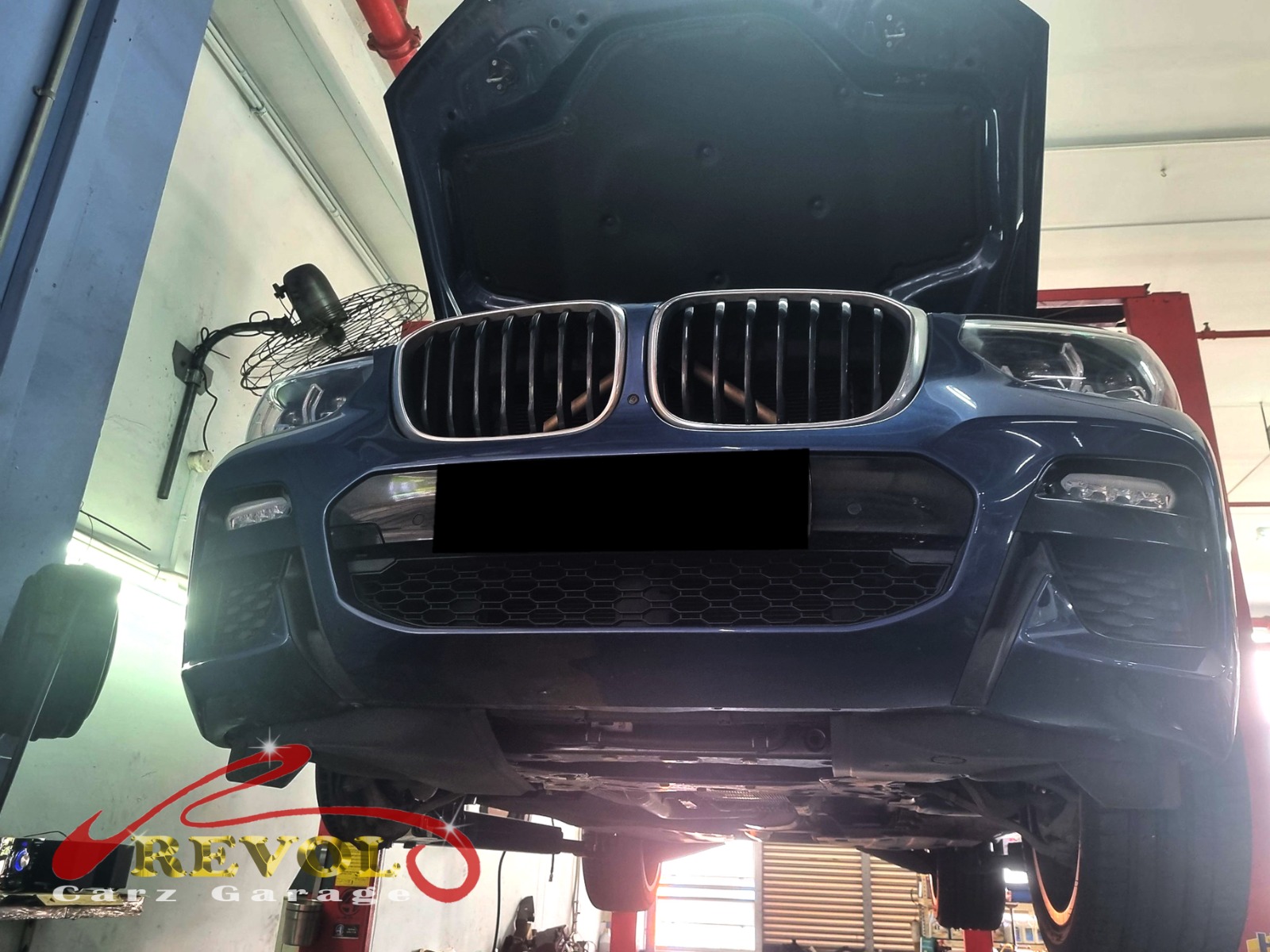

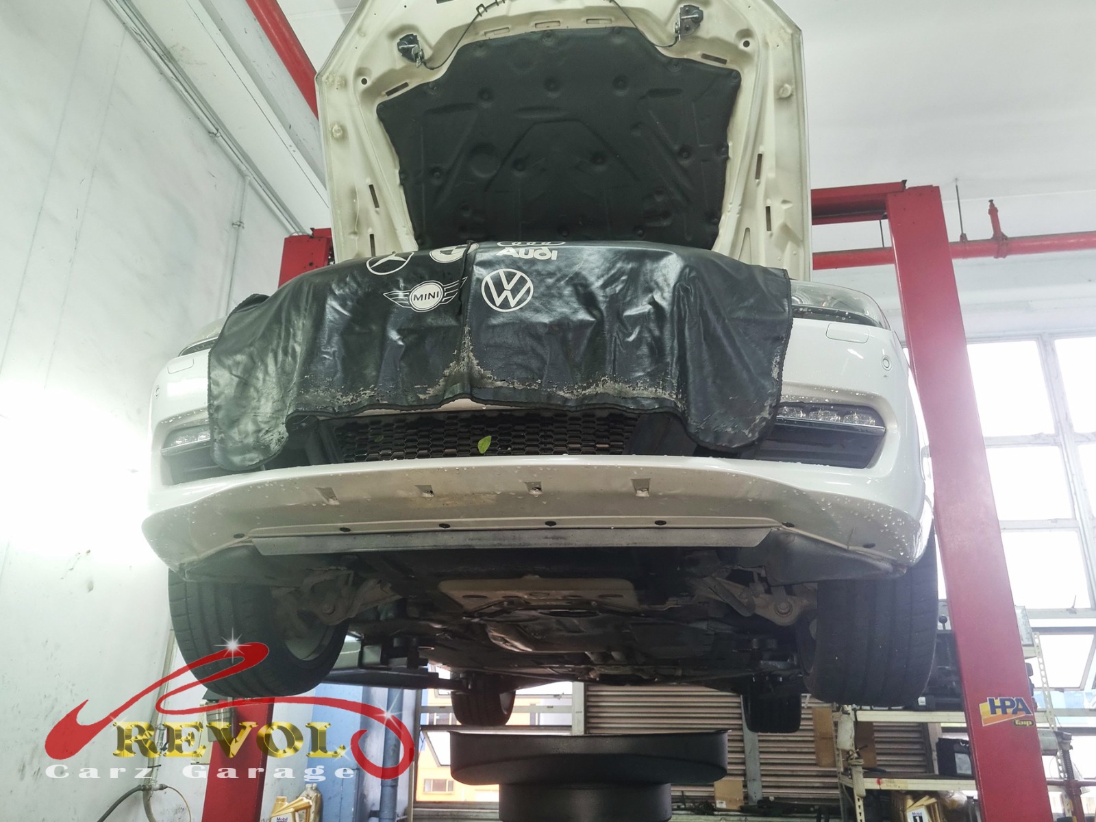

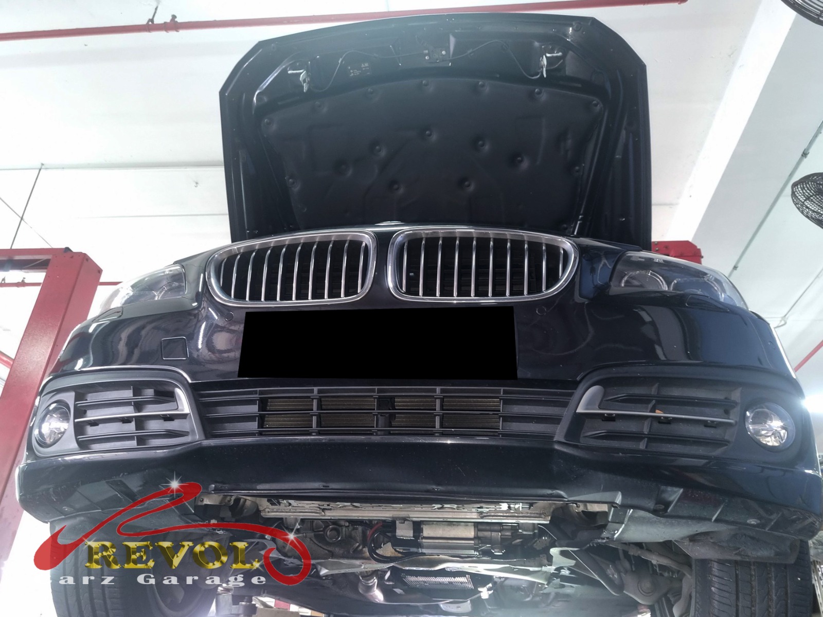

The Owner of a BMW 530i visited Revol Carz Garage after hearing clunking noises while driving, especially over bumps and during turns.
Our Expert BMW Technician lifted the vehicle to perform a thorough inspection of the undercarriage components.
Inspection revealed that the Control Arms were damaged, showing wear and cracks.
Installing new Control Arm components ensures your suspension works optimally, enhancing both performance and driving confidence.

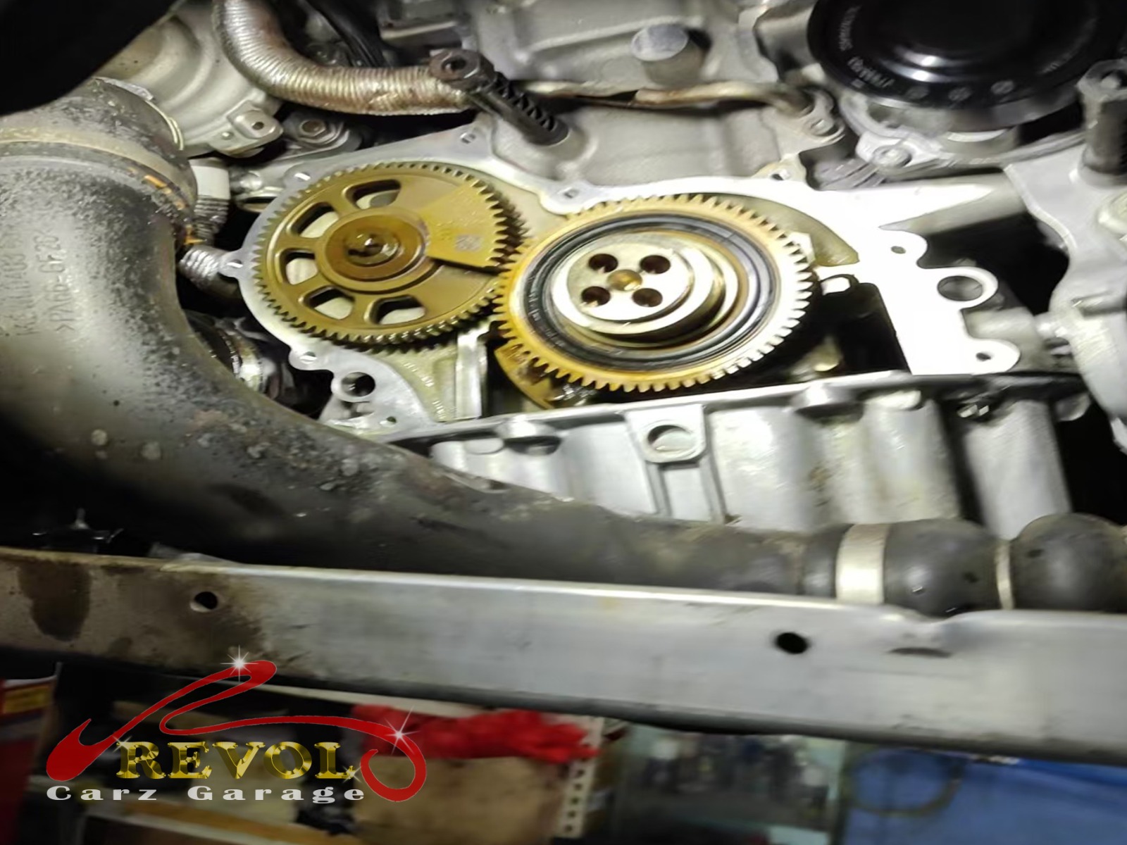

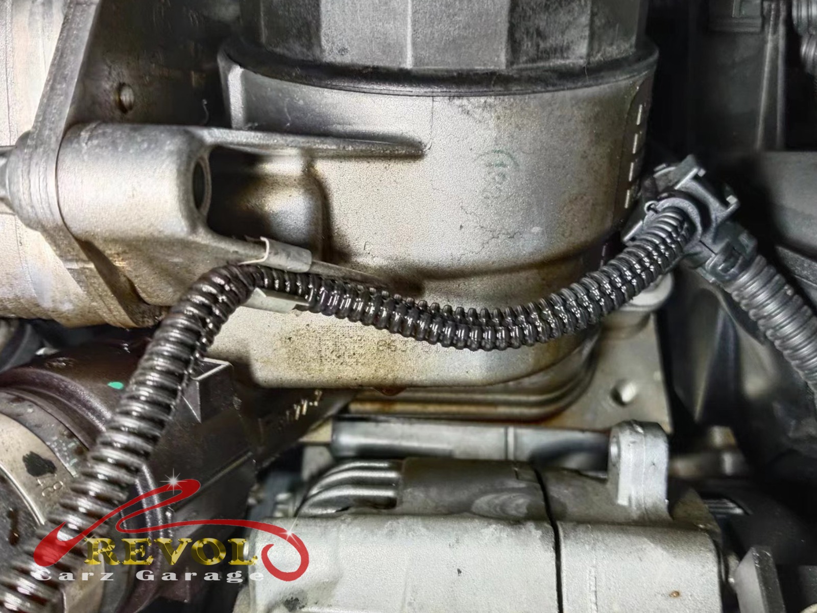

If you’re noticing oil pooling under your engine, oily residue around the Timing Pulley Cover, or needing to top up oil more often, it could be a sign of a timing pulley cover oil leak.
In some cases, you may even smell burning oil if it’s dripping onto hot components. If you’re also hearing knocking or ticking noises, seeing oil pressure warning lights, or experiencing rough idling and misfires, the leak could be affecting your engine’s lubrication and performance.
At Revol Carz Garage, our expert Technicians will accurately diagnose the issue and carry out the necessary repairs. Fixing it early helps maintain smooth performance and prevents costly engine damage.
Don’t ignore the signs—book your inspection today and drive with peace of mind!
Do feel free to drop by Revol Carz Garage at 10, Ang Mo Kio Industrial Park 2A # 02-18 Ang Mo Kio Autopoint or contact us at 6555 1171 or whatsapp us at https://api.whatsapp.com/send?phone=6593222338.
You may also SMS / Whatsapp to Gavin at 9740 6855 for friendly and absolute no obligation consultation.

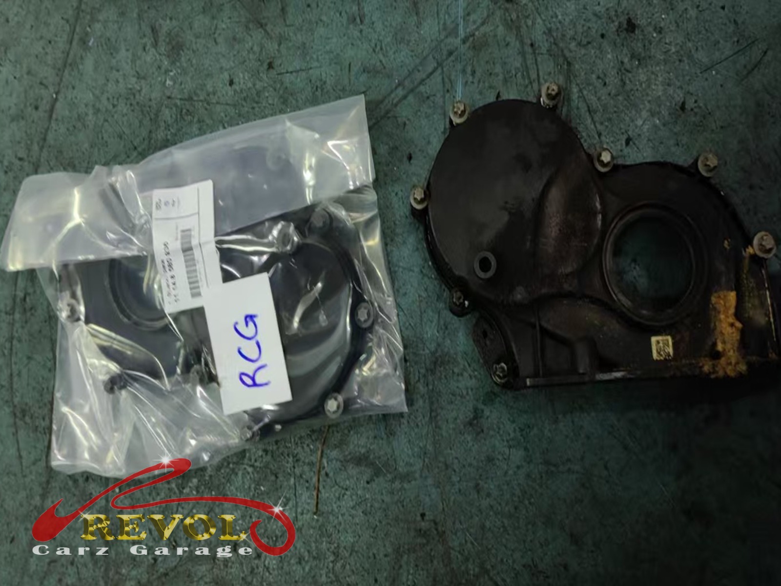

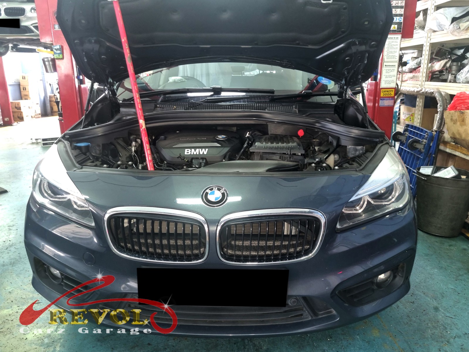

The BMW 216i Owner visited Revol Carz Garage seeking assistance after noticing a significant drop in engine oil level.
Our BMW Expert Technician hoisted the car and conducted a thorough inspection, identifying the timing cover as the source of the oil leak.
Our Technician removed the Timing Cover, performed a detailed cleaning, and assessed it for any wear and tear.
Installing a new Timing Cover is essential to stop oil leaks, protect surrounding components, and maintain overall engine integrity and performance.

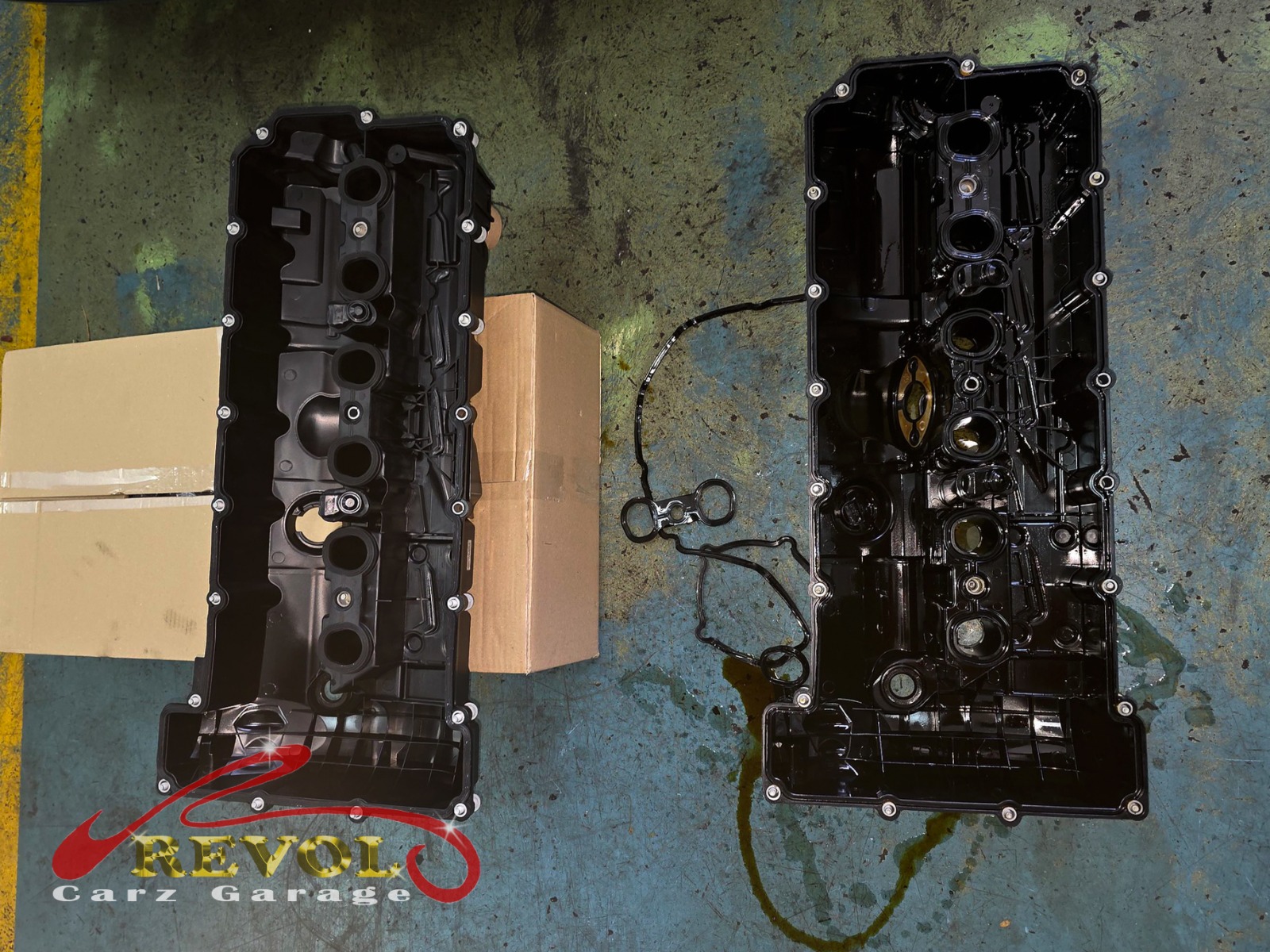

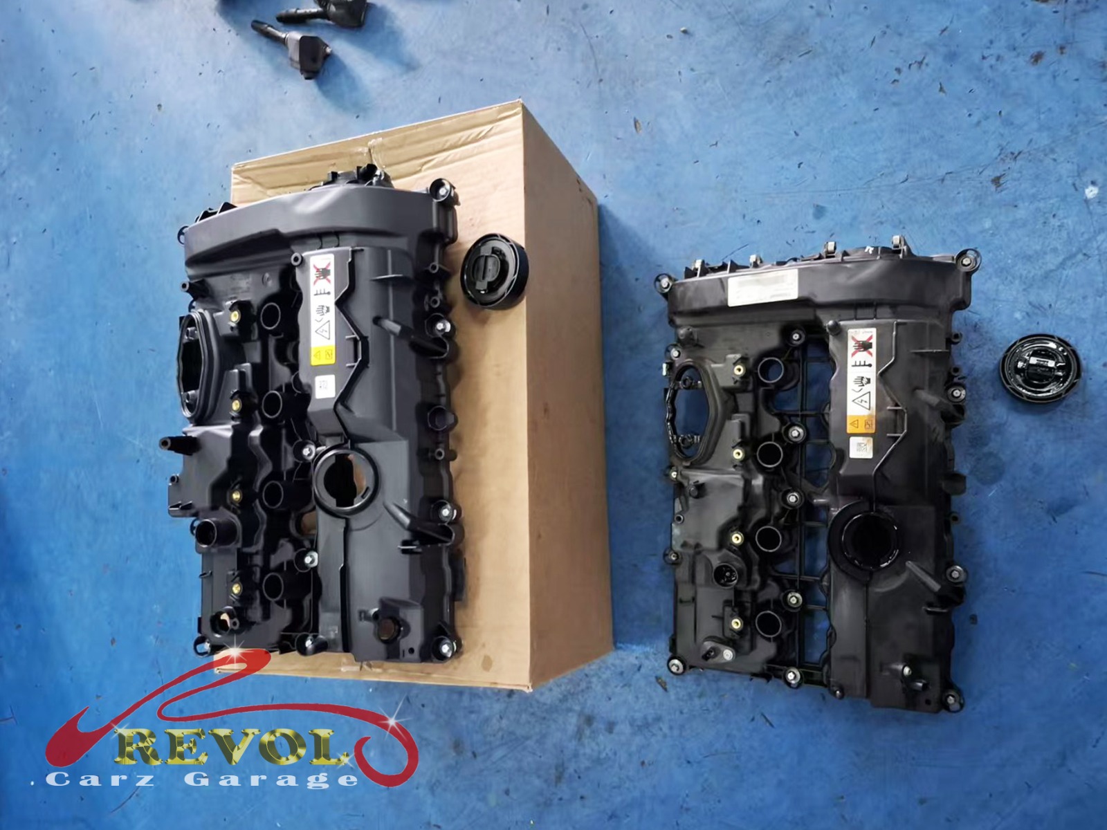

Noticing oil pooling around the Valve Cover, a burning oil smell, smoke coming from the bonnet or experiencing misfires and rough idling? These are often signs of a Valve Cover issue.
Smoke from the engine bay or frequent oil level drops are additional red flags that require immediate attention. Keeping an eye on oil levels and addressing these signs early can help prevent major engine problems.
At Revol Carz Garage, we provide professional diagnostics and effective repairs to resolve valve cover leaks and keep your vehicle running smoothly.

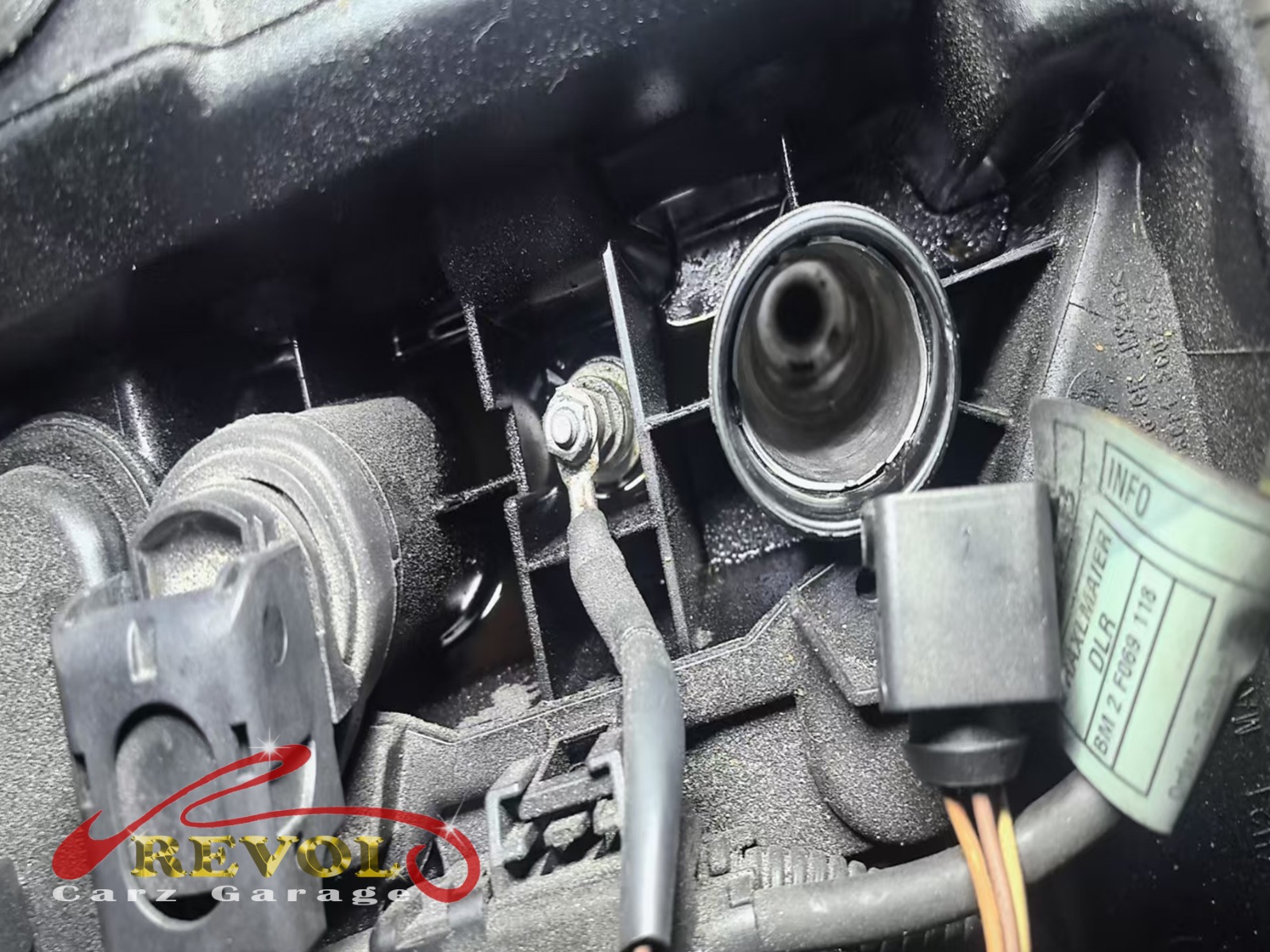

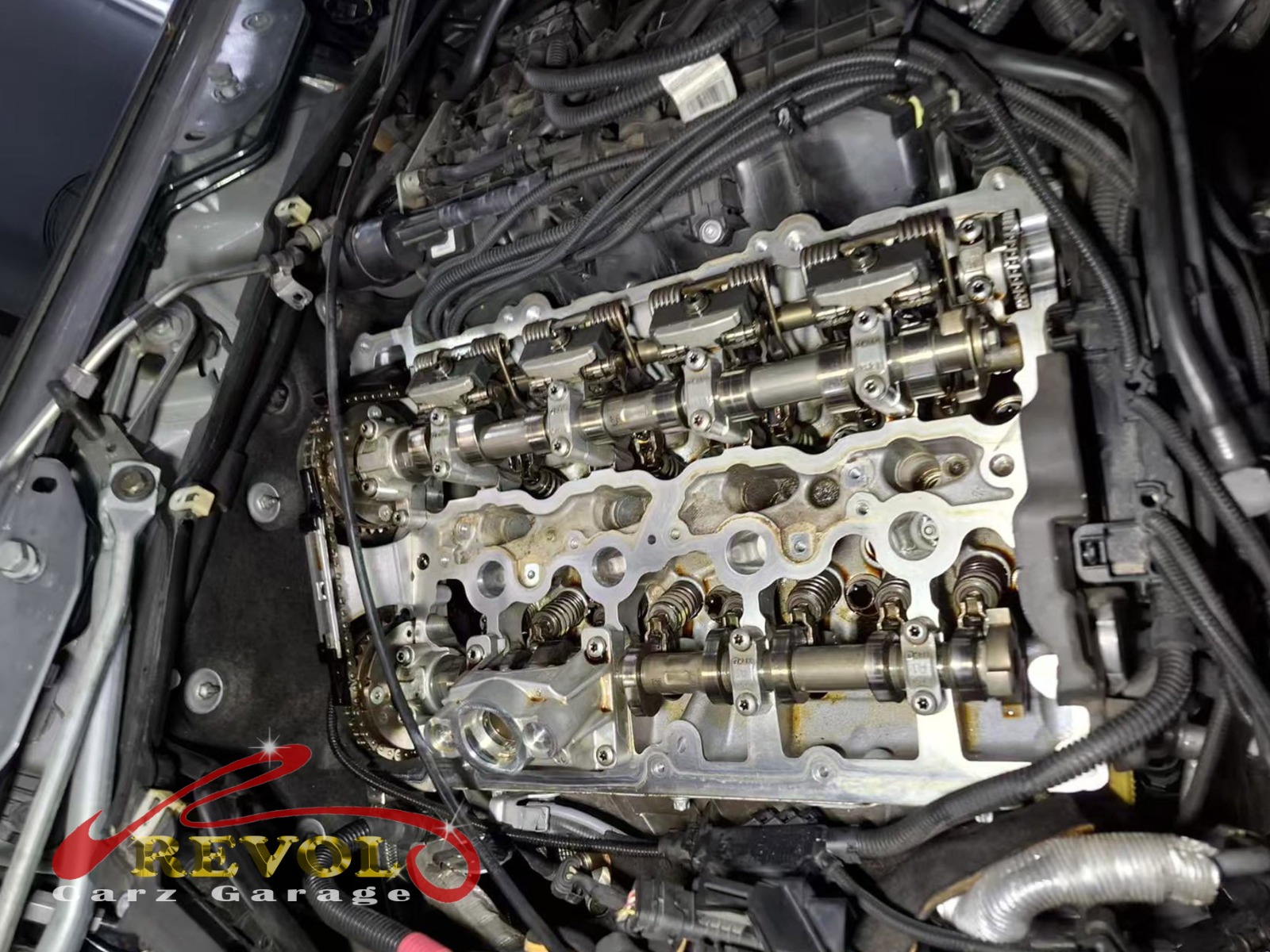

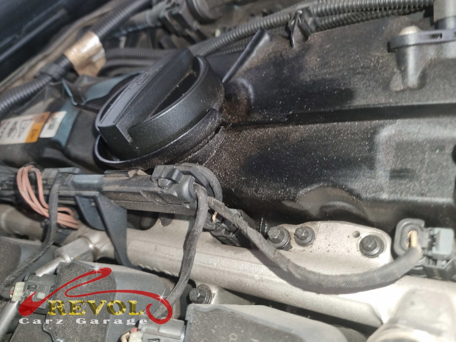

Smoke coming from the Bonnet and a strong burning smell led the BMW 216D Owner to visit Revol Carz Garage.
Our BMW Experts’ inspection revealed wear and tear on the Valve Cover, along with visible signs of oil seepage.
Valve Cover removal is a necessary step to address leaks and ensure the engine stays well-maintained.
Replacing the worn Valve Cover to resolve the oil leak eliminates smoke and burning odors, improves engine performance, and protects against potential damage.

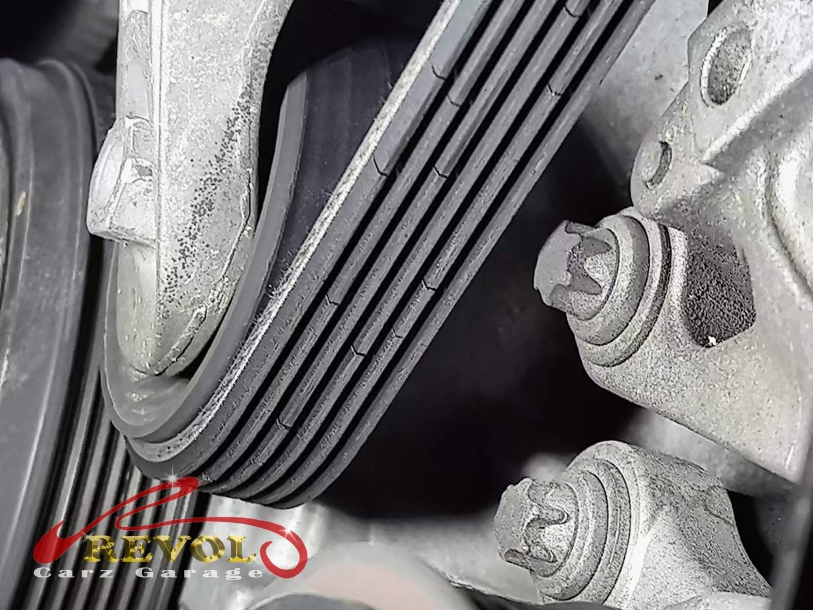

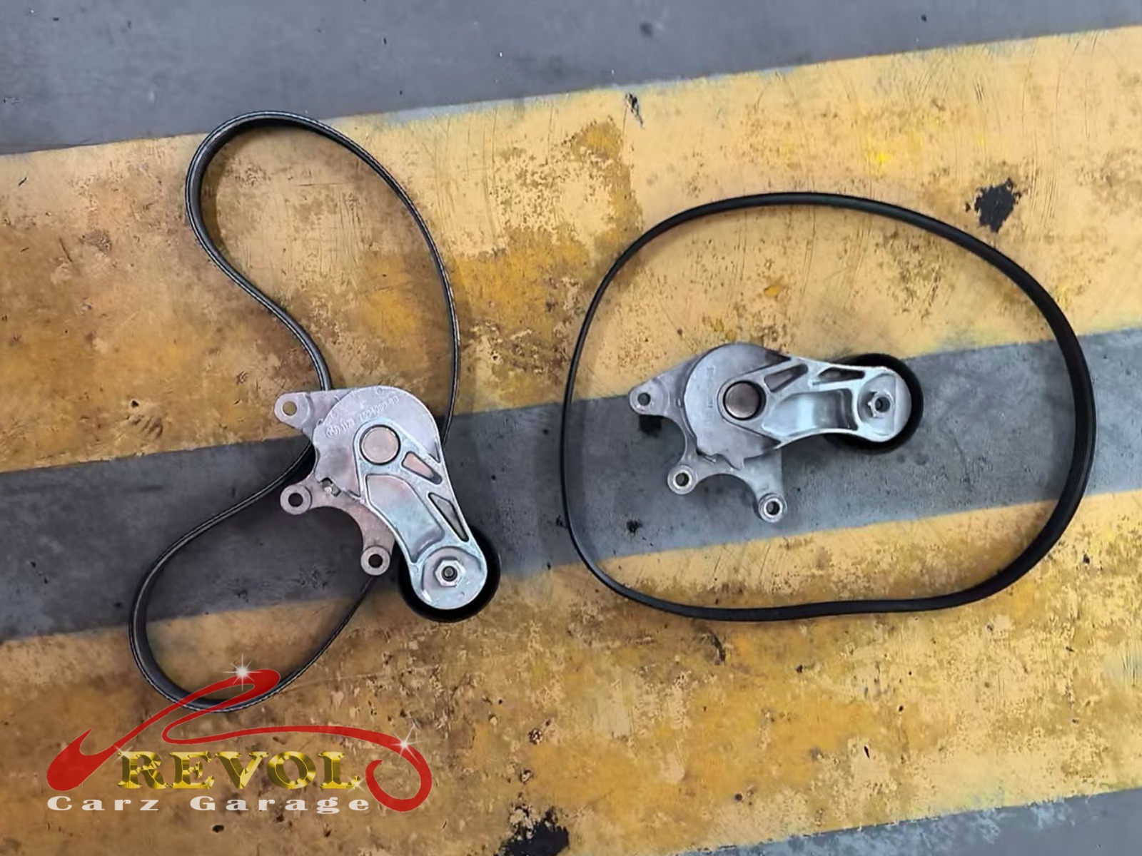

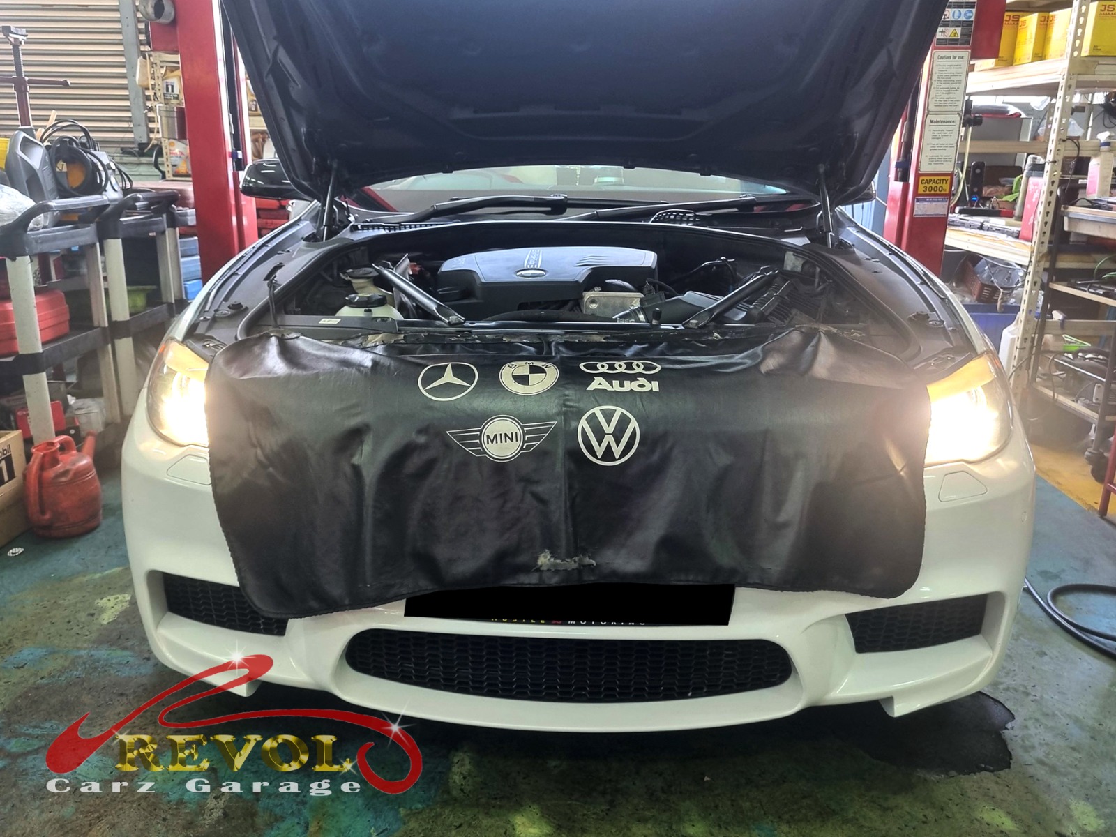

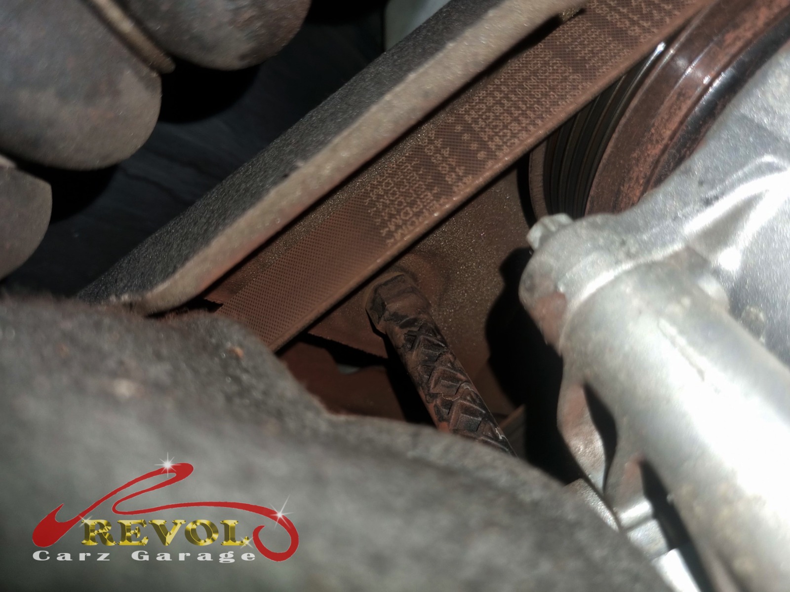

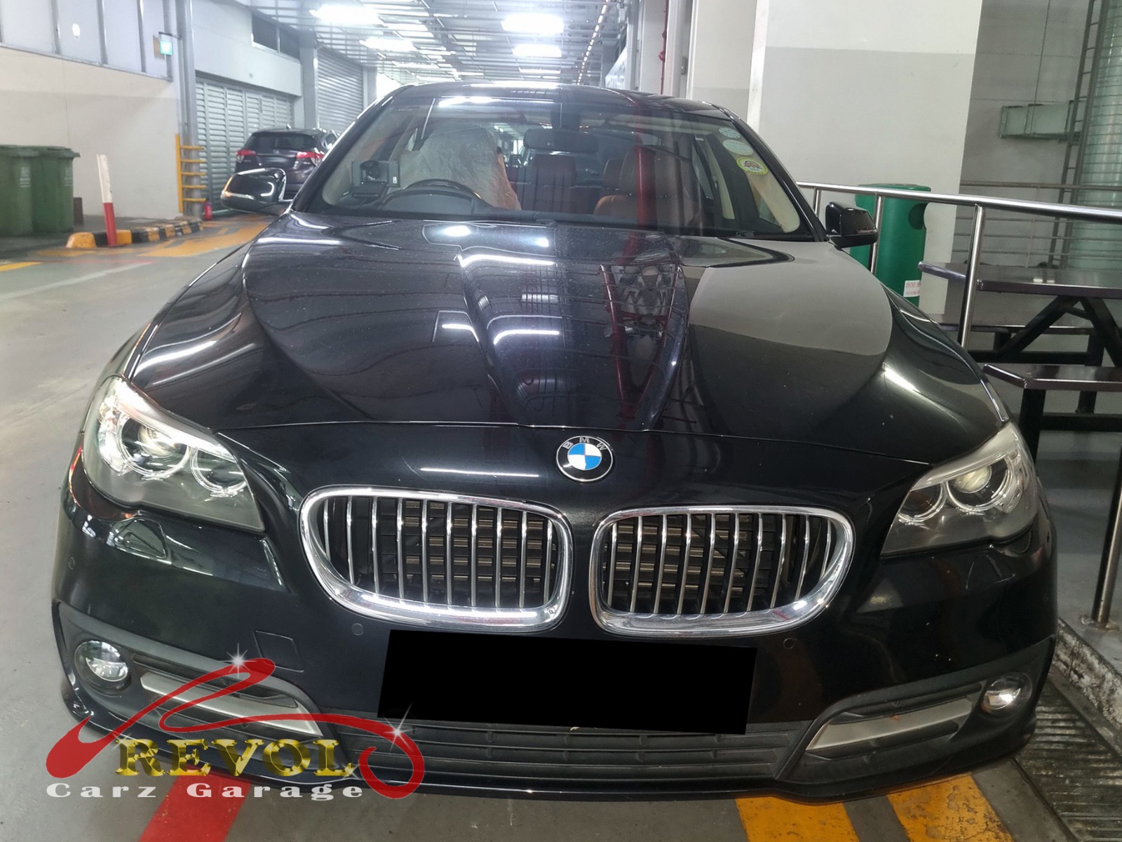

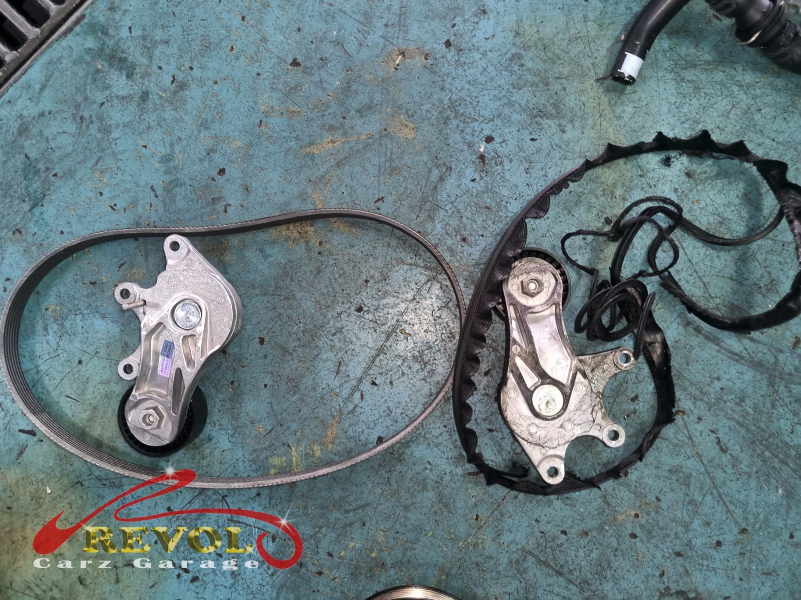

The Owner of a BMW 528i visited Revol Carz Garage for a timely replacement of the Fan Belt Set.
The Fan Belt and Tensioner start to wear and degrade after a vehicle surpasses 120,000 kilometers.
Replacing the Fan Belt and Tensioner guarantees optimal engine function, protects against wear, and enhances efficiency.

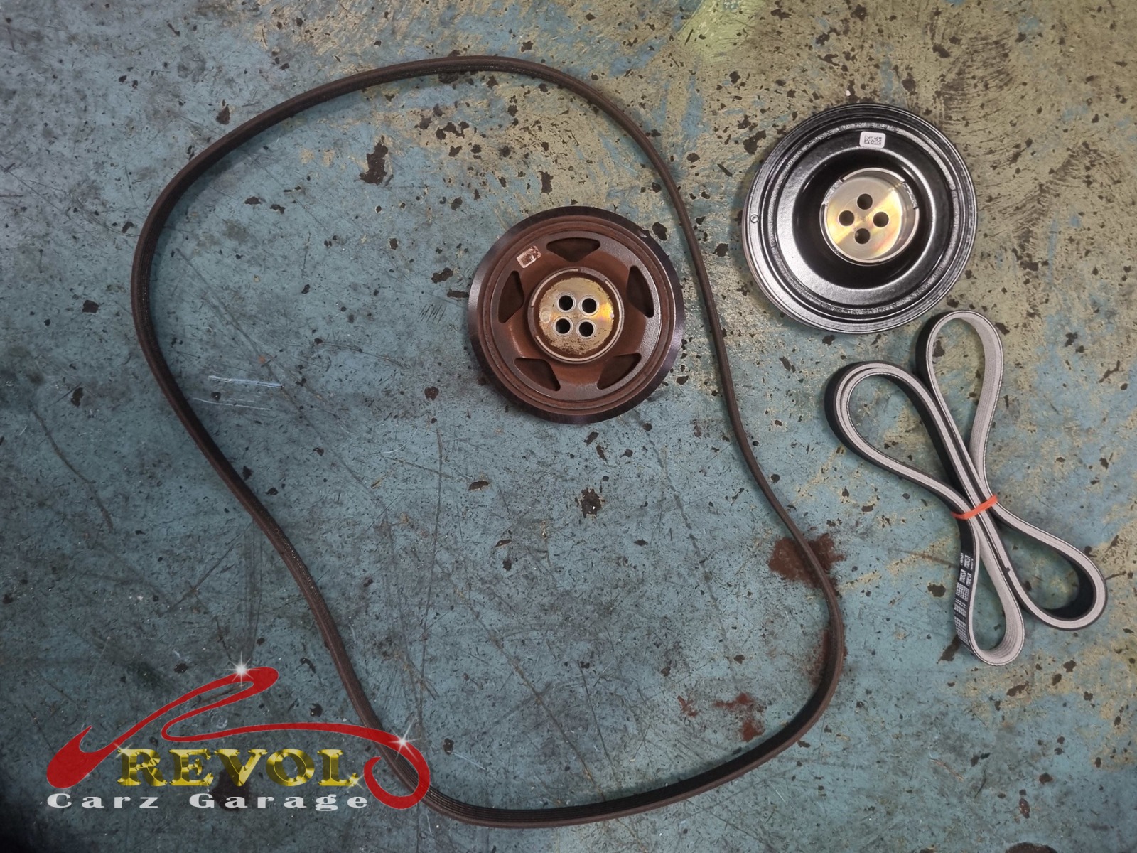

If you’re noticing rattling or squeaking sounds coming from the Bonnet, it may point to a failing Timing Pulley or Fan Belt.
These components are essential to the engine’s rotation system, and when they wear out, you may experience issues such as rough idling, misfires, or sluggish acceleration.
A faulty Timing Pulley can throw off the Timing Belt, while a worn or loose Fan Belt can disrupt the operation of vital parts like the Alternator or Air conditioning.
At Revol Carz Garage, our skilled Technicians are experienced in diagnosing and repairing Timing Pulley and Fan Belt problems. If your car is showing signs of unusual noises or reduced performance, let us perform a detailed inspection. We’ll restore your engine’s timing system to proper working order, preventing bigger issues and keeping your car running at its best.
The Owner of a BMW 216D sought assistance at Revol Carz Garage after detecting a rattling sound while accelerating.
To identify the source of the issue, our BMW Specialist lifted the vehicle and inspected it thoroughly.
The source of the rattling noise was traced to a misaligned Timing Pulley combined with a slipping Fan Belt.
By fitting a new Timing Pulley and Fan Belt Set, the rattling noise was eliminated, and the engine’s synchronization was fully restored.

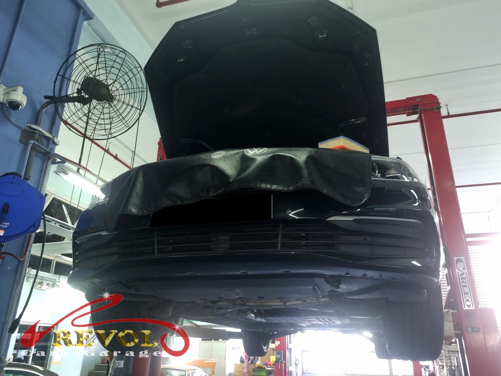

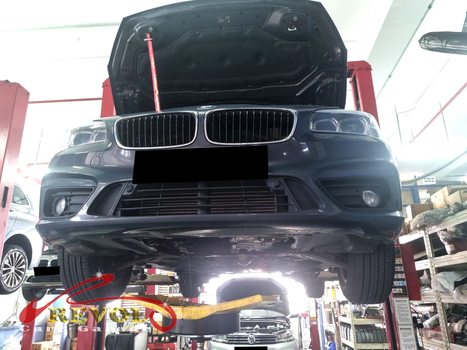

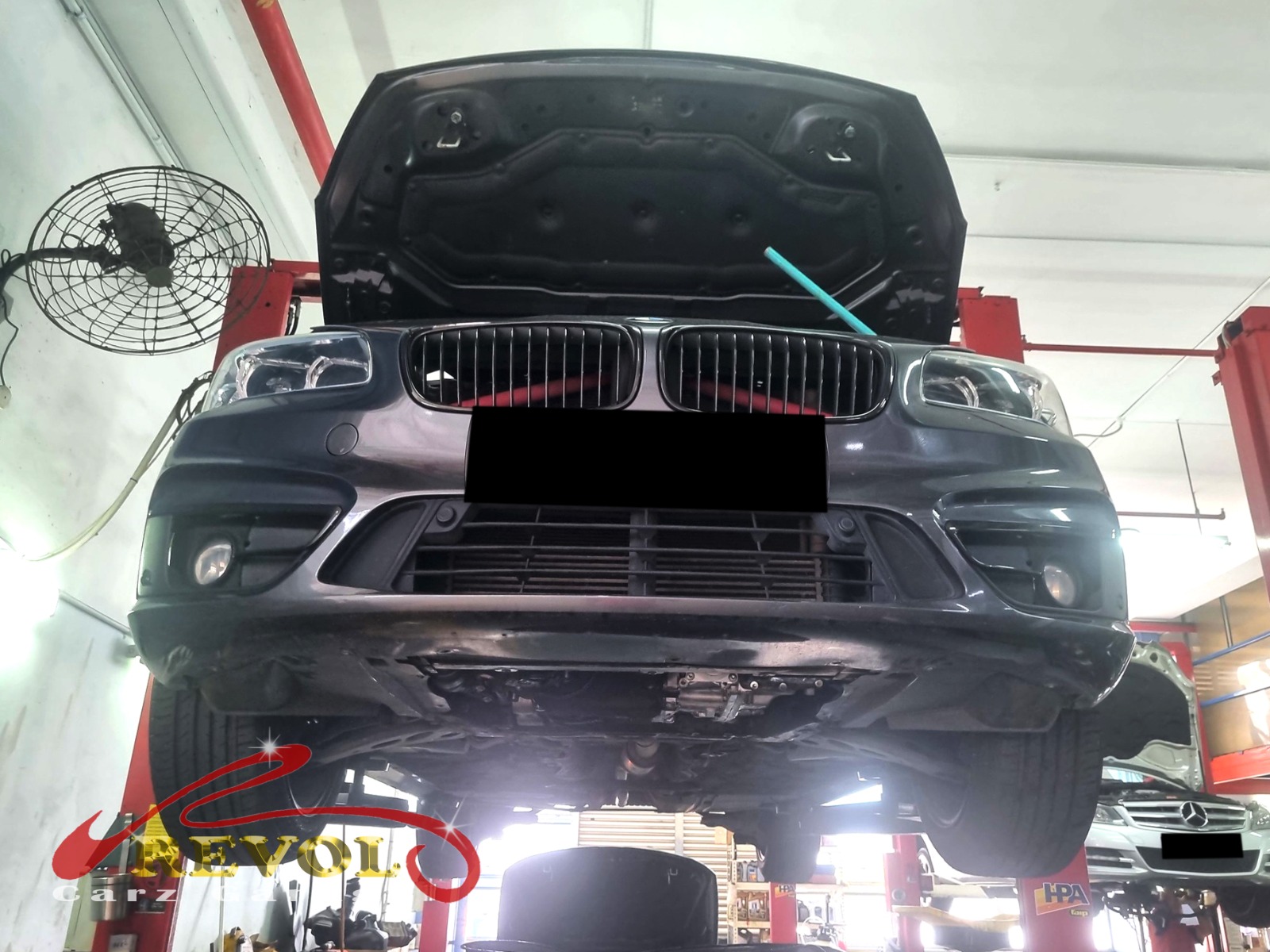

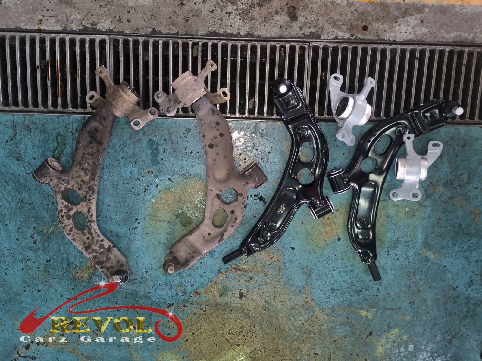

Feeling your steering pull, hearing clunks, or noticing unusual noises from the front of your car?
These can be signs that your Front Lower Control Arms are cracked or leaking. When these components are worn, your vehicle’s handling, alignment, and stability can suffer, and uneven tire wear can become a real concern.
At Revol Carz Garage, our skilled Technicians inspect your suspension system thoroughly, pinpoint the problem, and restore smooth, safe handling. Don’t wait for a small issue to turn into a bigger one—bring your car in and drive with confidence again.

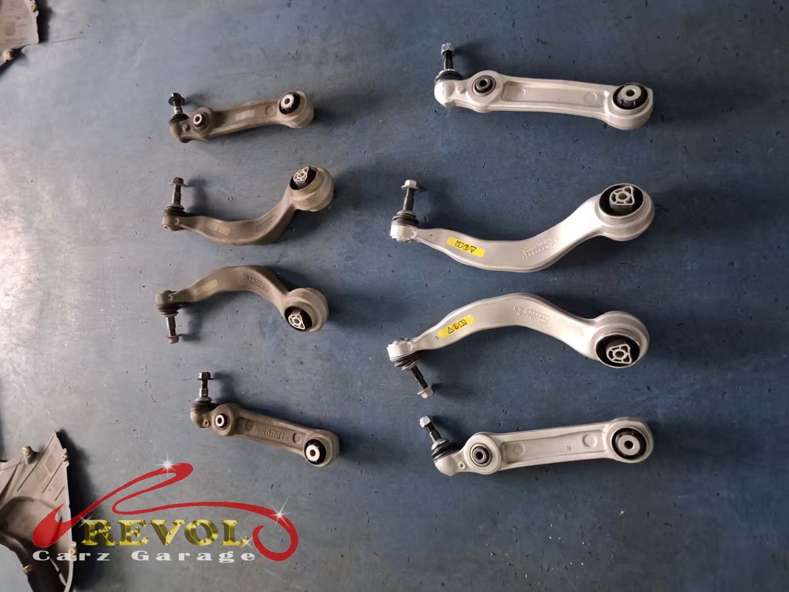

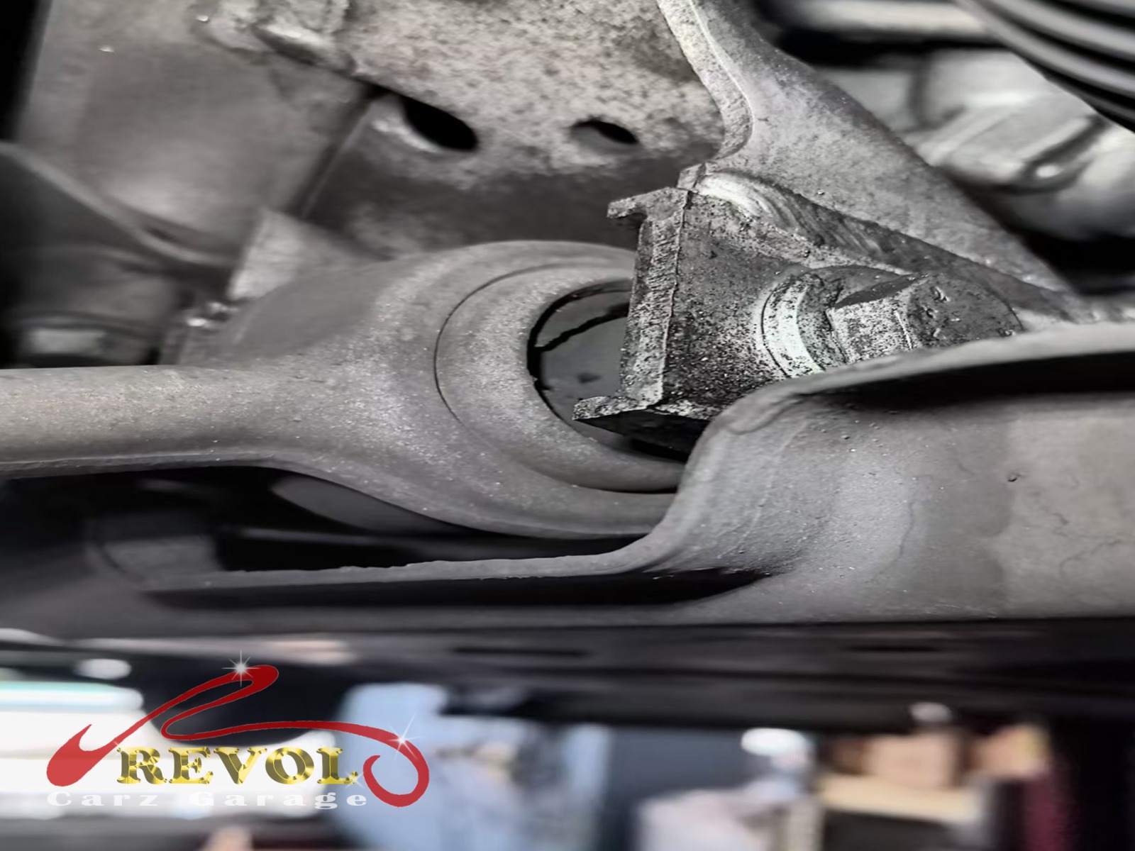

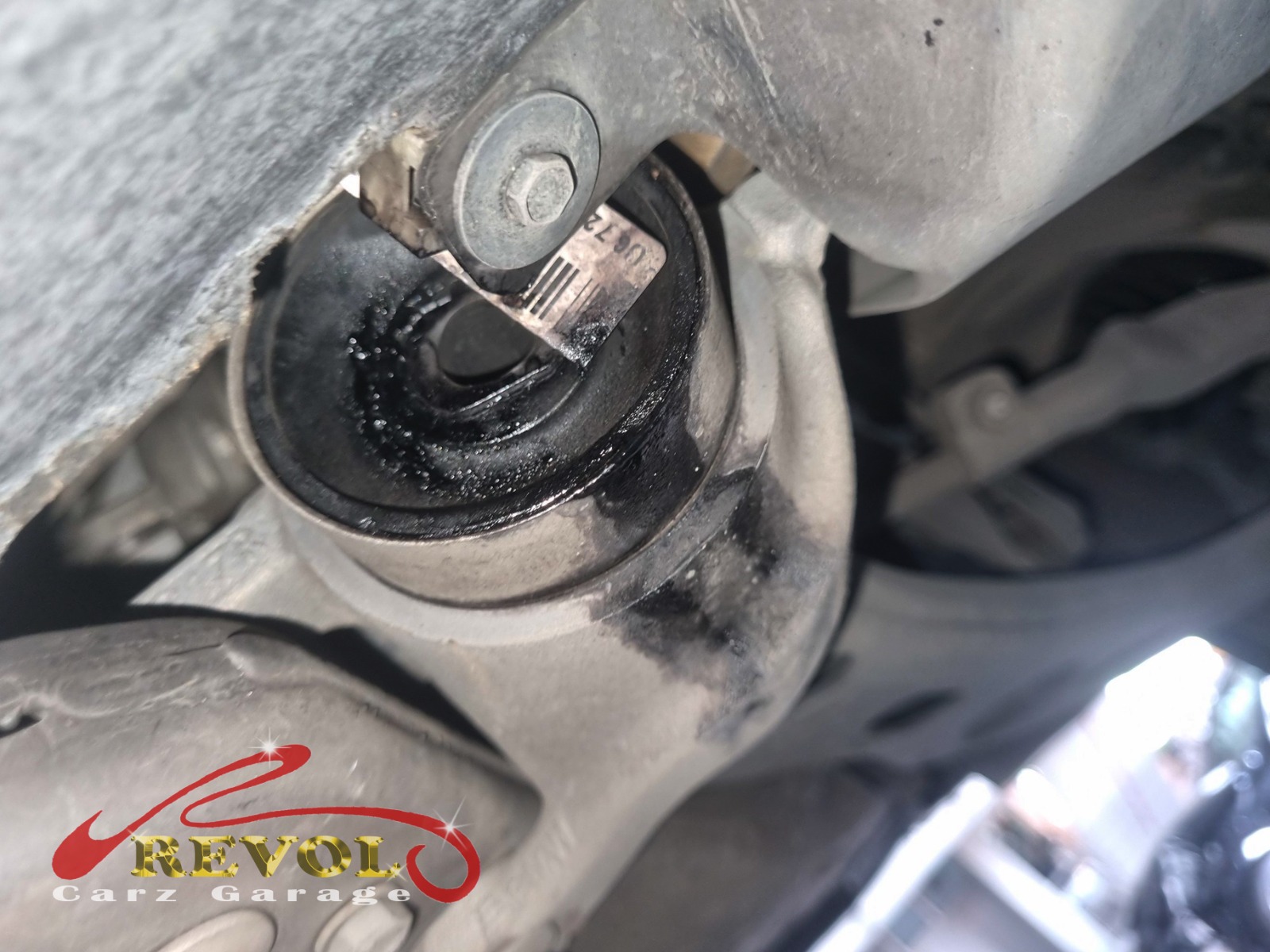

The BMW 216D Owner sought assistance at Revol Carz Garage after hearing clunking sounds when driving.
Our BMW Specialist lifted the vehicle for a detailed inspection to identify any underlying issues.
The Front Lower Control Arms were found to have cracks and a fluid leak, causing the issuses and requiring immediate replacement for optimal safety and performance.
The Front Lower Control Arms were replaced with new ones to improve handling, reduce noise, enhance stability, and restore overall vehicle performance.

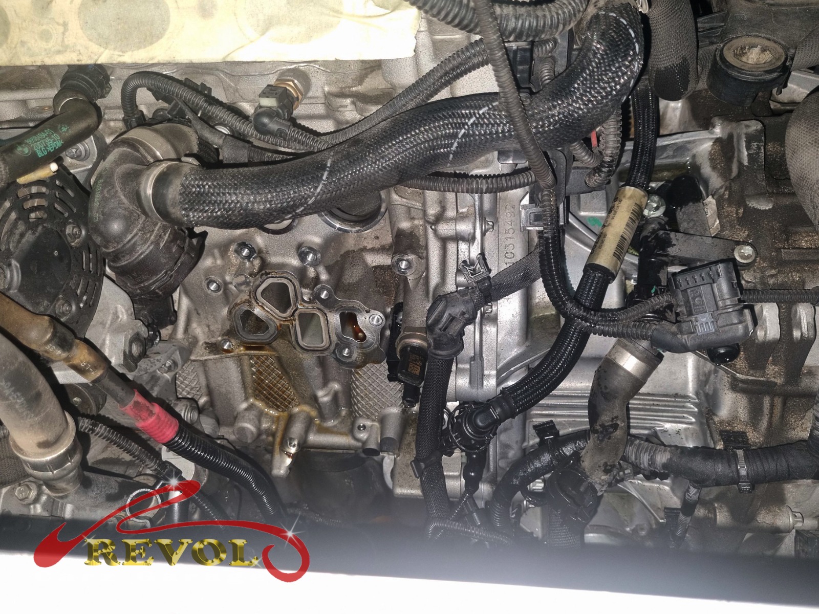

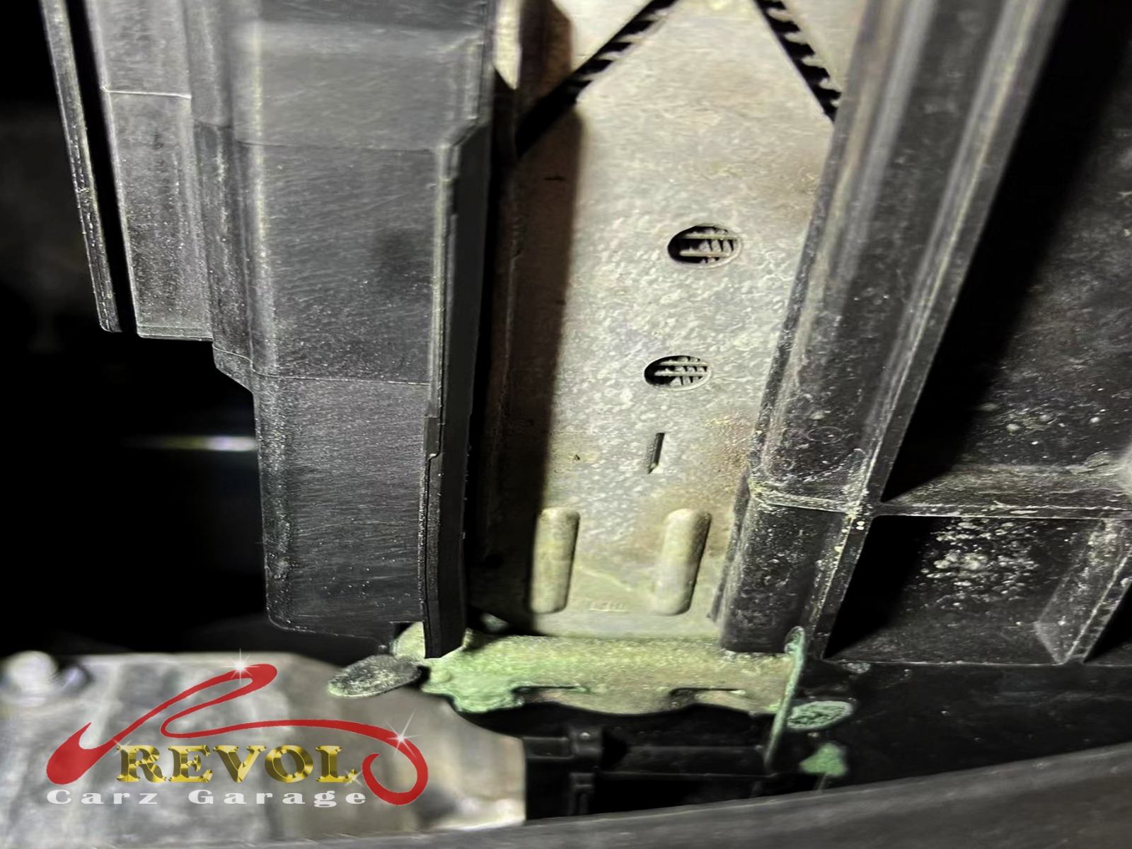

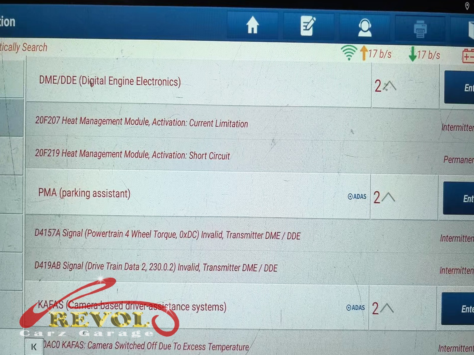

Is your engine running hotter than usual or showing the warning light?
Even if you don’t see a coolant leak, a failing Thermostat could be the culprit. Ignoring it can lead to serious engine or cooling system damage — but catching it early makes all the difference.
At Revol Carz Garage, our skilled Technicians will quickly check your Thermostat and replace it if needed, keeping your engine running cool, smooth, and reliably. Stay worry-free on the road with a properly maintained engine.

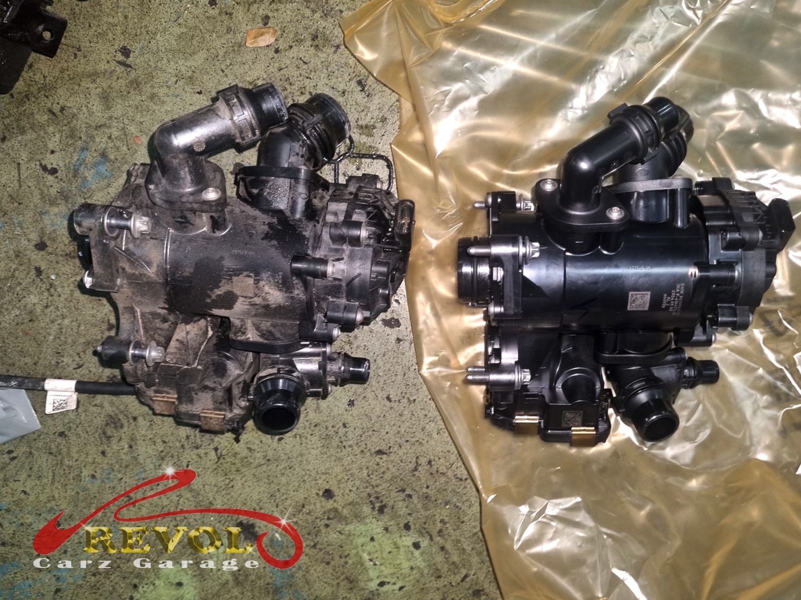

The Owner of a BMW 216i sought assistance at Revol Carz Garage after the engine warning light appeared.
The diagnostic revealed that the engine warning light had been activated by a malfunctioning Thermostat, likely due to a defect.
Dismantling the old parts to get to the faulty Thermostat — repair in progress!
A new Thermostat was installed to restore optimal engine temperature control, prevent overheating, and maintain overall engine health.

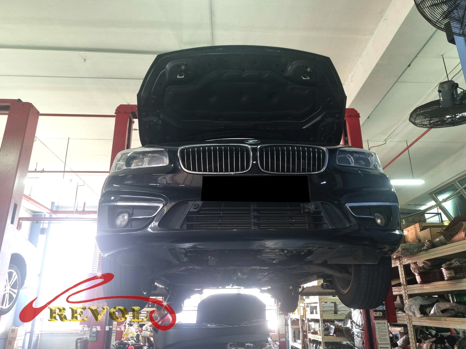

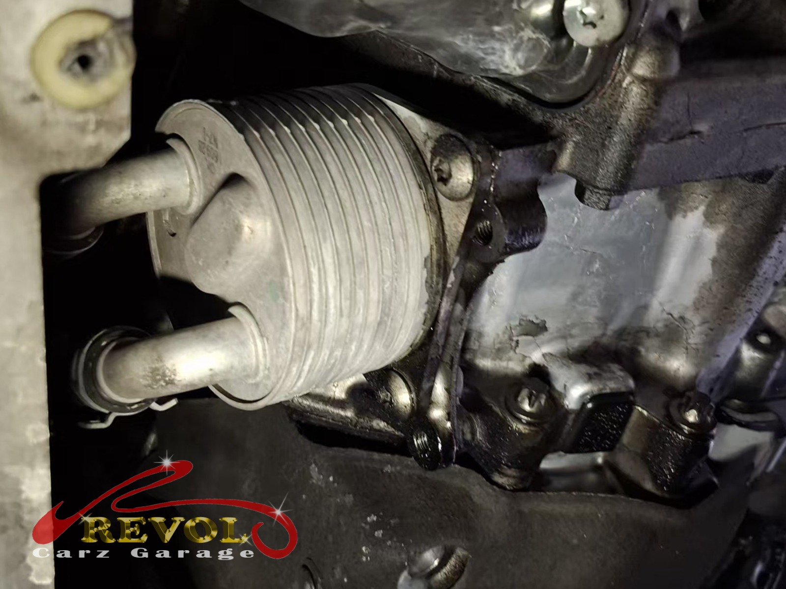

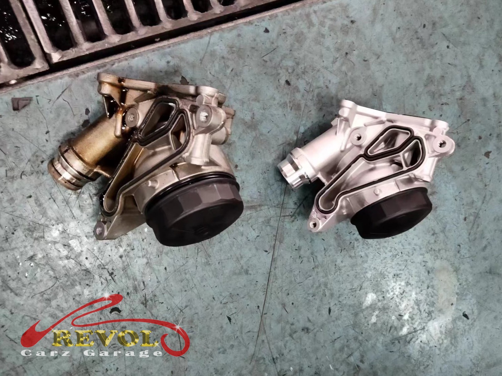

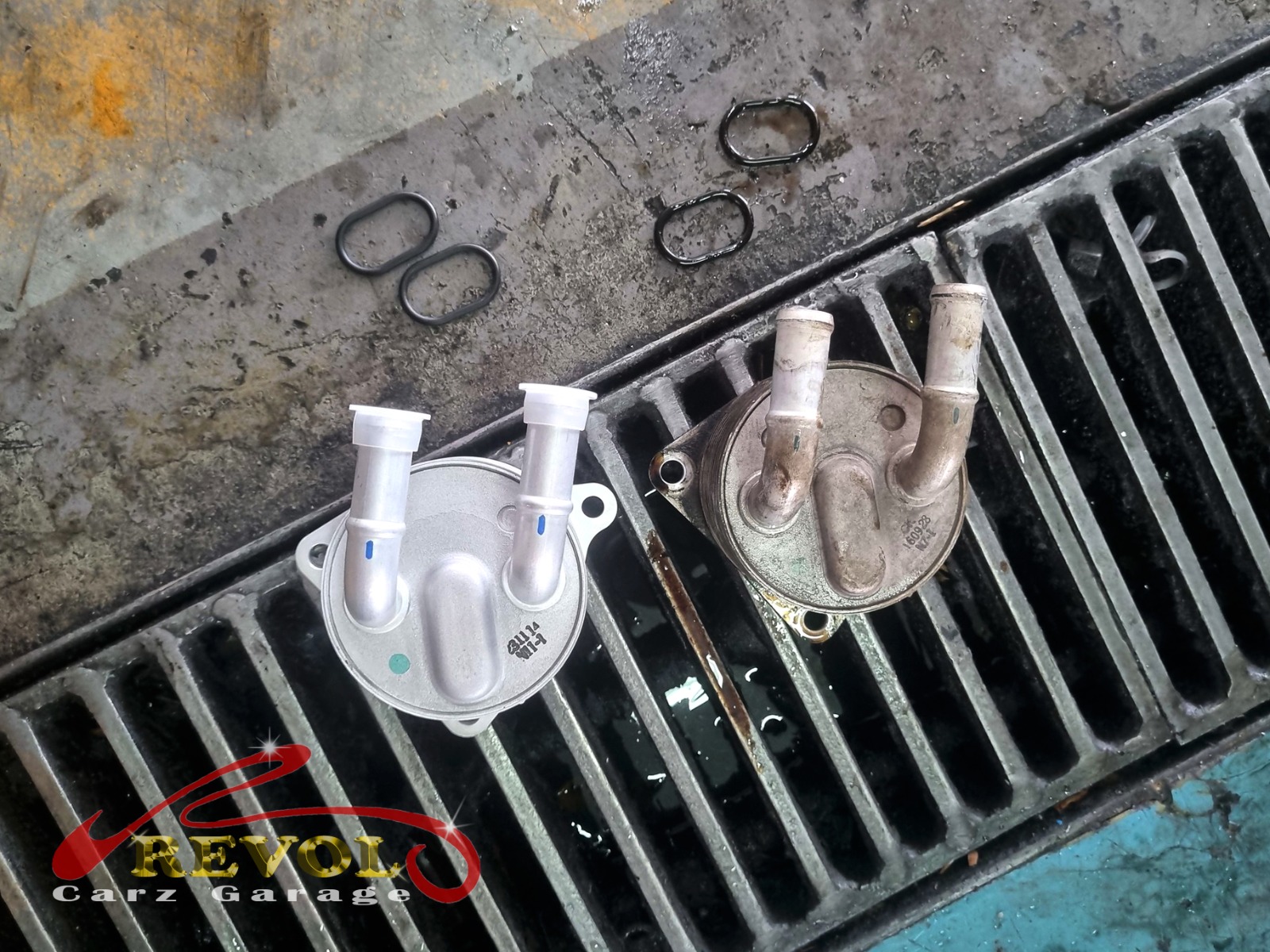

If you’re noticing oil spots under your car, a burnt oil smell, or a low oil pressure warning light, these could be signs of a leaking Engine Oil Cooler.
This vital component regulates your engine oil temperature to ensure proper lubrication. When it leaks, vital oil is lost—leading to poor lubrication, overheating, and even severe engine damage.
At Revol Carz Garage, we’ll thoroughly inspect your Oil Cooler and surrounding parts to identify the source of the leak. If needed, our Technicians will replace faulty components with premium-quality parts, restoring your engine’s oil system and keeping your car running smoothly and reliably.
The Owner of a BMW 216i visited Revol Carz Garage after noticing the engine overheat warning light.
Our BMW Technician carefully lifted the vehicle to conduct a thorough inspection.
Our inspection revealed that the Engine Oil Cooler was leaking, leading to a loss of oil and causing the engine to overheat.
To prevent overheating and maintain efficient lubrication, the leaking Engine Oil cColer was replaced with a new, high-quality component.

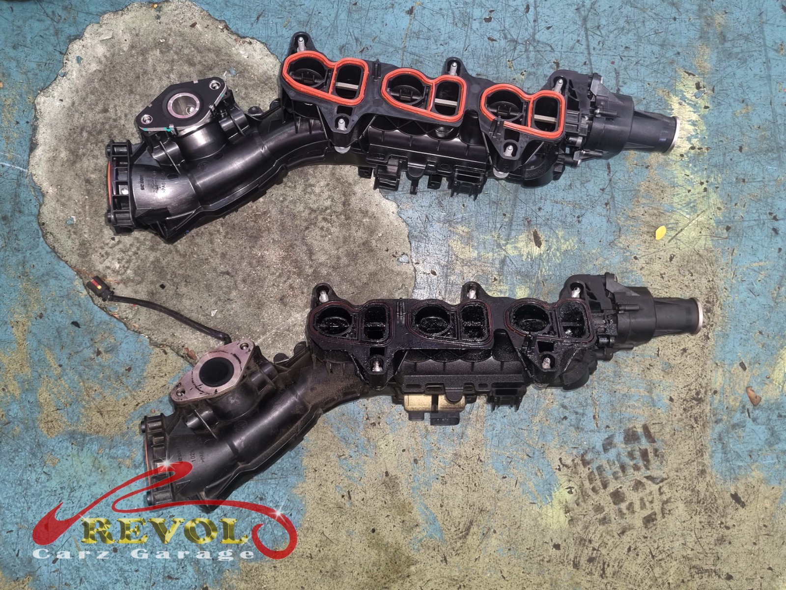

If you're noticing a decrease in engine performance, such as rough idling, poor acceleration, or an increase in fuel consumption, and engine check light appear, it could be a sign of a worn Intake Manifold.
A damaged Intake Manifold may lead to air or vacuum leaks, affecting the air-fuel mixture and causing poor engine efficiency.
At Revol Carz Garage, our Team specializes in diagnosing and repairing intake manifold issues. We will thoroughly inspect your vehicle to ensure that your Intake Manifold is functioning properly and restore optimal engine performance, keeping your car running smoothly and efficiently.

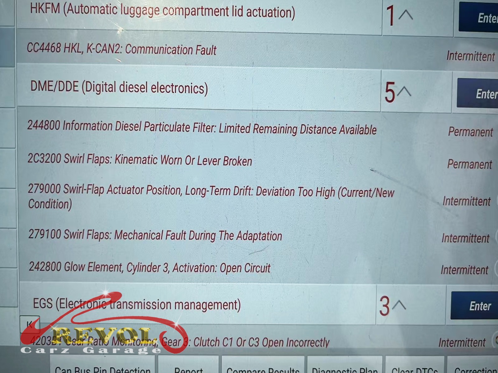

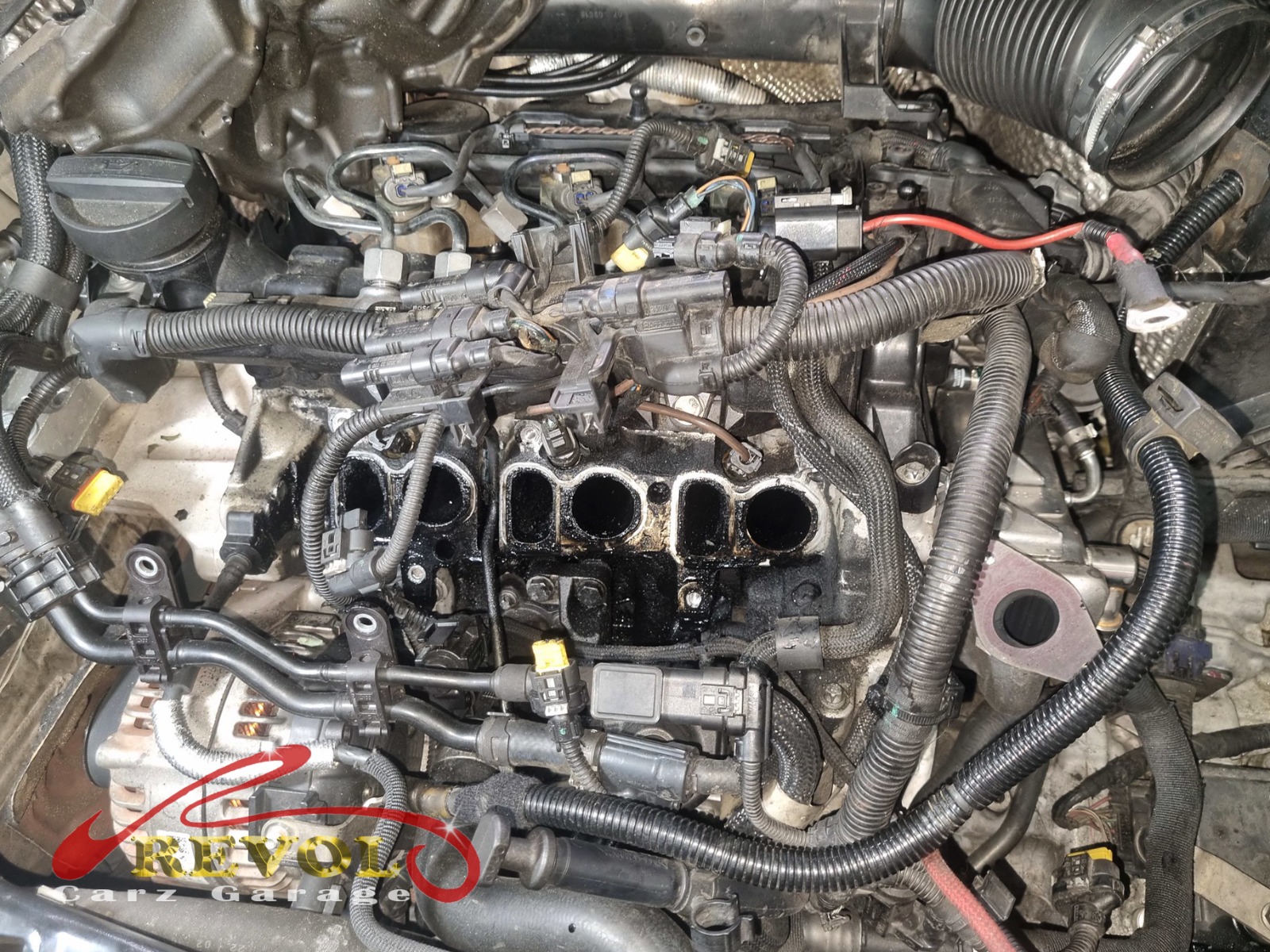

The BMW 216D Owner sought assistance at Revol Carz Garage after the engine light illuminated and the vehicle experienced a decrease in engine performance.
Our BMW Specialists performed a computerized diagnosis and identified a fault code for the swirl flap, caused by a worn Intake Manifold.
The Intake Manifold was dismantled, and carbon deposits in the intake ports were found to be restricting airflow, reducing engine performance, and potentially triggering the check engine light.
Replacing the Intake Manifold ensures optimal airflow to the engine, preventing issues like misfires, reduced power, and poor fuel economy.

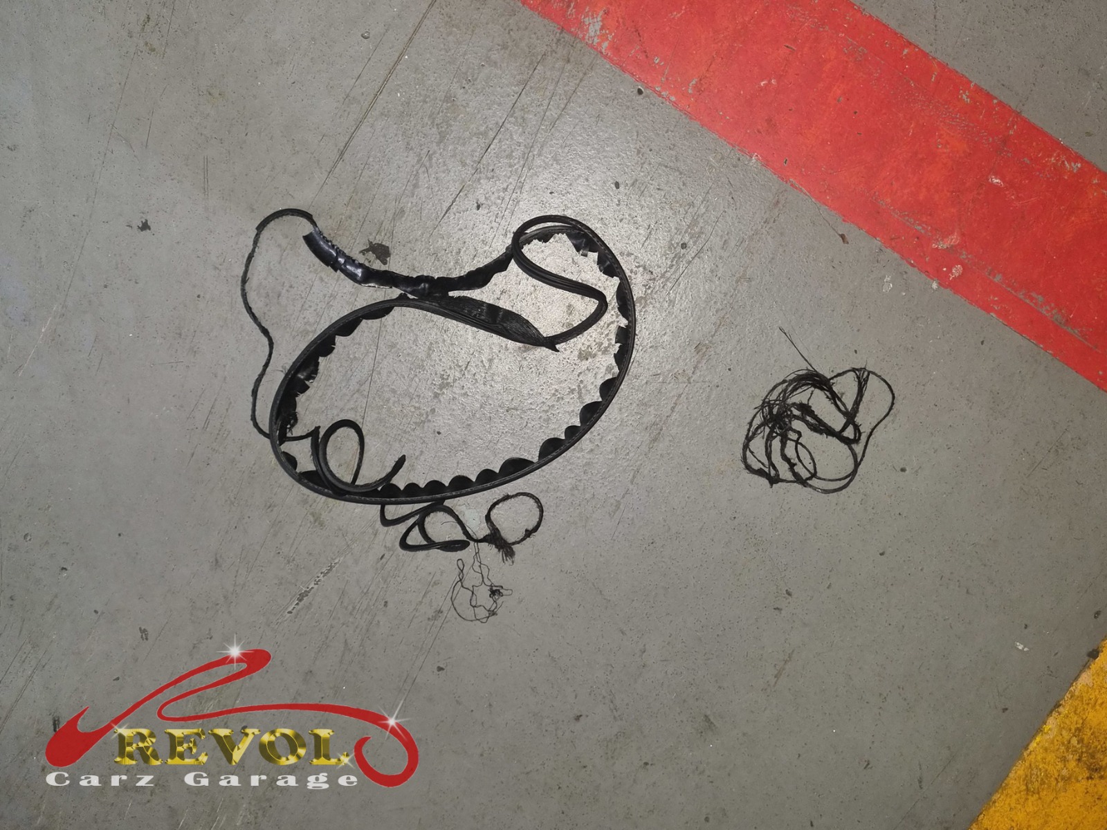

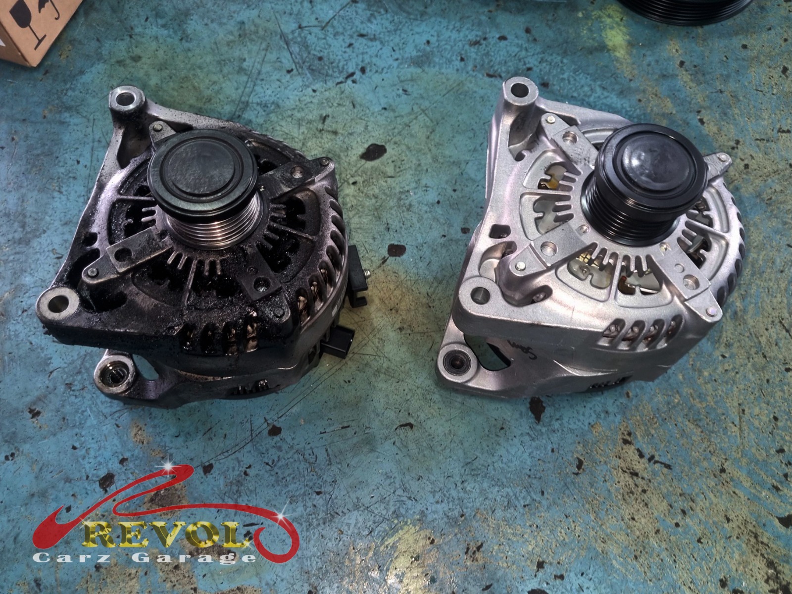

The Owner of a BMW 520i visited Revol Carz Garage after experiencing unexpected engine stalling.
Inspection confirmed that the sunken Alternator Pulley led to Fan Belt failure and subsequent engine stalling.
Our skilled BMW Technicians also discovered that other related components were worn and required attention.
Installing a replacement Alternator ensures your vehicle runs reliably and eliminates risks of unexpected engine stalling.
Installing a new Fan Belt restores the drive system and safeguards the engine from potential failures.

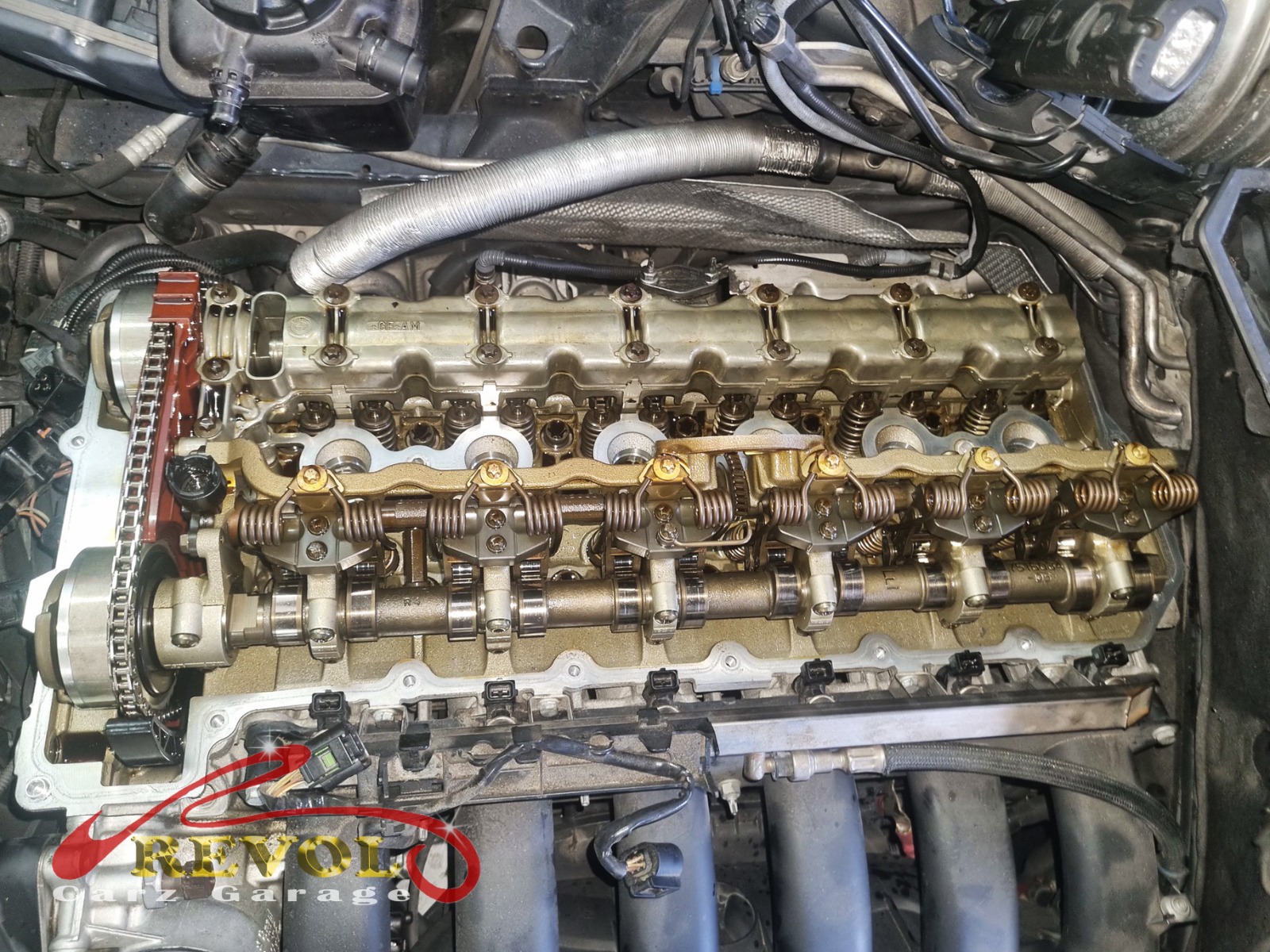

If you’re seeing oil spots under your car, smelling burning oil, noticing smoke from the engine bay or exhaust, or experiencing rough idling and occasional misfires, your vehicle may have a Valve Cover leak.
Don’t wait—bring it to Revol Carz Garage, where our experts can quickly diagnose and repair the issue to keep your engine running safely and efficiently.

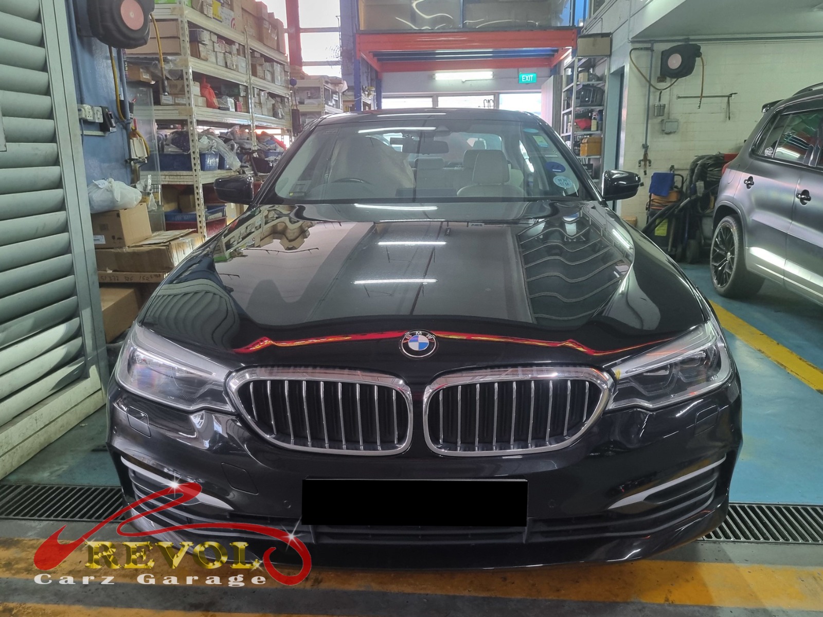

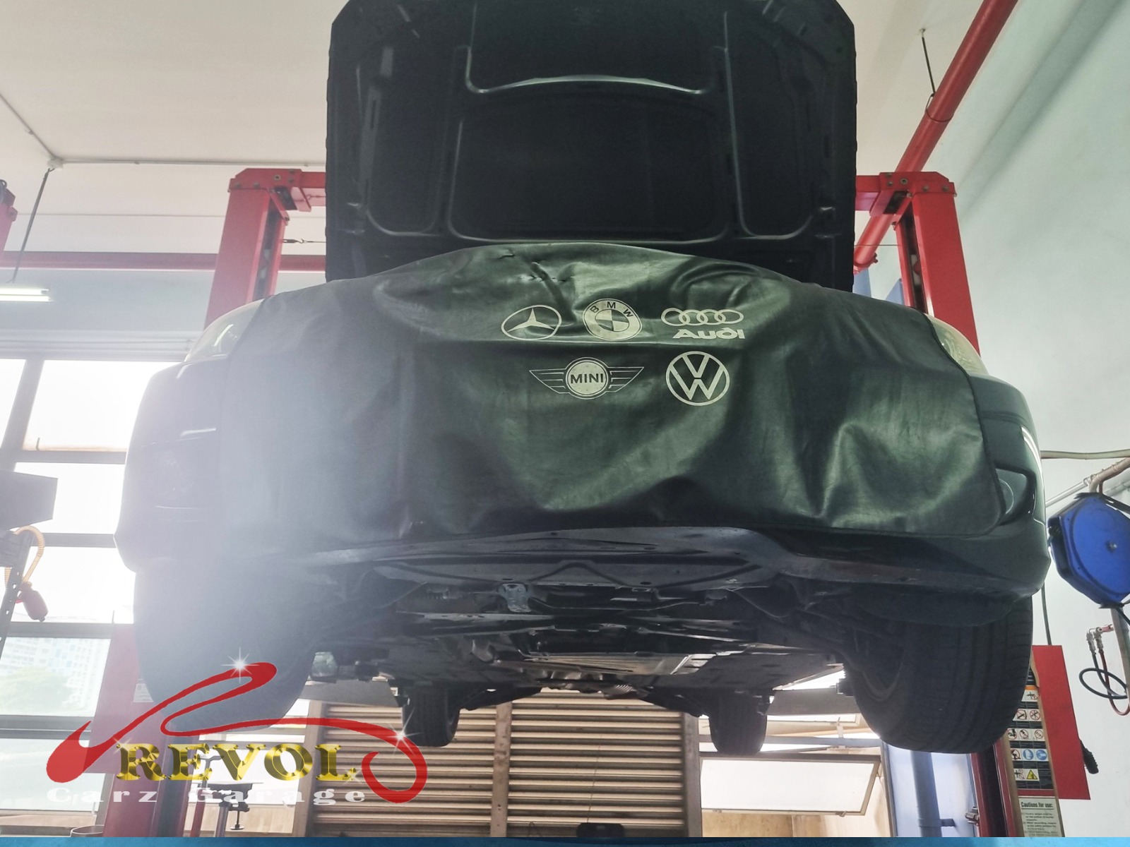

The Owner of a BMW 530i visited Revol Carz Garage after noticing a burning oil smell while driving.
Our BMW Specialist determined that the Valve Cover leak was allowing oil to reach the hot engine, causing the odor.
To properly address the issue and carry out thorough maintenance, removal of the Valve Cover was necessary.
Replaced a new Valve Cover resolved the leak, eliminated the burning odor, and ensured the engine runs safely and efficiently.

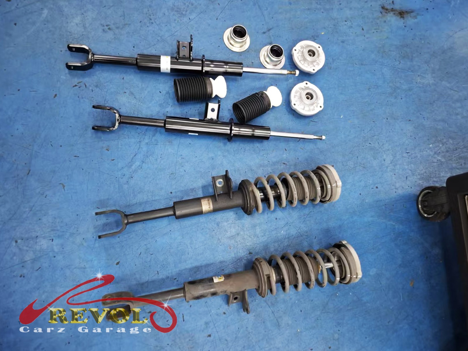

If you’re experiencing excessive bouncing over bumps, shows oil around the Front Absorber, or makes knocking sounds, it’s likely that your Front Shock Absorbers are worn and no longer providing proper damping.
You might also notice the front dipping when braking, which can affect stability and increase stopping distance. Steering instability, poor handling, and unusual noises are additional signs that your suspension system needs attention.
At Revol Carz Garage, we specialize in inspecting and servicing suspension systems to restore smooth ride comfort, precise handling, and overall safety. Addressing these issues early ensures your BMW drives the way it was meant to—stable, comfortable, and reliable.
The Owner of a BMW 520i sought assistance at Revol Carz Garage due to excessive bouncing and knocking noises while driving.
Our BMW Expert Technician hoisted the vehicle for a thorough inspection of the undercarriage components.
The Front Absorber was worn and leaking oil, which caused excessive bouncing and knocking noises.
A new Front Shock Absorber set was installed to reduce noise, improve ride comfort, and enhance vehicle stability.

If you’re noticing oil leaking from a worn Oil Filter Housing, it’s important to act quickly to protect your engine from overheating. Common signs include oil puddles under the vehicle, visible oil stains around the Filter Housing and engine, or low oil levels.
If you notice any of these symptoms, schedule a detailed inspection at Revol Carz Garage. Our skilled Technicians will accurately diagnose the issue and carry out the necessary repairs, keeping your vehicle reliable, efficient, and performing at its best.
The BMW 520i Owner visited Revol Carz Garage after noticing an engine oil leak and needing to top up oil frequently.
Our BMW Specialist promptly hoisted the car for a comprehensive inspection to identify the source of the oil leak.
Pinpointed the Oil Filter Housing as the root cause of the engine oil leak.
Installing a new Oil Filter Housing is crucial to stop leaks and maintain optimal engine performance.

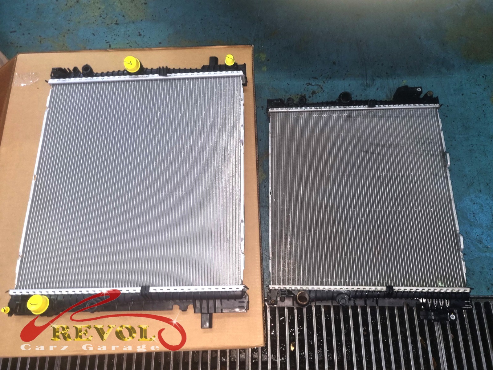

Noticing mysterious puddles under your car or low coolant levels?
Your Radiator may be leaking. Even a small leak can affect engine cooling and, if left unchecked, cause serious damage.
At Revol Carz Garage, our skilled Technicians diagnose and repair radiator leaks promptly, keeping your car running smoothly and protecting it from costly repairs. Reliable service, peace of mind guaranteed.
The BMW X3 Owner visited Revol Carz Garage after noticing coolant leaks and unusually high engine temperatures, seeking expert assistance.
Our BMW Specialists lifted the vehicle and conducted a thorough inspection of the cooling system.
Identified that a worn Radiator was behind the coolant leak and recommended immediate replacement.
Replacing the Radiator guarantees proper cooling system function, protects against leaks and overheating, and ensures reliable engine performance.

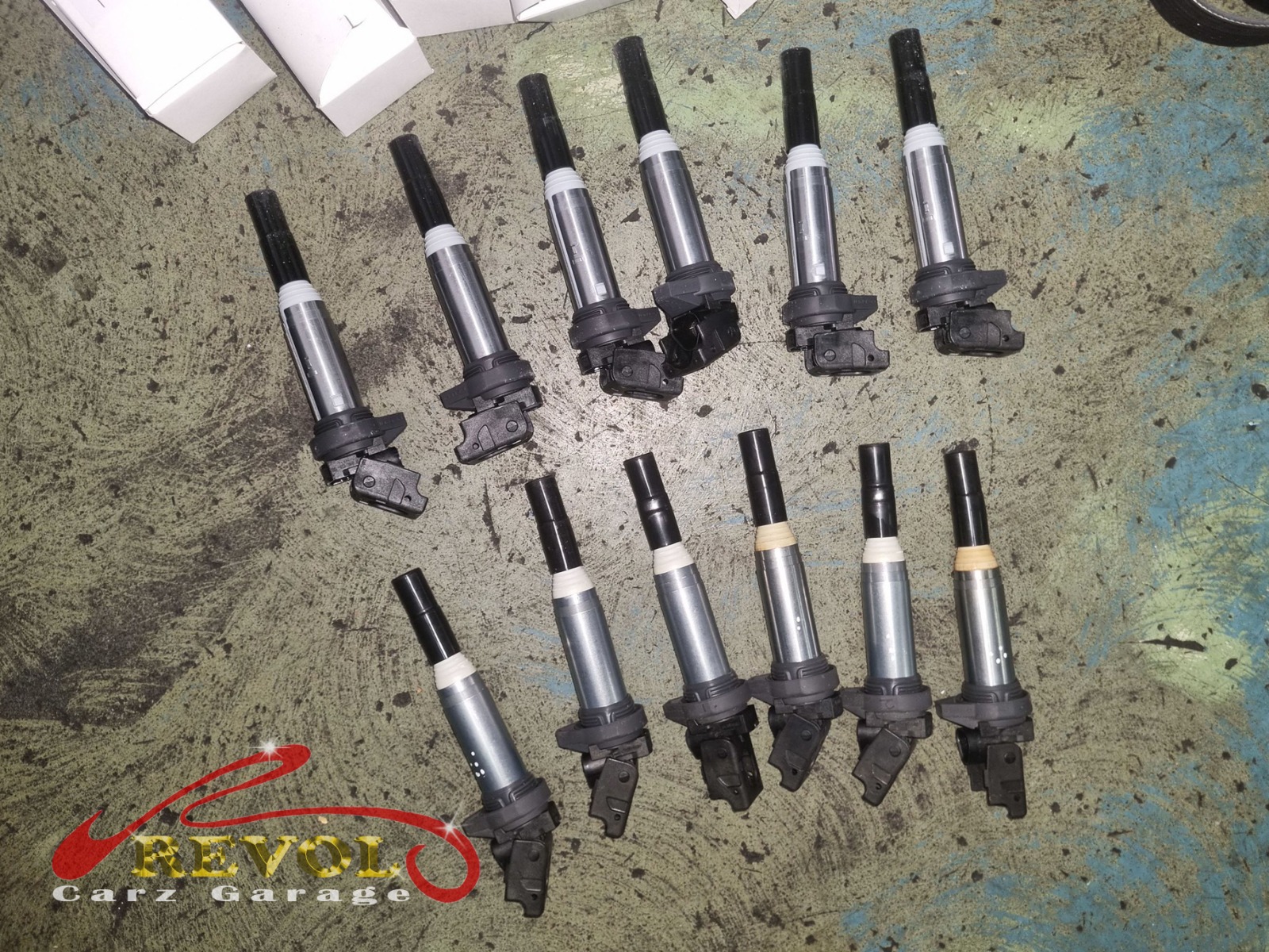

If you’re experiencing rough idling, misfires, reduced acceleration, an illuminated check engine light, or decreased fuel efficiency in your BMW—especially around 120,000 kilometers—it’s important to address these issues promptly, as they may indicate worn or failing Ignition Coils.
For a thorough diagnosis and effective repair, bring your BMW to Revol Carz Garage. Our skilled Technicians will accurately identify the problem, replace faulty Ignition Coils, and ensure your vehicle performs at its best.
The BMW 640i Owner visited Revol Carz Garage for an oil change and reported experiencing rough idling.
Our BMW Experts hoisted the vehicle to perform an oil change and conduct a thorough inspection.
Timely replacement of the Ignition Coil helps avoid engine rough idling and ensures smooth engine performance.

Are you hearing clunks over bumps, feeling vibrations in the steering wheel, noticing poor steering response, or seeing uneven tire wear?
These could all be signs that your Lower Arms or Control Arms are worn or cracked. These critical suspension components play a key role in your vehicle’s handling and safety, and ignoring them can lead to reduced performance or even dangerous driving conditions. Steering wheel vibrations, especially at high speeds, and visible damage like rust or bends are warning signs for your suspension.
At Revol Carz Garage, our regular inspections and maintenance help prevent damage, maintain smooth driving, and prolong the life of your suspension.
The Owner of the BMW 318i visited Revol Carz Garage after detecting vibrations in the steering wheel and clunking noises while driving.
The undercarriage components were carefully inspected by our BMW Expert to ensure everything was in proper condition.
Worn and cracked undercarriage arms were identified as the cause of the steering and appear noises.
The replacement of the Lower and Control Arms improve handling, eliminate suspension noises, and safeguard other parts of the suspension system.

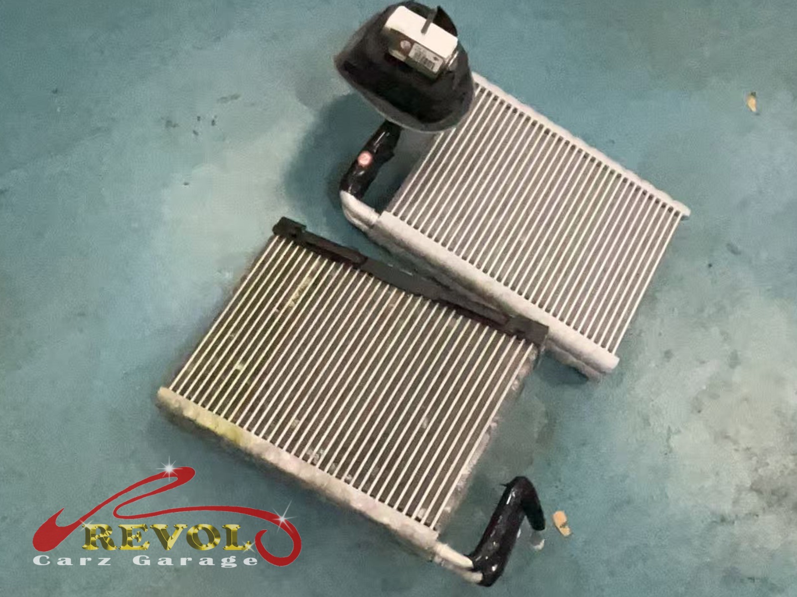

If you’re experiencing weak airflow, musty odors, or moisture buildup inside your vehicle, it may indicate that your Air-conditioning system is clogged with dirt or has developed leaks—often due to issues with the Aircon Cooling Coil. These problems can significantly reduce cooling performance.
To keep your Air conditioning system working at its best, bring your car to Revol Carz Garage. Our skilled Technicians will thoroughly inspect and service the cooling coil, restoring optimal cooling efficiency and ensuring a comfortable ride every time.

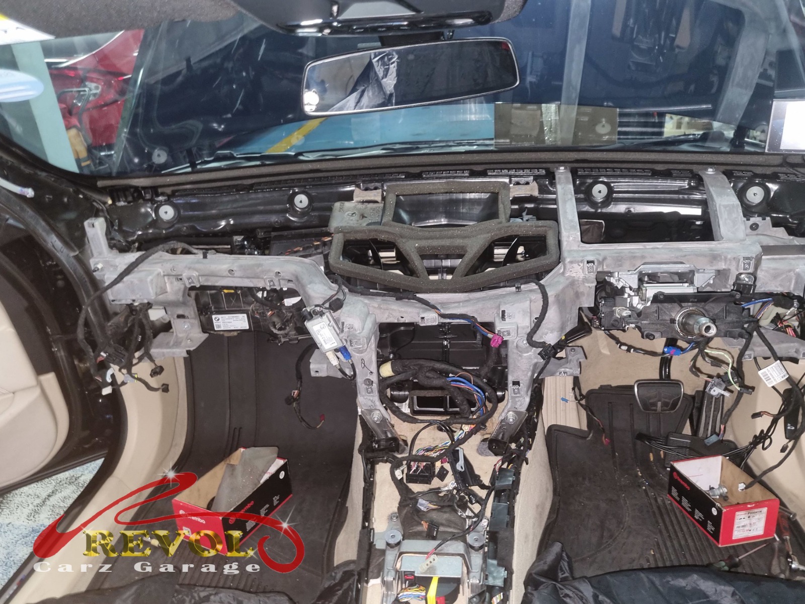

The Owner of a BMW 520I visited Revol Carz Garage after noticing that the air conditioning was blowing warn and got musty odors.
Our BMW Specialists identified a worn cooling coil and removed the dashboard to install a new one efficiently and accurately.
Installed a new Air conditioning Cooling Coil to fix warm air issues and restore optimal cooling performance.
Completed the Cooling Coil replacement and reassembled the dashboard, ensuring all panel functions work perfectly.
