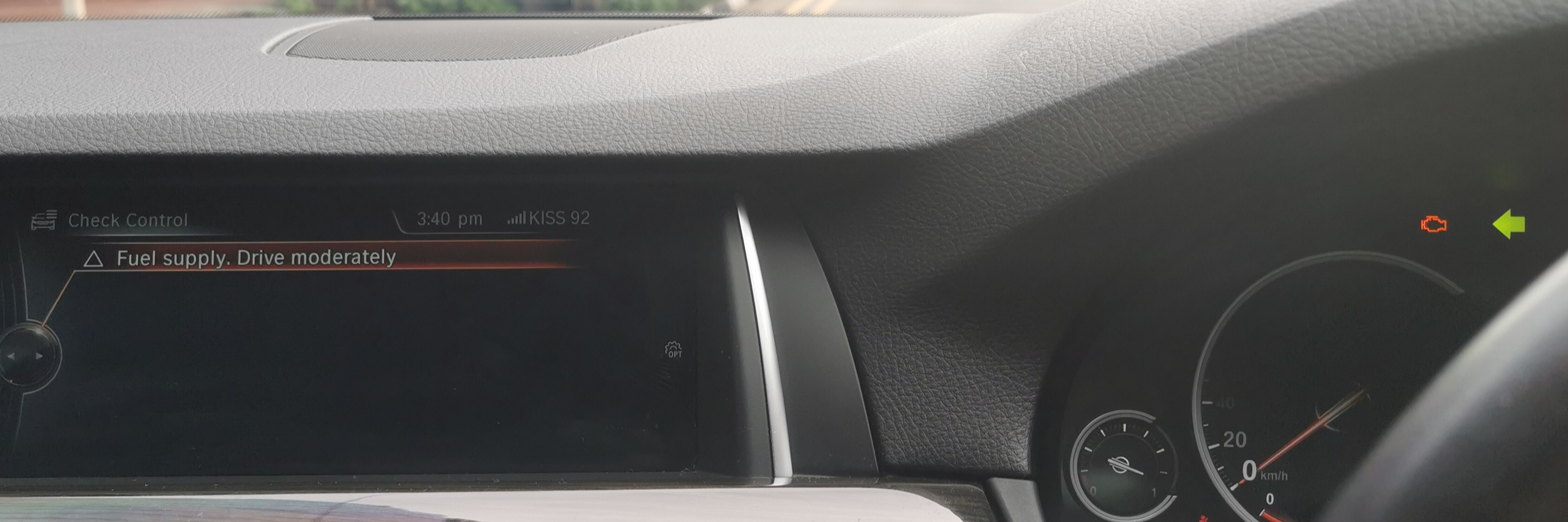

Was driving haft way , Suddenly the car engine just die off . Unable to start the cars and the engine check light pop out . Call the toll truck to the workshop about an hour later. It happen to start up again like normal at the workshop.. Anyone happen before ?

Either of the fuel pumps or pump relay ?
After changing fuel pump control module , front high pressure fuel pump , fuel tank pump ... Next issue happen .. O2 Sensor.. Engine check light pop out while driving slow .. there is no misfiring and rocky idling...
