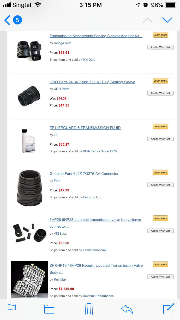

I don’t know the mileage but usually every 40,000km will change transmission fluid atf and atf filter at 80,000km
Also will replace the mechantronics sealing sleeve to Ensure hydraulic pressure in the transmission is maintained.
I don’t believe the lifetime fluids bull that will last forever.
Here is an example of the sleeve for 6 speed zf gearbox use by Bmw. Yours maybe 8 speed. Go to a bmw shop and have this done.
If it does not fix your
... If it does not fix your drivetrain error at least it will ensure the maintenance care of your expensive transmission and gearbox life.
