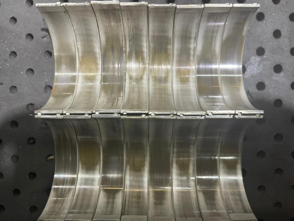

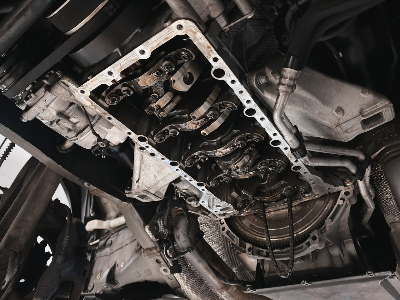

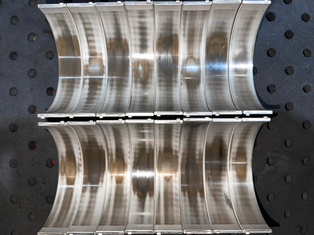

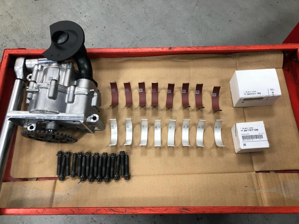

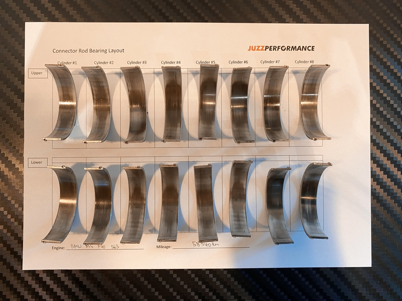

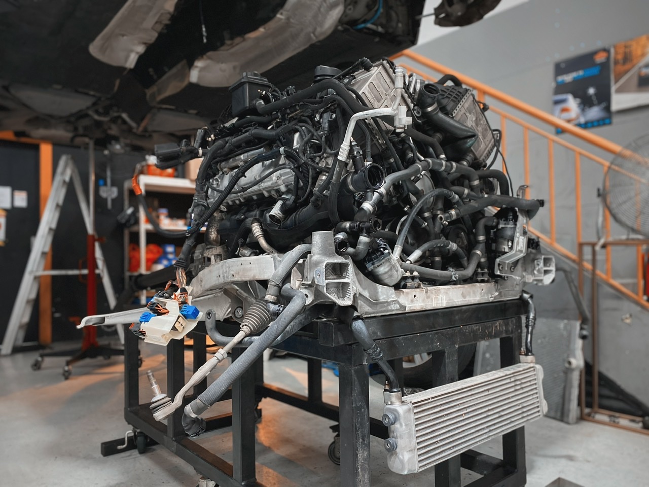

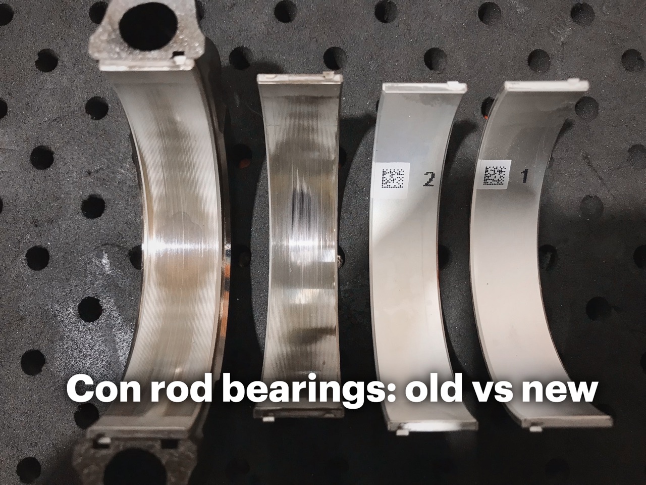

Connector rod bearings done for F10 M5, Mileage 86082km.

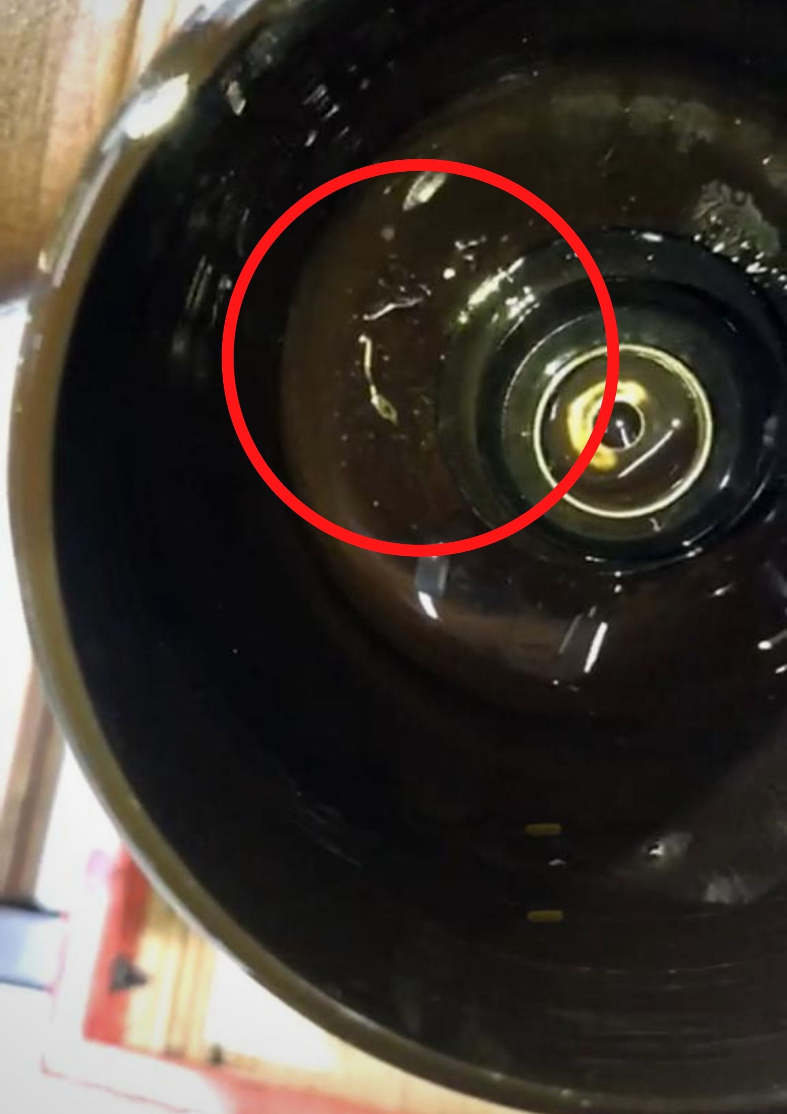

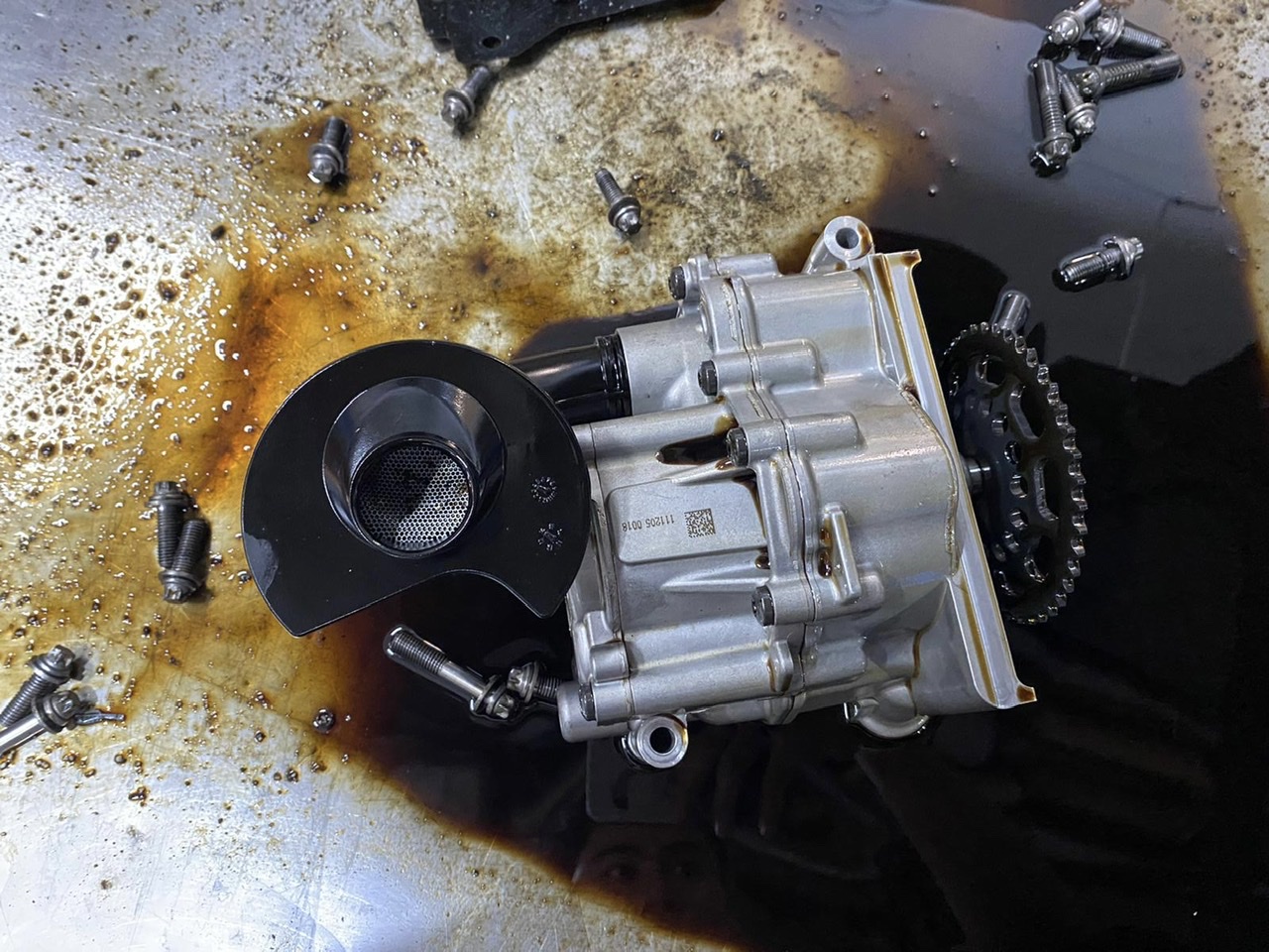

While conducting regular engine oil service, our team noticed metal chips at the oil filter. These metal chips is a tell-tale sign that your connector rod bearings are wearing out. Connector rod bearings is a deadly & serious issue where it may cause the engine to jam, when it is worn. We recommend to replace the engine oil pump as well as the metal residue is stuck within the engine oil pump & problem may still persist. Photos attached are new connector rod bearings, new engine oil pump & connector rod bearing bolts.
