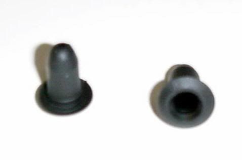

yea e46 and e90 emblem is the same,front is 82mm,back is 78mm,i think u should get a new pair of grommet for the"legs" of the emblem from the shop,a new grommet is more than capable of holding on to your new emblem even under moist condition. a picture of a grommet is attached in case you have no idea what it is.

eh...for grommets, u probably have to get from bmw agent.
anyway for your case, i suspect the emblem piece is still there, just the logo thingy came off rite cos thats common for alot of bmws. if thats the case, no need to change grommet
