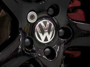

Anyone using this lock device ontheir expensive rims?
BMW E60 525i N52 3.0l > Wheels > Locks > ES#260952 "Euro Lock" Wheel Locks - 11805
