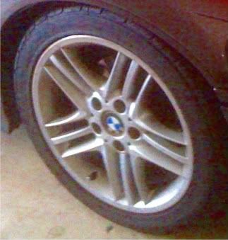

Re: Spacers
Here is a photo, sorry for poor quality
Its Federal 595 Steelmate tires
Re: Spacers
Assuming it is OEM, this is style 89, fits e36, 225/45R17 stock specs on Bridgestone or Michelin. You are running 40 aspect ratio, but should still be okay.
Go to your tyre shop and ask them to check the source of rubbing. I suspect it is the tyres, not the wheels. I have seen a Yoko rubs, but a CSC3 replacement (same specs) no rub.
