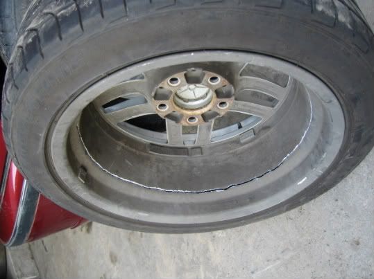

Was up in BOLEH land yesterday, received a friend's call telling me tht his rim was broken.. I rushed down to the workshop and this was the result!!!
It was used on a MB W211..
How it happen:
He was travellin at about 50km/h when he hit a stone..THIS was the result..
Lucky he wasnt on a highway...

WOW! If he was driving faster, the manage might have been very serious.
Re: risk of having REPLICA rims!!!
holy crap looks like it got opened with a can-opener!

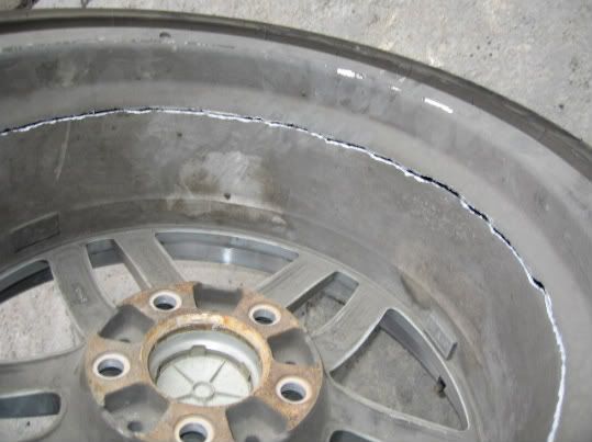

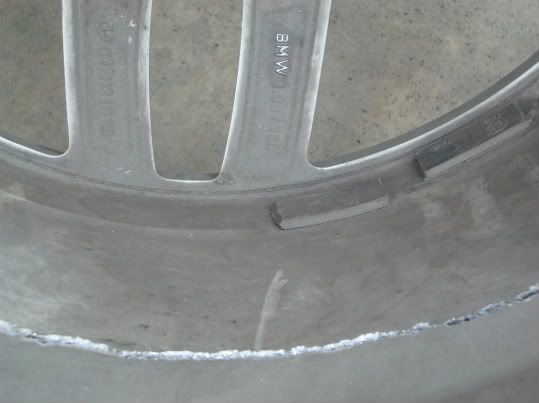

Look at the thickness of the wall. That's really thin!! Not surprising that it ripped open like a tin can.
With the aim of reducing weight there's so much you can do without reducing material thickness and volume.

anyway this is the result of compettion,high returned(cheap at cost) high risk.
but from the pciture look like some curbing on the rim lip,did the car hit any hole or skidded?
this could due to result of hitting the curb caused the rim to break like that.
or due to rim broken and hit th curb?
MY UNDERSTANDING that is also replica rim quality vary from diff factory
ANy way premium quality wheels undergone strict R&D will not result like this.
again you pay peanut you get monkey.
You go to Monkey shop you only need to pay peanut

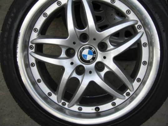

I DON'T AGREE THAT THIS CAN ONLY HAPPEN WITH REPLICA RIMS.
HERE ARE PICTURES OF MY 17IN RIMS WITH 235/45 TIRES. THOSE ARE VERY THICK TIRES.
TAKE NOTE OF THE BRAND!
yes fully agreed with you,but better quality will have lower risk become like this.
Buy the way this wheel was on which car ? 3/5/7 series?
Looks like original BM rim
