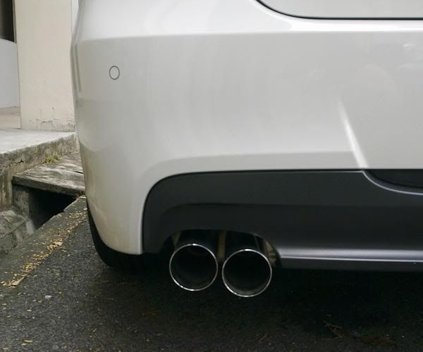

Re: performance exhaust for E90
i find the performance exhaust tip is pointing low, resulting a gap between the bumper.
please post your exhaust tip position from rear (close up & not so close up) :thumbsup:

I guess performance exhaust r like tat. Anyway, its better than b4 I do up e touch up.
I will try to upload some pics..
thanks for the picture.
the 'large' gap between exhaust tips and diffuser is the "obstacle" that stop me from committing performance exhaust for the vroom vroom sound
guess eisennman is the answer liao ... but too ex :(

Hi wt_know, dont mention..
Actually it looks alrite but have to custom weld e front left hanging point back. Gap all round are around 1 finger. Depend on how you view it lar.. :)
Reason why its lower is bcos the muffler box are larger than stock thus will push it down alittle. By pushing it upwards may not b advisable as it may / or cause the connection part (mid pipe to muffler box) area leak.
So far so good & Frankly speaking, its not as loud as wat most have claim. Or im too hardcore? Hee... :D :D :D

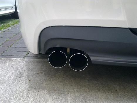

After some weeks of usage, backside itchy thus went to lift it up alittle.
Before backside itchy:
After its done:
FR: still not as loud as wat I thot but am loving e mid ~ high range. Very willing to go! (Was given a summon for speeding too :oops: ) Nice exhaust for those who do not wish to have a loud noise & attention seeking.
the lift-up is much better now making the tips proportionally positioned closer to the diffuser.
now i'm itchy ... haha
any shaking or vibration from the tips/muffler?

Hi wt_know, thanks.. :)
So far no shaking or vibration. I get FK to torch e front right hanger so tat it can be lifted up alittle & I also ask them to tie all 3nos hanging rubbers with cable tie to stop it from dropping any lower.. ( Thanks to wilman2772 for e tinker :) )
Do take note: need to weld the front left hanging point in order to have a balance for all hanging point. On & all, additional spending is $20.00 :yummie: besides the cost for the exhaust, installation, transfer & inspection. Sibei wu hua mod! (for me lar) hee...
