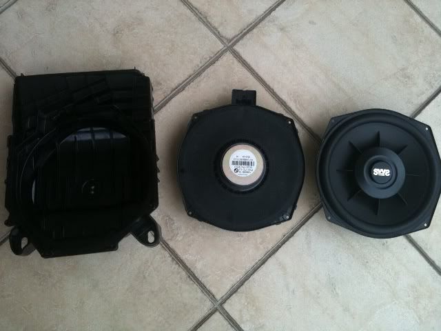

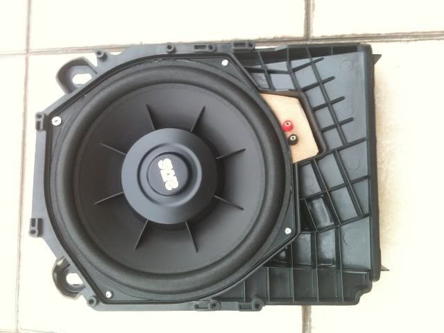

The stock underseat speakers are 6", you can replace them with a pair of Earthquake SWS-8X 8" speakers. The SWS-8X fits perfectly in the original enclosure but you will have to seal the void left behind by the connector of the stock speaker.
Some pictures below to show what i did for mine.

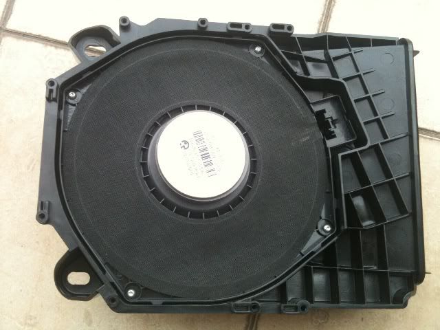

Stock 6" speaker and enclosure:

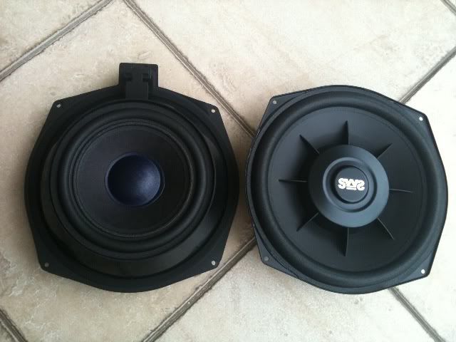

Stock 6" vs new SWS-8X:

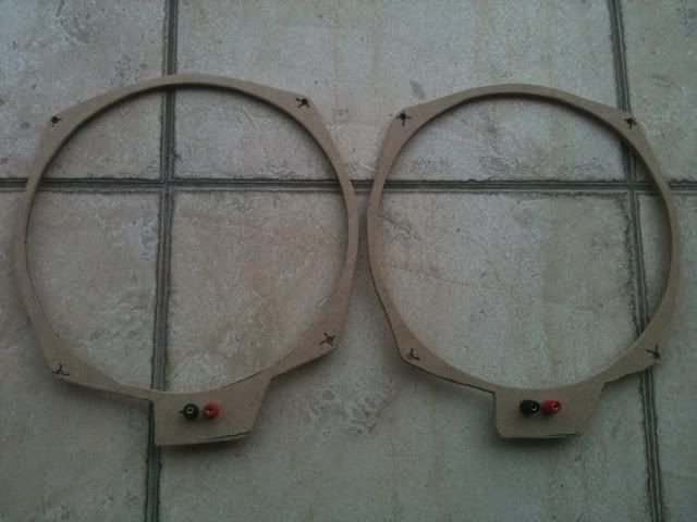

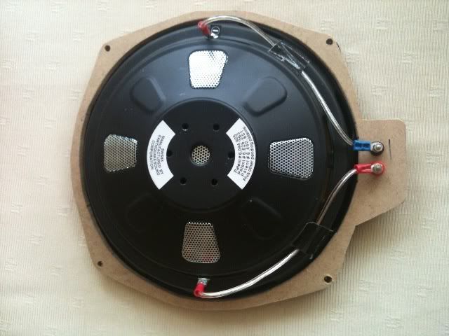

I fabricated a pair of MDF spacers to seal the void in the enclosure:

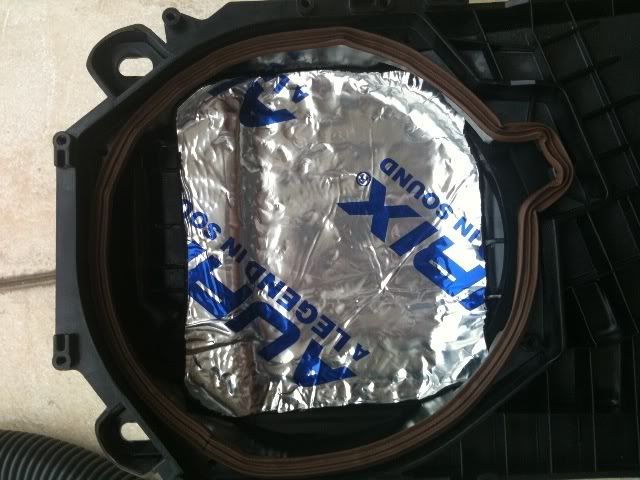

Sound deadening material applied to the base of the enclosure and weather strip around the perimeter to ensure air-tight fit:
New SWS-8X in enclosure:
Please note the HU will not be able to drive the SWS-8X speakers directly, you will definitely need a power amp to drive these.
Hope this helps. 8)

Skip, great job. Did you buy those SWS yourself? How much and how's the bass? I am using Hertz Space K8 component.
Re: Non-LCI E60 Speakers Upgrade
pengful;646993 said:
Skip, great job. Did you buy those SWS yourself? How much and how's the bass? I am using Hertz Space K8L component.
I was looking high and low for the SWS-8 and finally found them at a local installer but the price quoted was exorbitant so i ended up buying them online. I bought them from the following store:
Earthquake Sound SWS-8X (sws8x) Black, Shallow-Mount 8" Single 4
Free shipping within the U.S. and I used a forwarding service to have them shipped to Singapore.
Bass is pretty good. My friend's E60 is using the Hertz Space K8L too, but I somehow feel the SWS-8 sounds cleaner. Just a gut feel, didn't actually have the chance to do a side-by-side comparison and maybe because I am biased towards my own setup... 8)
