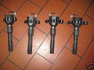

Me finally started my Coil On Plug (COP) project. The aim is to remove the need for spark plug cables and also save a bit of weight.
Me bought these set of coils over at ebay for USD40. They originate from a M52 motor. Below is another COP project on M42club.

just wondering for my own knowledge, what's the benefits of such a modification?
The main thing is dont have to wory about spark plug wires anymore. Me felt heart pain after spending $150 for a new set of plug wires. I have to change because my cylinder No.2 is having some mis-firing problems and rough idle. It turns out that the plug boot has worn out, thus it can't make good contact with the spark plug, causing lots of arcing.
