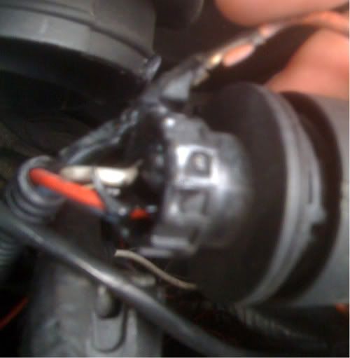

Like to find out is it normal and can be ignored, photos attached.
Right Side

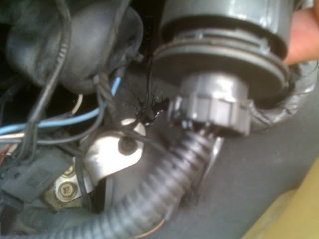

Left Side, Dripped to bottom

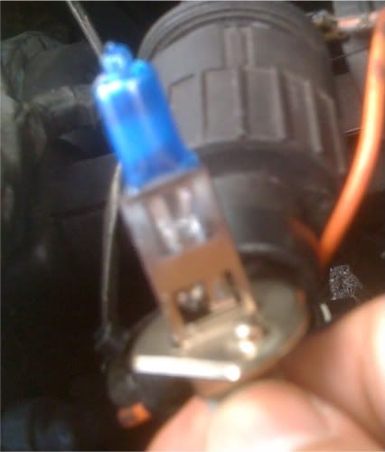

Yeah, whole sets of after market Headlights, something like this.
Read somewhere that if the Headlights are cheapo from unreliable source, they can fry my wirings, hope that is not happening to me now :thinking:

I had the same issue with some aftermarket brand. Change the bulbs.

A picture of the bulb. Anyway , do you mean I'm using a bulb with the wrong specs causing burn or due to quality of bulb?
One side of the bulb blew, or maybe the wires fried, so will be going to change bulbs for both sides, do you think I should do a rewiring?

Frankly, I had no clue what kind of heat it is emitting, but surely it is too hot for the connectors......

prob the bulb is drawing too much current. try a lower watt one?

Done some research and it seems like the bulb wattage is too high

Went to change bulb n according to workshop wires didnt melt, duct tape melted n black melted thingthat melted n dripped down is black gum from connector
