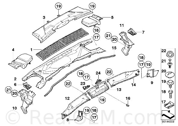

Re: Exhaust smell coming from air con
can try changing your aircon filter.
its located below item 19 in the diagram.
don't waste time with the advisor, just get a reliable workshop to do better.
Thanks, if I change the filter will it void the warranty?
How much will such a filter cost?
Will not void
Less than $30. This is a simple DIY. I change mine every year.
