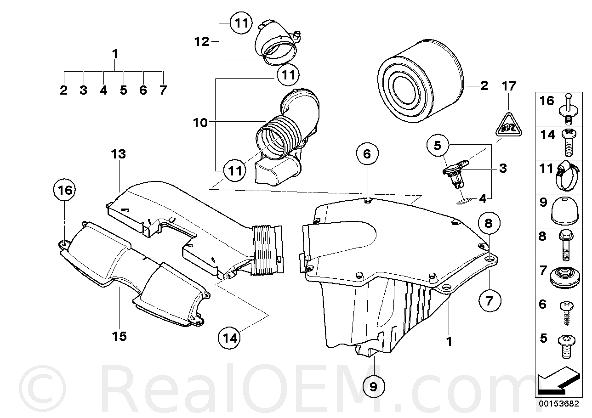

dig up this old post about opening the other air channel for 320
i'm wondering whether this is possible
1. replace 320 item 13 with 325
2. cutomise locally a 'simple joint' (rubber or plastic) that can connect to item 12 in 320 intake
325 intake
320 intake

DISA is simi? Here's a photo of the underside of the intake. You could use a dremel tool to open up the holes. Then use a perspex sheet to cover the grooves and channel the air back to the channel.
Enjoy!
Re: E90 320i. Any one tried opening another air channel?
i think the channel is already sealed at red mark and not blue
from red to blue not sure is opened or sealed
Enjoy!

Dual Resonance Intake System. W/o DISA, it is pointless to open up the other side as ur low end will suffer.
perhaps, that's why 318/320 (w/o DISA) suffers low end greatly with open pod setup - too much air
could be the same reason why bmw did not release performance intake for 318/320 in addition to performance exhaust
